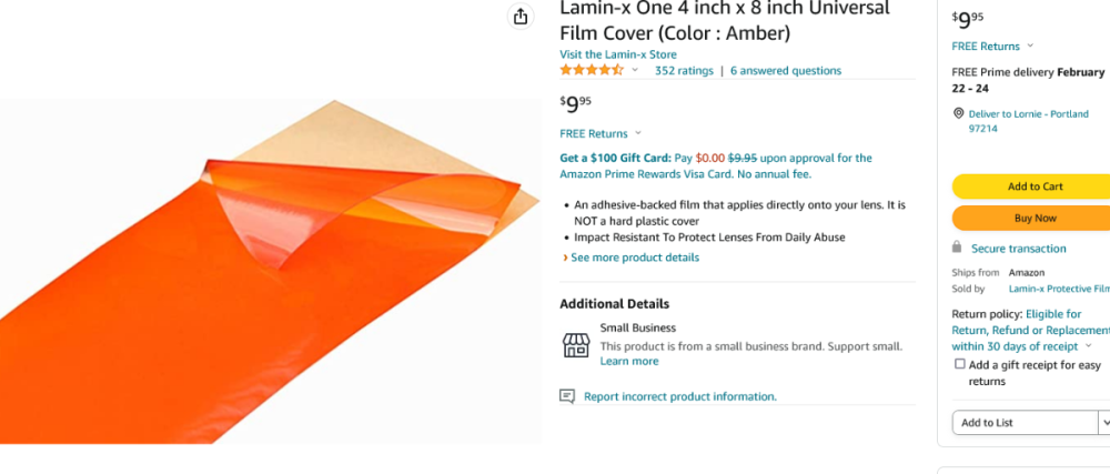

Similarly, I added a dark tinted film.  Subdues the patio lights, which really should be switchable by side.  https://www.amazon.com/gp/product/B017MWRQY6/ref=ppx_yo_dt_b_search_asin_title?ie=UTF8&psc=1

Like other Oliver owners have, we ended up adding amber film over all the patio lights and the light is now warm and subdued.

So far I've only tried the dark film in the driveway, but it seems there is plenty of functional light.  From a distance, the "bright-in-your-face" light from a distance (i.e., neighboring campsite) is substantially diminished.  The awning light on more recent trailers is available for more street-side light if needed.  Finally, the film can be removed if you feel it's too dark.
I did try film on only half of the light next to the door (see photo), thinking this would leave more light around the door but diminish the distance brightness.  However, the light still seemed to bright at a distance, so I removed the film and replaced it with a full-coverage piece.
I found the best way to apply the film was to place a piece of masking tape over the light, carefully trim  with a precision hobby knife the portion of the masking tape covering the chrome housing.  The remaining portion of masking tape covering the lens can then be removed and used as a template for cutting the film.

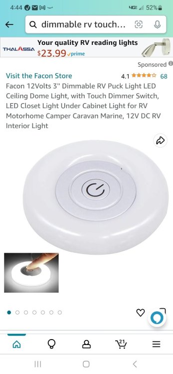

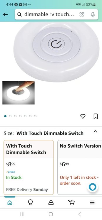

Maybe do a search for dimmable touch lights puck. I came up with this. I'm sure there are more.
We have certain essential lights on our boat, both dimmable and color changing (red doesn't interfere as much with night vision when sailing).  Replace a few, turn the rest off, is what I'd do.

3 hours ago, topgun2 said:
The good news and the bad news - When I dim the lights, ALL lights (interior and exterior) dim.  There are times when I would prefer to only dim either the interior or the exterior.  However, this has never bothered me enough to rewire it.
No - I do not know the answer to this.  If I had to guess, I'd think that the touch lights are the "problem", but, the guys that would probably know are located in Oliver Service.
Hannah in Oliver service says the touch lights are not dimmable.
Amazon has some similar lights that appear to be dimmable (https://www.amazon.com/Interior-Surface-Ceiling-Overhead-Lighting/dp/B09W2DMQSS/ref=sr_1_1_sspa?crid=2JZT85UWBYI75&keywords=12v%2Btouch%2Blight&qid=1685739764&sprefix=12v%2Btouch%2Blight%2Caps%2C193&sr=8-1-spons&spLa=ZW5jcnlwdGVkUXVhbGlmaWVyPUEyRkdSRklLUFZON1A4JmVuY3J5cHRlZElkPUExMDQ2NTI1MVpQQlkxOUhJR1JTSiZlbmNyeXB0ZWRBZElkPUEwNTc1MzQ2WDFKWkY1MkVYS0g1JndpZGdldE5hbWU9c3BfYXRmJmFjdGlvbj1jbGlja1JlZGlyZWN0JmRvTm90TG9nQ2xpY2s9dHJ1ZQ&th=1).  However, one review mentions a buzzing noise when dimmed.
