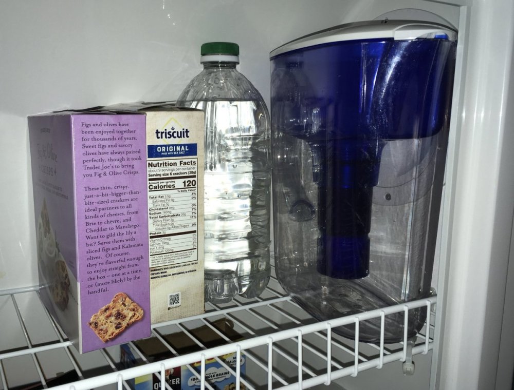

Geronimo John Posted March 28, 2023 Posted March 28, 2023 We're the HOT weather campers so.... Will the 7 cup fit in the door of the Dometic OEM frig? GJ TV: 2019 F-150 SuperCrew Lariat, 3.5L EcoBoost, 10 Speed Trans, Max Tow, FX-4, Rear Locker OLLIE: 2018 OE2 Hull 342, Twin Bed. OLLIE DIY’s: Timken Bearings, BB LiFePO4's, Victron 712 Smart, 350 Amp Master Switch, Houghton 3400, Victron Orion DC - DC, 3000-Watt Renogy Inverter, P.D. 60-amp Converter, Frig Dual Exhaust Fans, Kitchen Drawer Straps. Front Wardrobe Shelves, Snuggle Shelf. TV DIY’s: 2 5/16" Anderson System, Nitto recon’s, Firestone Rear Air Bags, Bilstein 5100’s, Mud Flaps & Weather Tech all, installed Ham Radio (WH6JPR).
John E Davies Posted March 28, 2023 Posted March 28, 2023 11 hours ago, Geronimo John said: We're the HOT weather campers so.... Will the 7 cup fit in the door of the Dometic OEM frig? GJ You can’t travel with the filter pitcher full of water, it will leak like crazy, but you could store it anywhere empty….just keep a small full juice bottle in the fridge for chilling and refill it as needed. Or a gallon milk jug. When you stop for the day, fill the pitcher and it is ready to drink in five minutes. John Davies Spokane WA 1 SOLD 07/23 "Mouse": 2017 Legacy Elite II Two Beds, Hull Number 218, See my HOW TO threads: Tow Vehicle: 2013 Land Cruiser 200, 32” LT tires, airbags, Safari snorkel, Maggiolina Grand Tour 360 Carbon RTT.

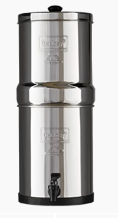

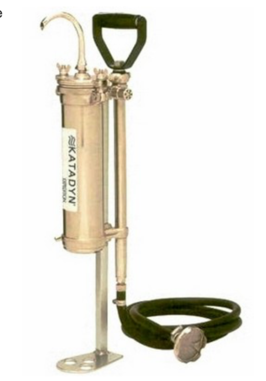

MAX Burner Posted March 28, 2023 Posted March 28, 2023 On 3/27/2023 at 2:34 PM, Frank C said: We have chlorinated city water at our house so when we get home after camping trips I drain the fresh water tank to empty out any water left from our last campground hookup, then I run our house water through the trailer city water connection to flush all the faucets and toilet, then I fill the fresh tank, drain it, then fill it again and run all the faucets again using the trailer onboard pump. This gets our chlorinated house water into all the trailer lines (and I leave the fresh tank full with our house water). I repeat this process once a week or so, including draining and refilling the fresh water tank if the trailer is sitting at home for any length of time between trips to keep the water fairly fresh. I also plug into shore power about once a week at home to keep the trailer batteries charged, and I get the propane tanks refilled. It’s easy to do (I have quick connect hose couplings on all of the trailer water connections) and this way I have a 30 gallon emergency fresh water supply at the ready if anything happens at the house with city water being turned off due to borough water line maintenance, etc. Plus the trailer is ready to go on short notice if needed (think of the situation of the folks in East Palestine Ohio that had to evacuate after the train derailment). I like being prepared for emergencies as much as possible, and a stocked & ready Ollie provides a good backup for a lot of situations. We do drink and cook with the water from our fresh water tank while camping, but we always use a multistage filter system. I do winterize as recommended during winter months, and I do the bleach sanitizing process in the spring after de-winterizing. Awesome write-up, Frank! We've been using Berkey Water Filters in our campers for years. Our house water is supplied by an artesian well and tastes great without any weird smell to it - so that's what we start of with on our camping trips. For the Ollie, we like the Travel Berkey - smallest one they make (19"H x 7.5"W), and easy for carrying in the Oliver, we move it around but it usually lives on the night stand. We typically don't drink from the fresh water system but I'm sure we've cooked with it. The Berkey system is simple - no moving parts, gravity drains. Here's a pic off their website: So it holds 1.5gal and can filter up to 2.75g/hr depending on how frequently it's filled. This feature makes the it a great solution for emergencies when your water source is questionable. Like you, we keep our rig watered, fueled, and loaded with dedicated kit just in case something "HTF". We like to keep the fresh water tank as sanitized as possible - so it gets treated 2-3x annually. We also carry a Katadyn KFT Expedition pump filter - works great when the situation presents itself. Water is the next "gold", IMHO. 3 Art, Diane, Magnus & Oscar (double-Aaarrf!) (SOLD) 2022 TUNDRA (SOLD) 2017 LE II; Hull #226 "Casablanca" HAM call-sign: W0ABX
Hokieman Posted March 28, 2023 Posted March 28, 2023 41 minutes ago, MAX Burner said: We've been using Berkey Water Filters in our campers for years. We’ve been using a Travel Berkey for several years also. When we are getting ready to leave our campsite, we drain all the water into a jug and put in the fridge, fill our travel water bottles, etc. Then we remove the upper half of the Berkey, invert it and nest it in the lower half. Set it in the sink and pad it with some towels. It travels nicely that way. We haven’t figured out a convenient place to put it inside the cabin while camping, so it’s usually outside on a portable table, unless it’s freezing. 2 “Ramble” - 2021 Legacy Elite II #797; 2020 Ford F-250. Former owner of 2019 Oliver Legacy Elite #431. Blairsville, GA
MAX Burner Posted March 28, 2023 Posted March 28, 2023 24 minutes ago, Hokieman said: We’ve been using a Travel Berkey for several years also. When we are getting ready to leave our campsite, we drain all the water into a jug and put in the fridge, fill our travel water bottles, etc. Then we remove the upper half of the Berkey, invert it and nest it in the lower half. Set it in the sink and pad it with some towels. It travels nicely that way. We haven’t figured out a convenient place to put it inside the cabin while camping, so it’s usually outside on a portable table, unless it’s freezing. HA! That’s exactly how we do it! Great minds…, rights?👍🏼😎 1 Art, Diane, Magnus & Oscar (double-Aaarrf!) (SOLD) 2022 TUNDRA (SOLD) 2017 LE II; Hull #226 "Casablanca" HAM call-sign: W0ABX
Geronimo John Posted March 28, 2023 Posted March 28, 2023 6 hours ago, MAX Burner said: KFT Expedition pump filter Those are great filter units. Which one do you carry in your Ollie? GJ TV: 2019 F-150 SuperCrew Lariat, 3.5L EcoBoost, 10 Speed Trans, Max Tow, FX-4, Rear Locker OLLIE: 2018 OE2 Hull 342, Twin Bed. OLLIE DIY’s: Timken Bearings, BB LiFePO4's, Victron 712 Smart, 350 Amp Master Switch, Houghton 3400, Victron Orion DC - DC, 3000-Watt Renogy Inverter, P.D. 60-amp Converter, Frig Dual Exhaust Fans, Kitchen Drawer Straps. Front Wardrobe Shelves, Snuggle Shelf. TV DIY’s: 2 5/16" Anderson System, Nitto recon’s, Firestone Rear Air Bags, Bilstein 5100’s, Mud Flaps & Weather Tech all, installed Ham Radio (WH6JPR).
MAX Burner Posted March 28, 2023 Posted March 28, 2023 2 hours ago, Geronimo John said: Those are great filter units. Which one do you carry in your Ollie? GJ We've got the Katadyn Expedition base camp filter. Super heavy duty and not light weight (about 12lbs); fairly compact. 1 Art, Diane, Magnus & Oscar (double-Aaarrf!) (SOLD) 2022 TUNDRA (SOLD) 2017 LE II; Hull #226 "Casablanca" HAM call-sign: W0ABX
