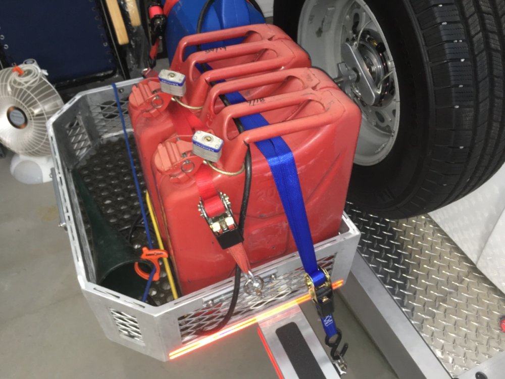

People do this all the time, but please do not join them, it really is a bad idea. Not only is it a violent location, it is filthy and super wet . Not a good location for any kind of powered equipment. I carry a 50 pound ebike (battery removed) on a tray close to the bumper. It’s OK, and when I had my cargo basket there, with two full jerry cans of fuel, it was just OK, but far from ideal.
https://olivertraveltrailers.com/forums/topic/3263-how-to-move-the-factory-cargo-tray-to-a-rear-rack/

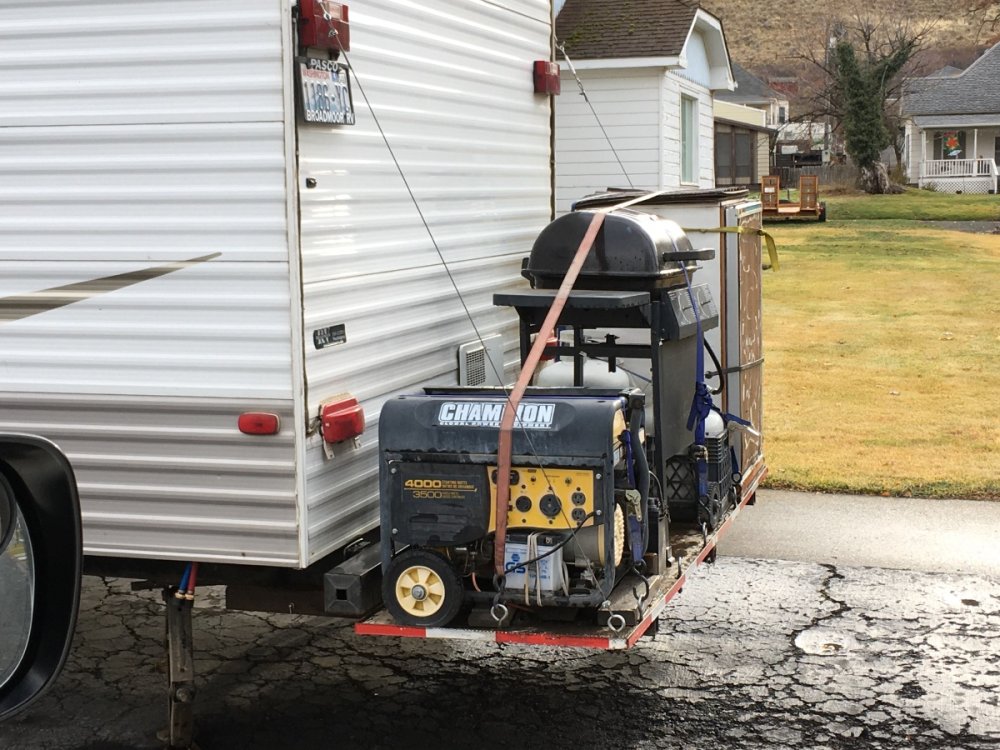

TOP PHOTO:  Not only is all that heavy kit hanging off the bumper of the dude's single axle SOB a bit unnerving, but what's especially intriguing is the interesting wiring harness from the battery (also heavy) forward into the side of the TT.
