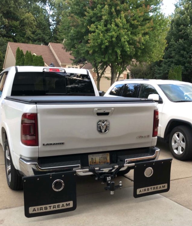

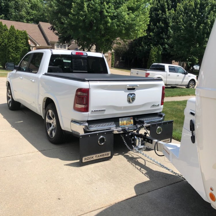

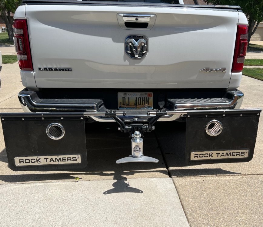

IMG_1856.thumb.jpeg.561afe8f9b8eb1ced086a179fe31f8f4.jpegIMG_6481.thumb.jpeg.324c530d20700f04a1a5217f9150fc76.jpeg
2021 Dodge Ram 1500
2021 Oliver Elite ll
Hull #732
Michigan

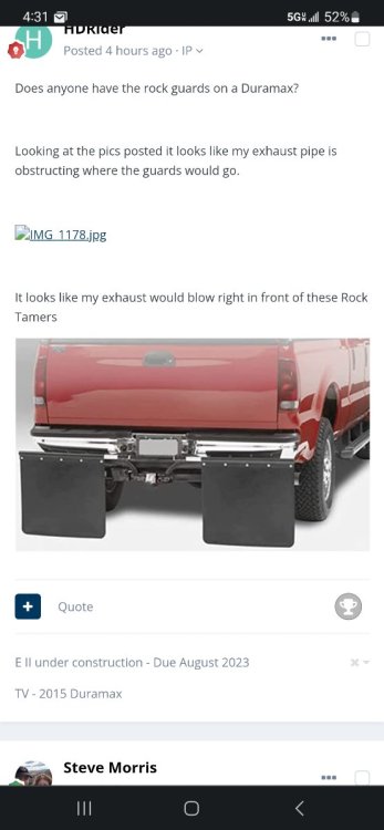

FYI your picture didn’t work, please try again, and tell us your trailer model, hull number and tow vehicle, your location is optional but helpful.
I see the picture fine.

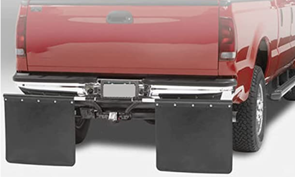

Does anyone have the rock guards on a Duramax?
Looking at the pics posted it looks like my exhaust pipe is obstructing where the guards would go.
It looks like my exhaust would blow right in front of these Rock Tamers
We don't see anything

Weird - I see the pic.
Re the exhaust and Rock Tamers - that company produces various models of the product that work with specific brands and exhaust systems such that the rubber flaps are not affected by the heat of the exhaust.  From the picture posted I assume that either these are the wrong Rock Tamers for the application or the exhaust is far enough away from the tamers that they are not affected.

The photo shows on my PC but not on my iPad.
You have to get the right ones for your truck. You need the ones with the opening for the exhaust.
I'm guessing that the problem is the old Apple versus Android/Windows thing.
I'll see if I can fix it but do not have a minute at the moment.
We can see the pic of the Red Truck - the one above it is blank...???

Android samsung phone. Ditto.
I'm viewing on an Apple iMac using Safari, all the current updates. I can't see img_1178.jpg Same on an old iPhone XS. So I'm thinking you're right.

21 hours ago, HDRider said:
OK started to work on the picture viewing problem.
Is the quoted picture above the one that is not viewable on Apple products?  Or, is the problem picture the view of the red truck with the rock tamers.  Or both?

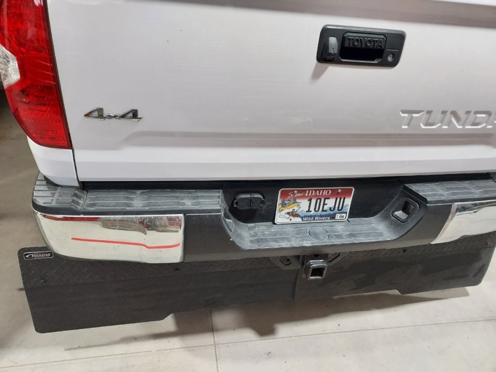

We also chose Rockstar mudflaps for our 2019 Tundra.  We like that the assembly covers the full width of the truck.
On our Tundra, the Rockstar is mounted inboard of the bumper, placing it closer to the rear wheels.  See attached photo.  No visible chips yet on Hull #1291.
Correct. All I see is "IMG_1178.jpg"

Thanks - Steve,
I think that we may have a failure to communicate.
I'm going to assume that everyone can see the picture of the red truck but cannot see the
"IMG_1178.jpg"
Using Windows and Android I cannot see the 1178 either but I can see the red truck.
I now believe that the 1178 was meant to be the red truck but there was a
problem with that when it got into the original post.
Thanks - Steve,
"IMG_1178.jpg"
Is my truck.  I am posting a picture I took with my iPhone.
Same here - using a MacBook Pro, FYI.
  • (SOLD) 2022 TUNDRA
THAT clears up the mystery - thanks
