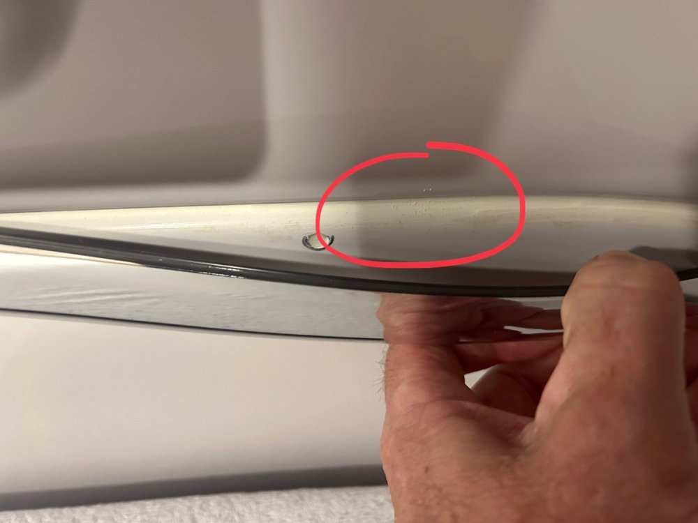

Here is a pic of an area under the belly band. If this area has a lot of old tape residue or powdery residue naturally it will need to be completely removed. If not fresh double sided tape may not work for the long haul. My SWAG is that at the plant when all the interior gelcoat is polished some powdery polish residue is not removed along this seam when the BB is installed the BB adhesive just does not adhere well long term. (Look closely at the pic you will see a powdery residue) I used rubbing alcohol to prep the area removing any polishing residue from the hull seam before adding gorilla tape and it has held up great. As @SeaDawg and others mentioned it’s all about the prep.
Note - The back side of the BB chrome strip has two fairly narrow strips of what appears to be a thin and not very robust VBH tape. I don’t know of any other solution to replace factory BB. As long as mine stays put and it has so far, I plan to just leave it in place.

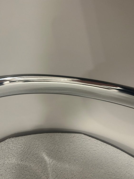

In addition to Patriot's photos above.
Here's the adhesive side of the of the 2" belly band. With Gorilla double sided tape still installed, one piece of tape slipped and some of my grey hairs.  🙂 The hull gap depth to the sealant between hulls varies around 1/8" to 1/4". The hull gap width is about 5/8" wide. The original adhesive strips on the belly band are about 1/2".
