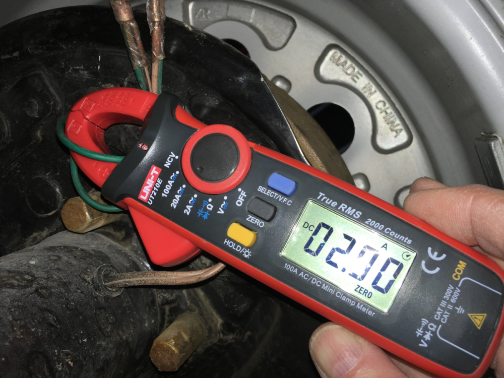

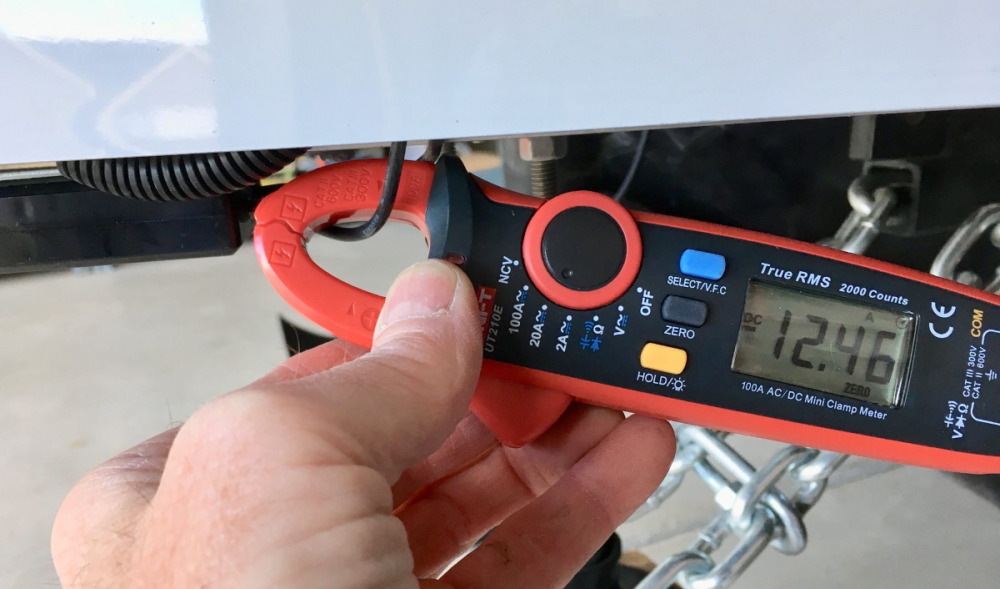

2.  If you don't have solar, than I would connect Ollie to your TV and having a partner to activate the brakes:
  • Measure the total amperage going to the brakes.  Requires a clamp on amp meter.  Should read between 11 and 12 amps.  This will tell you if one or more of your brakes are not getting the power it needs to fully activate.  If low:
  • Test the power going to each side.  Should be half of the above (around 6 amps) and equal side to side.  If not:
  • Test each of the four lines going into the brake assembly to figure out which one is the problem.
  • If found, determine if it is:  Broken/corroded connection, bad ground to that magnet, or a bad magnet.
As above, knowing the amp draw at various places allow you to figure out where the problem is.  If none of the above works.... get professional help before replacing your controller.  Ask prospective shops if they have a plug in testers that connects up to your 7-pin at the TV bumper to diagnose TV brake controller and wiring.

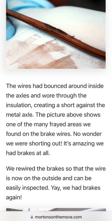

On 12/5/2023 at 3:55 PM, Geronimo John said:
is the wear point of the brake electrical wires at the axle entry shown below?
They flop around inside the unpainted inner diameter of the axle tube and eventually wear through the insulation. It isn’t anything that you can see without pulling them out completely. If the wires were protected by split loom in there, it would most likely be an OK practice. But not for loose wires… those axles hop around constantly and chafing is the result. Here is one reference.
https://www.mortonsonthemove.com/fixing-the-rv-brakes/
This is exactly what happened to me.  Insulation worn, wires shorting, no brakes.  New wires routed on the outside of the axle solved the issue.  Mike
