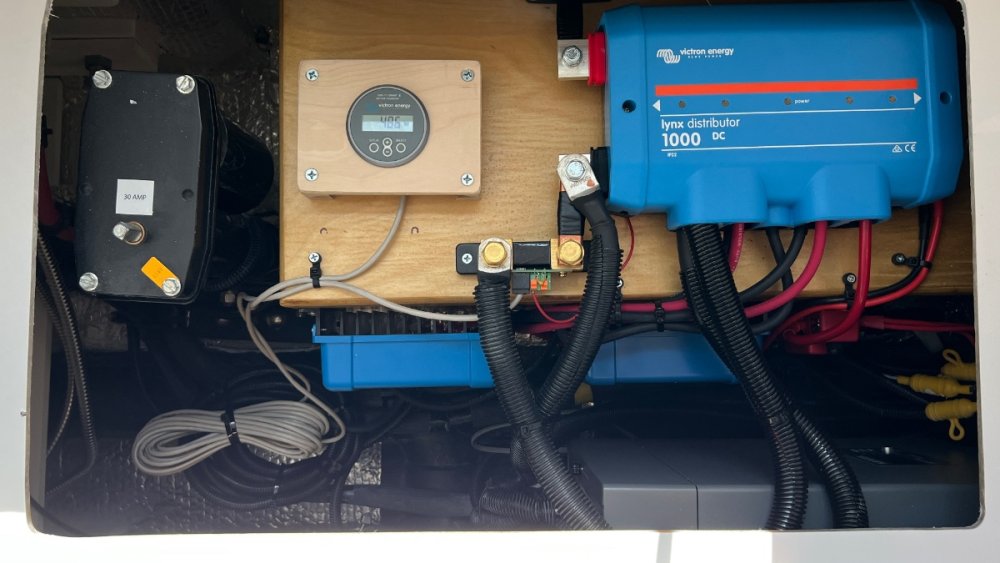

     As many have said the real cost is going to be the labor from Oliver to do the different changes.  I have the 390 AH lithium package simply because they were switching from the lifeblue to lithionics and I got the Lithionics at the old price. ($500 cheaper).  The Lithionics are excellent batteries but there are many cheaper options that would work just as well.  If considering changing the batteries I would also look at updating the wiring and adding a solar controller or sizing a new one one large enough for an external panel setup.  Olivers factory wiring job under the streetside bed leaves much to be desired.  Regarding the Truma upgrade I would consider looking at the Houghton that many of us have installed.  It is just as quiet as the Truma but also includes a heat pump function (saves propane) that will keep you warm down to about 30 degrees.  I was the one that got the quote for $5200 to change out the refrigerator.  Way to expensive for me to consider so I will do it myself when the time comes.  As always, upgrades depend on your ability, your checkbook or both!! 😂
John
John
John,
Excellent clean work! Super Sano!!
Patriot🇺🇸

I agree.  How about  three 100 amp hour Battleborns, 3000 w inverter, 200 watt solar suit case (I wish I had gotten two each 100 watt ones though), Victron DC to DC charging and 712 Smart all for under $4,600 in 2021/22?  Plus of course about 5 days labor by my self.
2021 SOLAR INSTALLATION INVOICE SUMMARY.xlsx
The only really hard parts were the below and cutting a hole in the dog house for the #4 charging cables to the TV battery.
If I were doing it again, I would have made the cutting board "pan handle" just a bit wider.  The switch mounting bolt could have used another 1/4" of meat.
Hat's off to you. Pretty sure that would have taken the two of us longer.
