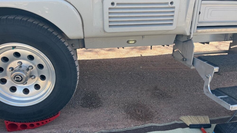

Moderator+ ScubaRx Posted August 6, 2023 Moderator+ Share Posted August 6, 2023 On 6/25/2023 at 6:30 PM, Steph and Dud B said: Yep. Tightened all the fittings and screwed down the hold-down straps. Very strange symptoms. When the pump is sucking air, you can barely hear it. If anyone keeps getting air in the lines the first time you use your pump on a trip, check those connections. I'm glad it was a simple fix. On the second day of our Quartzsite trip this past January, I found that our water heater tank had a hairline crack on the very bottom and leaked whenever the pump came on and pressurized the system. Forty days without hot water. Ahhh, the joys of camping. I love the challenges. 1 Steve, Tali and our dog Rocky plus our beloved dogs Storm, Lucy, Maggie and Reacher (all waiting at the Rainbow Bridge) 2008 Legacy Elite I - Outlaw Oliver, Hull #026 | 2014 Legacy Elite II - Outlaw Oliver, Hull #050 | 2022 Silverado High Country 3500HD SRW Diesel 4x4 Link to comment Share on other sites More sharing options...
