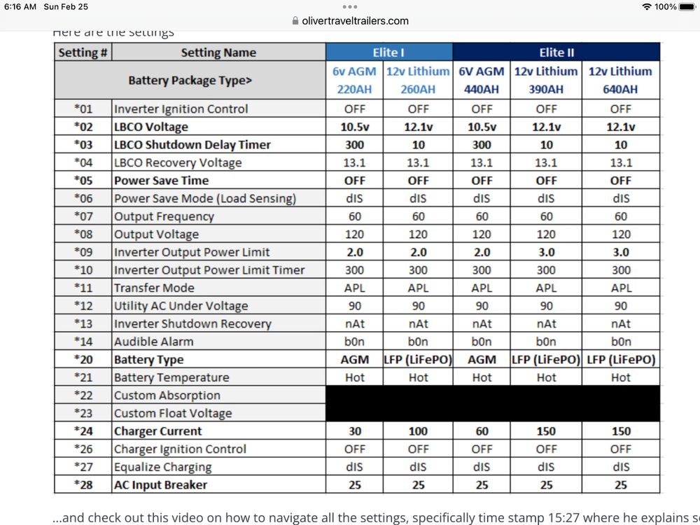

On 5/28/2024 at 12:45 PM, Boudicca908 said:
I was expecting to find mention in an OTT video or OTT knowledge base article, but so far I’ve failed to find it or specific information on changes (if necessary) to my Xantrex settings, so I can recharge my lithium batteries with a Pulsar Inverter Generator 2000i
This was sent me by Oliver upon request when I converted to LFPs last summer. In particular, Setting 20 (Battery Type) was switched to LFP and Setting 24 (Charger Current) on my Xantrex was checked and left at the factory 90 value for my older Freedom 2000 unit.

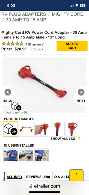

On 5/28/2024 at 1:38 PM, Boudicca908 said:
I thought it would be a plug that would accept my Oliver’s 30amp plug.
Most small generators only have a single duplex receptacle with two outlets. One outlet will be used for the neutral grounding plug, the other will require a 30 Amp to 15 Amp 110 Volt RV adapter. This is the one I bought from etrailer.com, but many similar are available on Amazon. I also make use of this plug at my storage facility for shore power.
2020 OLEll, Twin, 579:

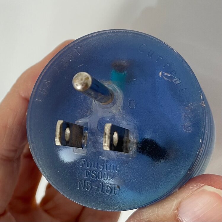

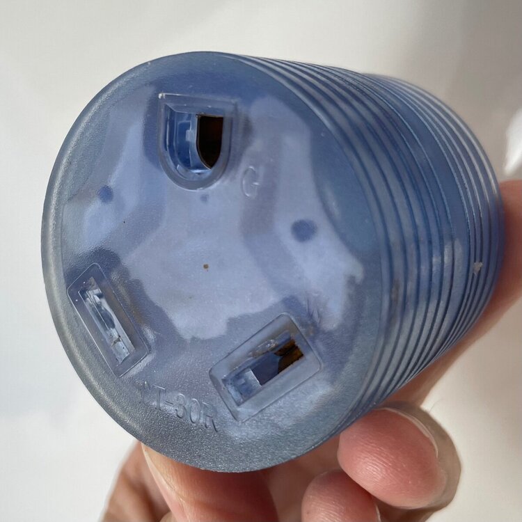

Thanks for this — I have a similar adapter, bought before I picked up my Oliver.
As I look, this (new to me) generator is similar to your description. The friend who gave it to me also gave me a small adapter (I will attach photos if possible). That friend had to depart, sadly, for medical care.
So far, I haven’t run down my lithium batteries to the point where I need to use the generator (after doing so once, and then waiting a couple of days for them to rejuice with the sun). But I am not using much, hardly using the microwave and never using the AC… as it gets hotter, my frugality might be confronted by my desire for some comfort.
