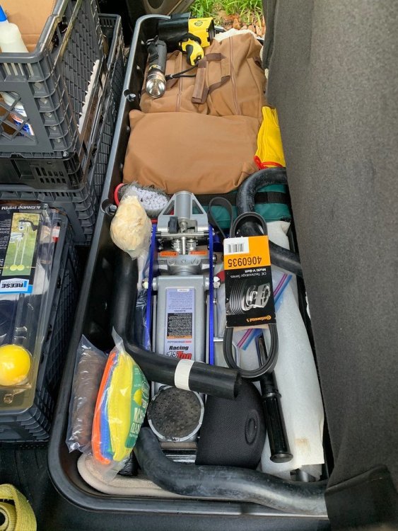

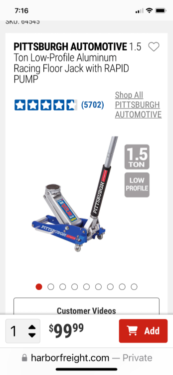

23 hours ago, Dennis and Melissa said:
1) I was surprised to learn the stabilizing jacks aren't recommended for changing a flat, yet no jack is provided.  Anyone have jack advice?
I carry a light weight 1.5T aluminum floor jack for use with both my TV and OTT; trim design, and easily stowed under the rear seat with other tools, spare parts and supplies. When lifting the Oliver at the designated jack points, this low profile floor jack is placed on top of an Anderson Rapid Jack to enable adequate reach; however not necessary for axle lifts. These style jacks have a long reaching, two-piece handle; useful for positioning, as well as leveraging. Although a Harbor Freight brand, it has served me well on many occasions; goes on sale often.
