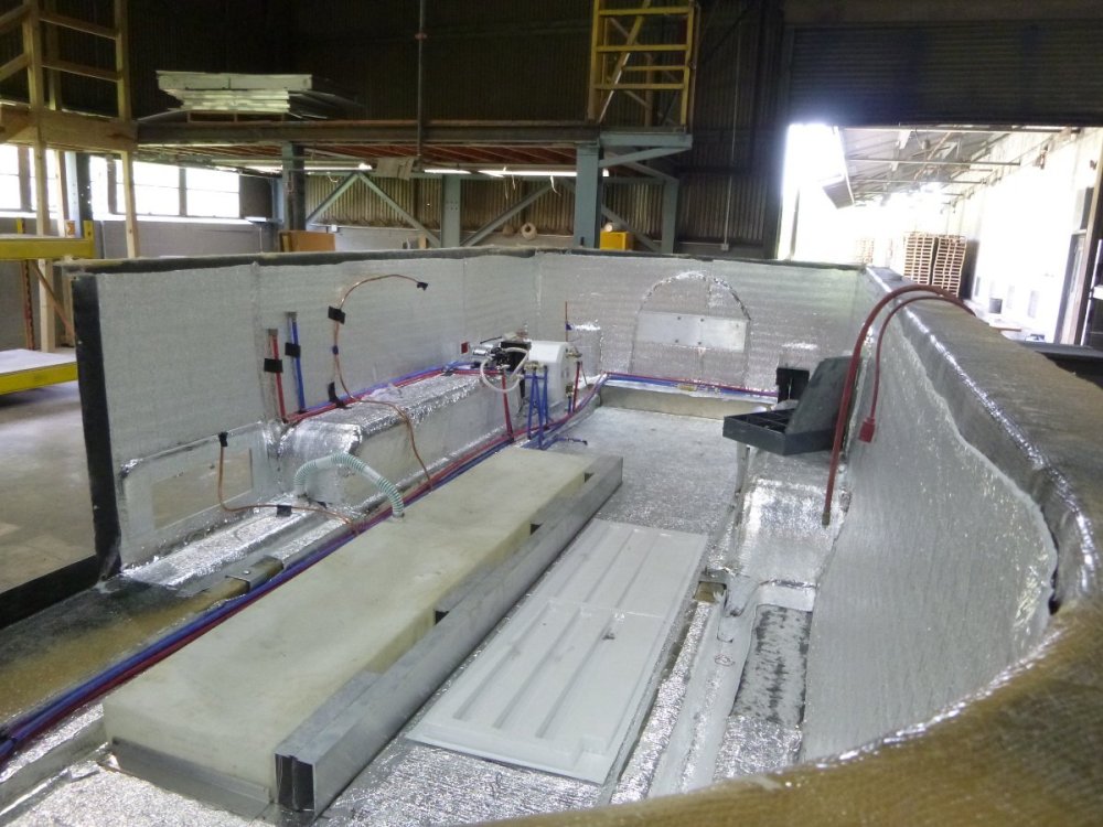

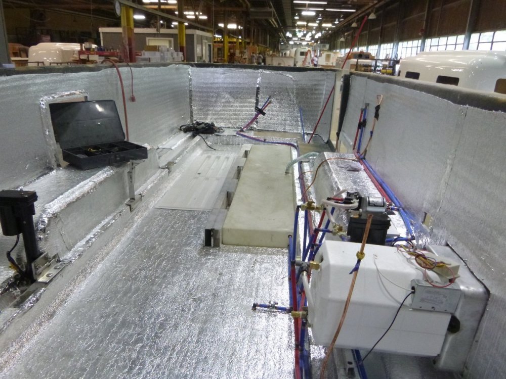

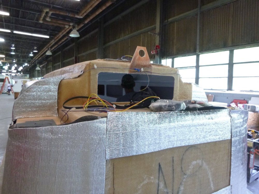

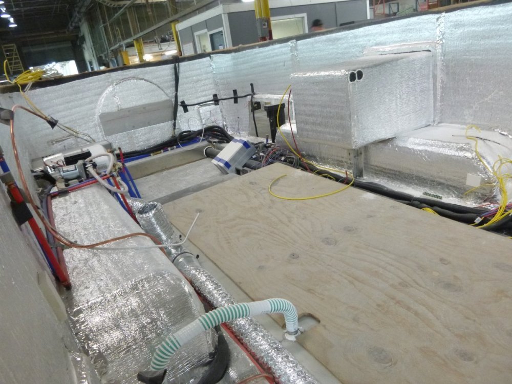

Actually the stuff that Oliver has used for insulation has been similar to Reflectix but instead of being basically "bubble wrap" in between the foil it is a foam composite of some sort.
Here are a few pictures which show how and where this is applied to the shells prior to them being joined together.
