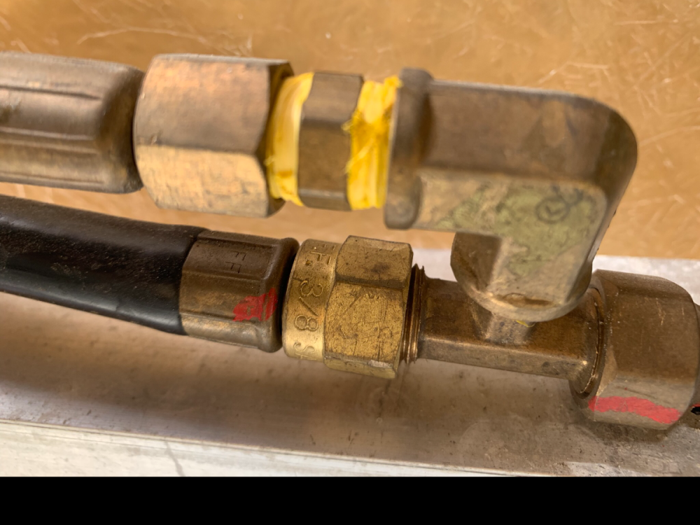

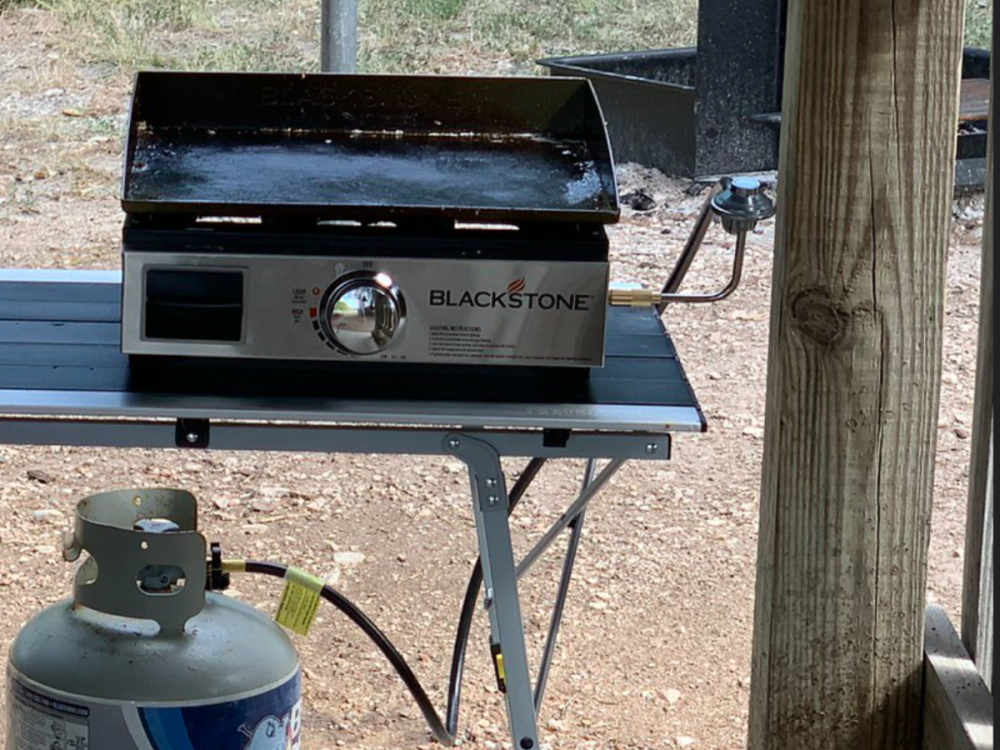

In a pinch, I would have done the same! I didn’t opt for the QC ports, as a cost savings measure at purchase, but was aware that copper gas lines were installed ‘fore’ and ‘aft’ with Oliver builds. Early in ownership, I tapped into the ‘fore’ with a ‘T’ fitting for a regulated extension hose accessible via the screw port, and simply removed a fitted plug on the ‘aft’ line to add a QC valve. However, prior to converting to these convenience gas ports I camped a few times either using the 1# or 20# propane tank.
BS supplied regulator in use with 20# tank.
Tap into existing regulated line for ‘fore’ QC port. I didn’t want the QC port to exit underneath, as Oliver installs, but rather higher to save my back and other intended use.

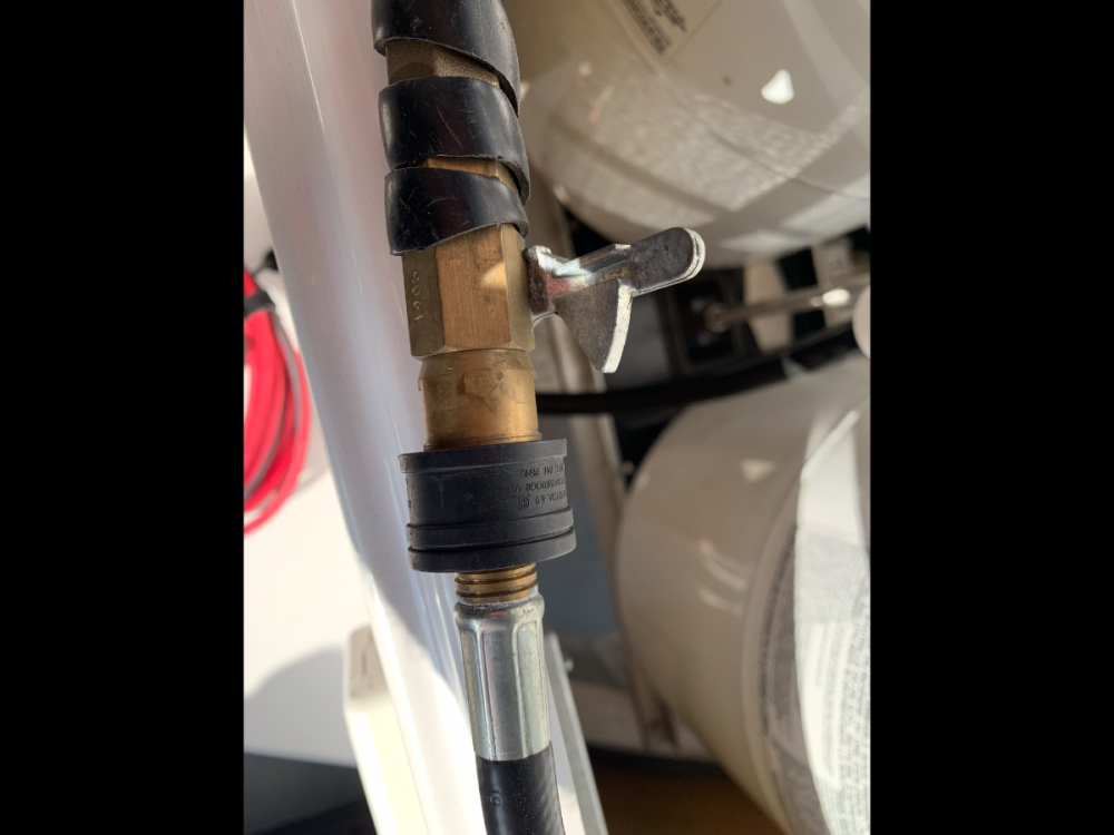

Short hose extension and QC valve connected to a 10’ extension hose for the ‘fore’ QC port. An elbow’s reach into the port to operate the valve.
10’ extension hose staged atop the tank of proximity to the screw port. The hose is simply routed out of the screw port and attached the another hose extension(s) for use with the BS or fire pit, as well as intended use with a small generator, as needed, positioned either on the trailer tongue or TV tailgate.
‘Aft’ installed QC valve once fitted plug was removed.

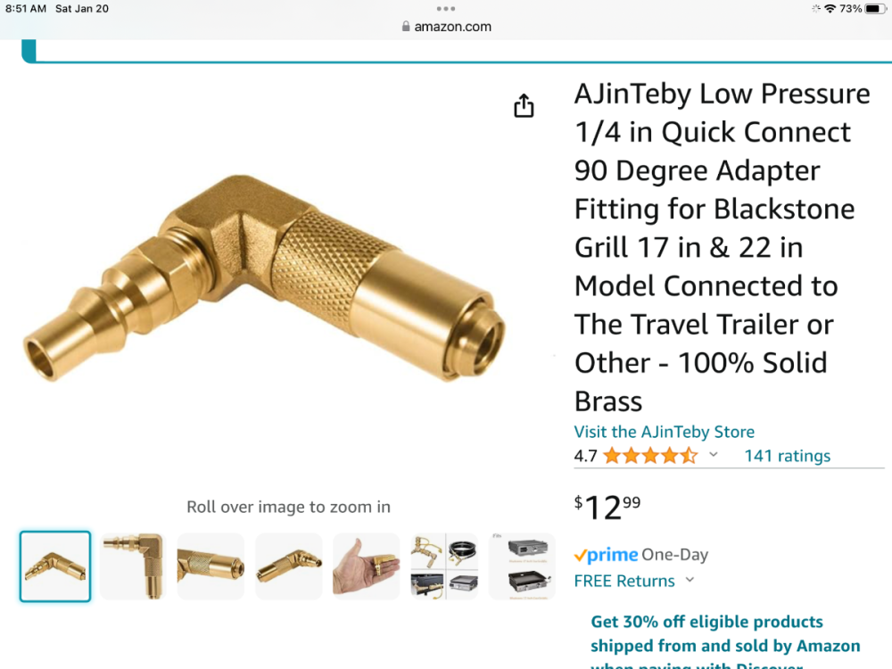

Adapter for BS QC attachment.

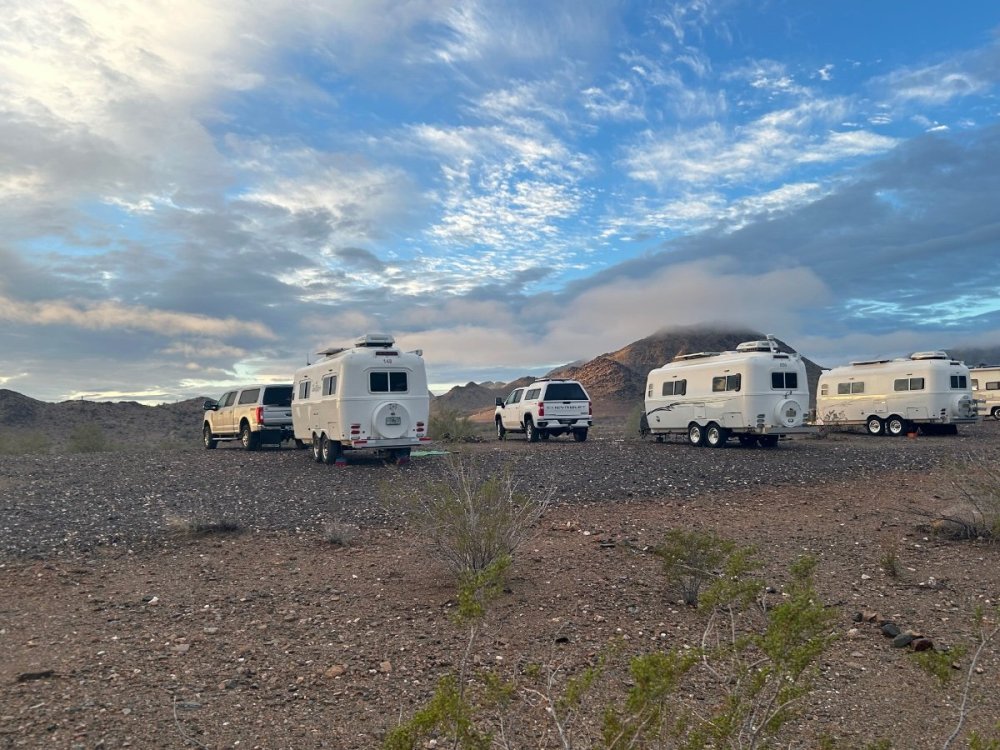

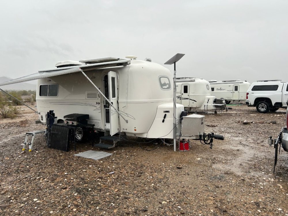

…and then there were three at The Q:
