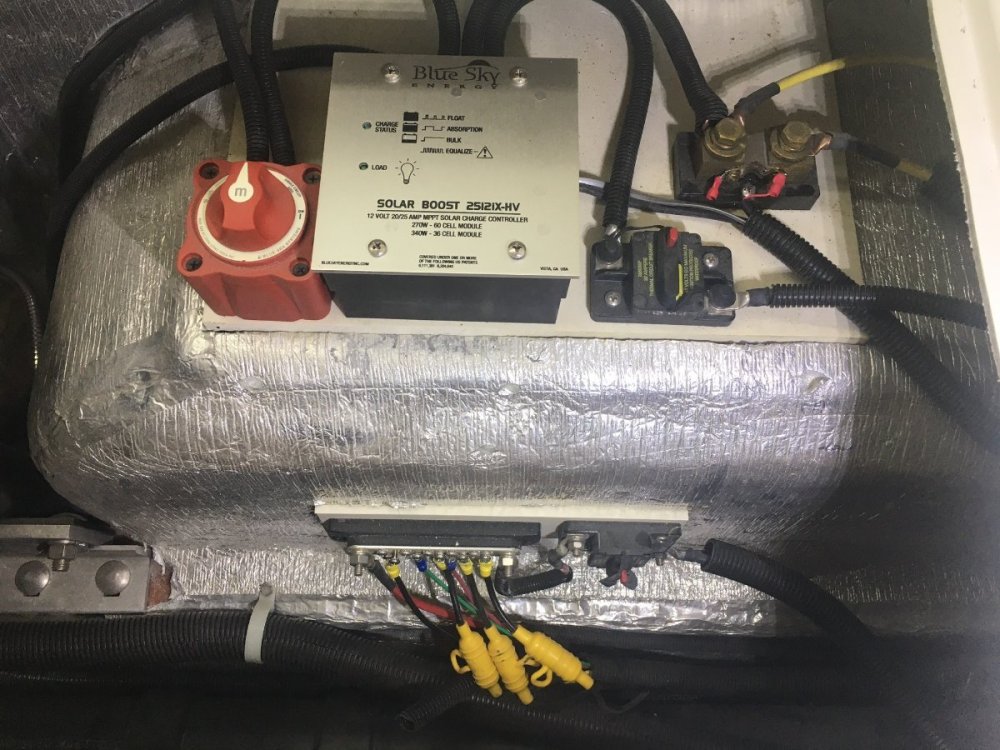

1 hour ago, drfaux said:
... still need to determine the best way to disable the Tow Vehicle charging - hoping there's a fuse somewhere that'll take care of it...

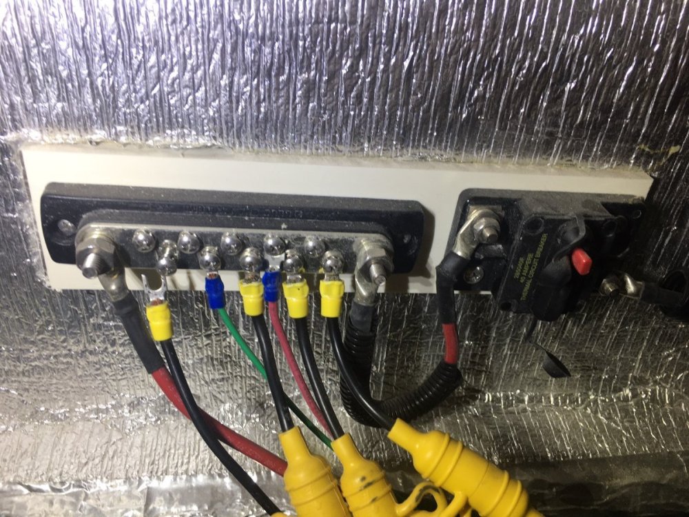

Our Oliver is older, and I believe yours might be too, since you mentioned  Blue Sky equipment. I do not recognize the picture @mountainoliver showed, meaning hull 113 does not have such wiring. Hard to say since neither of you have a signature line with hull numbers. I added two pics, the first to see overall location under the streetside bed, and then look at the close-up and you will see the black wire I disconnected hanging loose. Afterwards I just taped it and laid it down below.
it's the only black wire without the big yellow fuses (for the stabilizer jacks). First check to read 12VDC on the black at the trailer plug. Then disconnect this wire, test voltage again. You should read an open circuit, meaning zero volts. This will ensure you pulled the right wire.
If you checked continuity at the plug and that changed after you removed the wire shown in your picture, then you must have removed the correct wire. I believe that the automatic circuit breaker is shown on my Oliver supplied wiring diagram for 2017. My trailer is a 2017 model, hull 208.

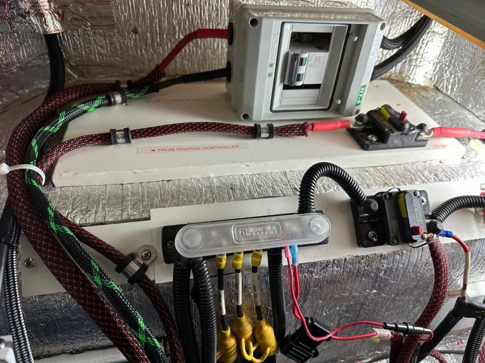

Your pic shows a  ‘white’ mounting plate under the components, was it glued or screwed down? I was wondering what material occurs immediately under the insulation layer on top of the wheel well, specifically the ‘raised’ platform under the ‘white’ plate.

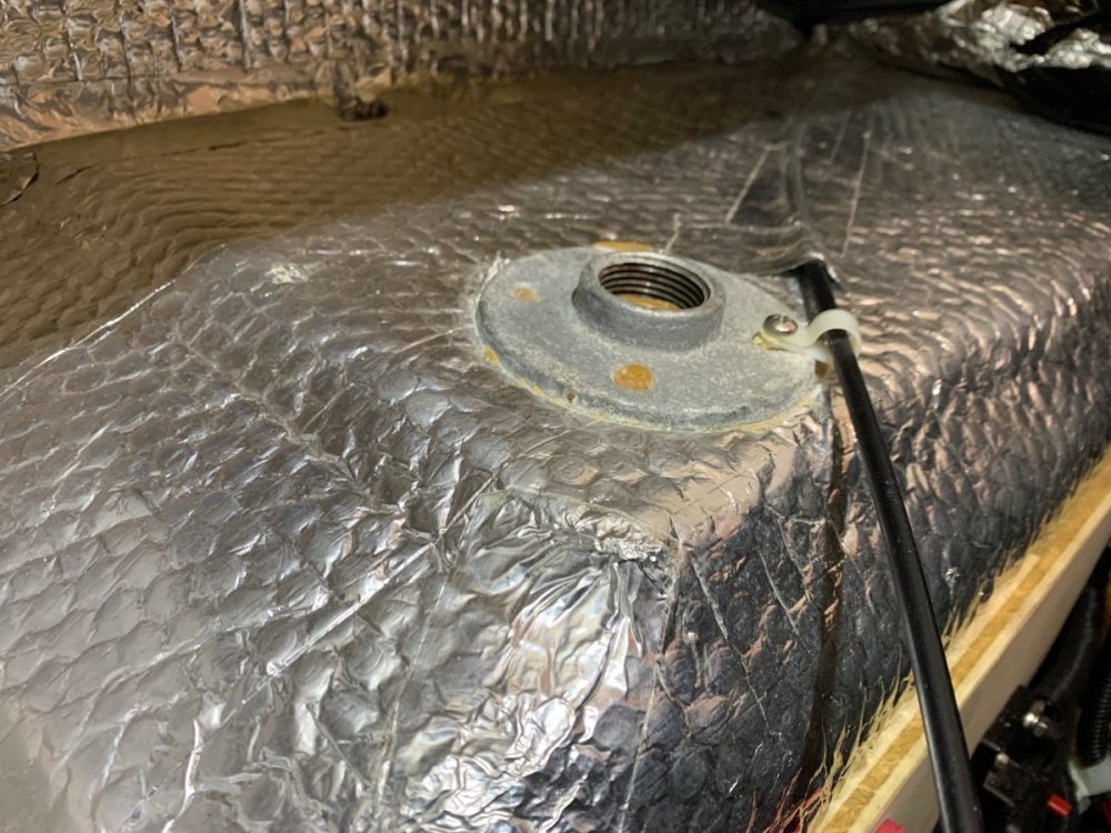

This is a pic of my street side wheel well. Although the galvanized floor pipe flange is clearly glued, I am interested in knowing what material lies directly under it; whether that raised area can be screwed into to mount electronics. Any idea what purpose that flange had, maybe a production support?

p.s.  As far as I know - the material under that insulation would simply be the inside of the hull.  I'd be very careful putting screws through it because it is highly likely that your tires are under there.

The material on top of the wheel well is fiberglass reinforced with the honeycomb material that Oliver typically uses. The honeycomb material is saturated with resin. The white plastic material is the typical Starboard marine material that Oliver uses everywhere for mounting purposes. The white material that I use is vinyl trim board material available at Lowe’s or Home Depot. I believe that Oliver, at least everything that I have seen, is glued (epoxied) in place. All of the mounting boards that I have installed are epoxied in place. I originally used plywood to mount the solar equipment to but later changed to the vinyl boards. I personally wouldn’t use plywood or other wood for mounting in the Oliver. Keep in mind that any condensation that forms in the walls (and it does in the winter) will run down into the basement area and eventually either will evaporate or run out of the scuppers underneath. You can see the honeycomb material in the upper part of the picture. My solar installation probably looks different than other 2017 or earlier models. During the 2017 model year Oliver was in the process of changing the solar equipment from Blue Sky to Zamp. I ordered my trailer without any solar equipment and added it later. Scubarx (Steve) spec’d out the previously used Blue Sky equipment which I ordered and we installed/wired it all in his driveway. I wanted the Blue Sky equipment because the controller is fully programmable whereas the Zamp controller is not, and the Blue Sky controller is MPPT vs RMS technology of the Zamp system. I then took the trailer to the Oliver factory and they installed the panels. I later remounted the controller, master switch, and circuit breaker on the vinyl board. The entire system has worked absolutely flawlessly for seven years. IMG_0762.thumb.jpeg.7f42018835ad0d3b6c2d37b81dc13d56.jpeg

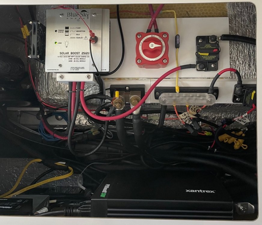

53 minutes ago, mountainoliver said:
I ordered my trailer without any solar equipment and added it later...
This is why I did not recognize the wiring in your earlier photo. Also, you have your inverter in this compartment and mine was installed by OTT under the rear side of the dinette.

Glue or tape everything possible, stay away from penetrating the hulls, except if you need to run wires. @mountainoliver has an excellent example and description here!
I installed the standard PI EMS (that did not come on older hulls) under the dinette, no mounting plate, laying on the insulation using only carpet tape to seat it. The heavy cables also hold it down and it is a large sealed box having its own base (I have a thread on this install).

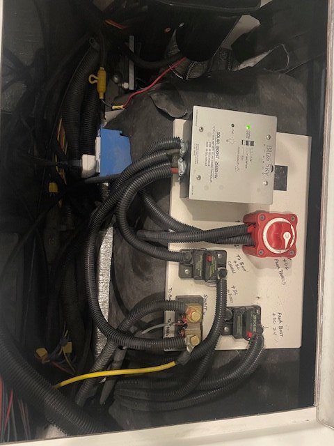

mmm ... all very intriguing ... here is my street side (under the rear bed) service bay ... from this I can share a number of things ...
  1. neither of the suggested TV Charger disconnects (from JD1023 nor mountainoliver earlier in this thread) seem to exist in my Ollie (# 069 2015) ... or, at least I'm not seeing them (my wife gets frustrated when I can't find the ketchup in the Frig - it's always right in front of me!)
  2. the busbar in JD1923's pic is not in mine (perhaps located somewhere else in the trailer?)
  3. however, there is a busbar in the dinette seat (rear) service bay ...  I'm thinking that was either placed the in the original build to better accommodate other customizations, or was moved there later with some other changes the 2nd owner made ... I'll need to chase down some of the wiring on that busbar to see if one of them is, in fact, the TV Charger connection.
    • SIDE NOTE: as I know someone will ask ... the blue junction box in my pic appears to be for 110V power to three tank heaters - 1 ea. for fresh, grey, and black tanks (switches for these are locate in the front closet along with three similar 12V switches) ... I understand these were installed as a customization for the original build/purchaser
    • my #069 has a 2500W COTEK Pure Sine Wave power inverter installed under the dinette seat (rear) - this was either installed as part of the same original build customization, or was installed later (2nd owner?) as a replacement for the original
  4. I find the handwritten notes interesting ... apparently someone else was attempting to better understand the wiring/power scheme like me - some of it helpful, some of it confusing.
Also ... interesting to see the evolution of the Ollie design/development ... note the black insulation )not silver space wrap) ... again, not sure if that was added later or was part of the original build ... I understand the original owner had requested several items focused around cold weather - tank heaters (both 110V and 12V, additional insulations prior to the shells closure, etc. ... would be interesting to talk to that owner to better understand his driving factors, and then why he sold within a couple of years (but I respect his privacy and will NOT be reaching out to him) ... lots of other little items I've noticed as well - switches and monitors located differently than today's, gas stove facing a different direction, etc.
