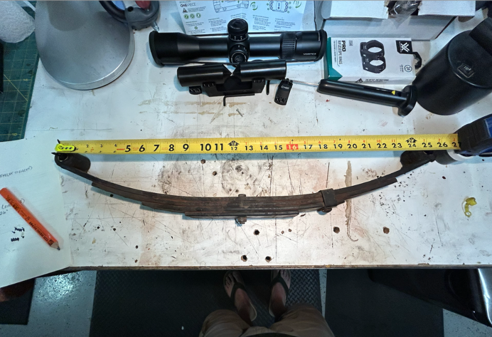

There's at least 4 or 5 "reported" broken springs from reading these forums.  Obviously, no clue how many haven't been reported here.  But I've learned that there are some good reasons for switching out the 4-packs to higher rated 5-pack springs.  Let me summarize:
1. Spring Rating: There's evidence that the Chinese-made "AxleTek" 4-packs, although rated at 1,750# may actually less than that rating.  Mike at Alcan informed me of this.  The 5-packs are rated in the 2,250# range.  So, the 5-packs have somewhere in the range of 500# more weight rating.  Can an owner "feel" the difference?  I tried.  My wife drove me around our country road neighborhood for several miles before and after swapping out springs.  FWIW:  I couldn't "feel" any difference.
2. Weak Area Near Eyelets: Of the reported broken springs - the break occurs within a couple inches from the eyelet on the top spring - this break is near the end of the second spring which is about 4.5" from the eyelet.  On the 5-packs, the second spring extends beyond the center of the eyelet about 7/16" on either side - doubling the spring material where reported ones break.  To experience a broken 5-pack spring - the break would have to take-out the two top springs.  That's likely why there's never been a reported 5-pack break.
3. Bushings:  The bronze bushings in the Chinese-made spring eyelets are measured at 1/16" thickness on my springs - the replacement Alcan spring bushings are right at 1/4" thick - 4x the material, which will take much longer to wear out.  Also, to get that 1/4" thick bushing into that eyelet the outside diameter of the eyelet must be made larger.  The OD of the AxleTek eyelet is 1.34" while the Alcan eyelet is 1.53", giving the 5-pack eyelets a more robust configuration.
4. Steel Composition:  The Chinese steel is of unknown pedigree - unless someone wants to pay for an NDA test (which I'm not interested in) we'll only know subjectively that their steel sucks compared to the recognized high-quality of US-made steel.

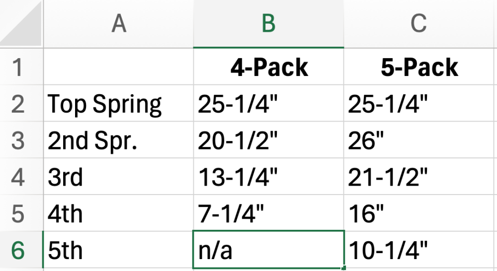

5.  Comparative Weight:  OK, the 5-packs have one extra leaf, right?  How much more do you think that extra leaf weighs?  I weighed both - the Chinese AxleTek is right at 10#; where the Alcan comes in at 18#.  Here's why:
The total length of spring material in the 4-packs is 66-1/4" versus 99" for the 5-packs, or 49% more material in the 5-packs.
10# versus 18# = an 80% increased weight for the 5-packs.
Above shows the eyelet-to-eyelet measurement of the 4-pack top spring.  Each subsequent spring length was measured straight across from end to end.  Notice the "flattening" of the arc of the 4-pack.  The other 4-packs were flattened like this one.

@Geronimo John - A side-by-side ride would provide some subjective insight to the differences, for sure.
But just looking at the configuration of the 5-pack's 2nd spring and its overall length (eyelet to eyelet) gives one the sense of confidence knowing for the spring-pack to break - it's got two layers of spring material to fail.
