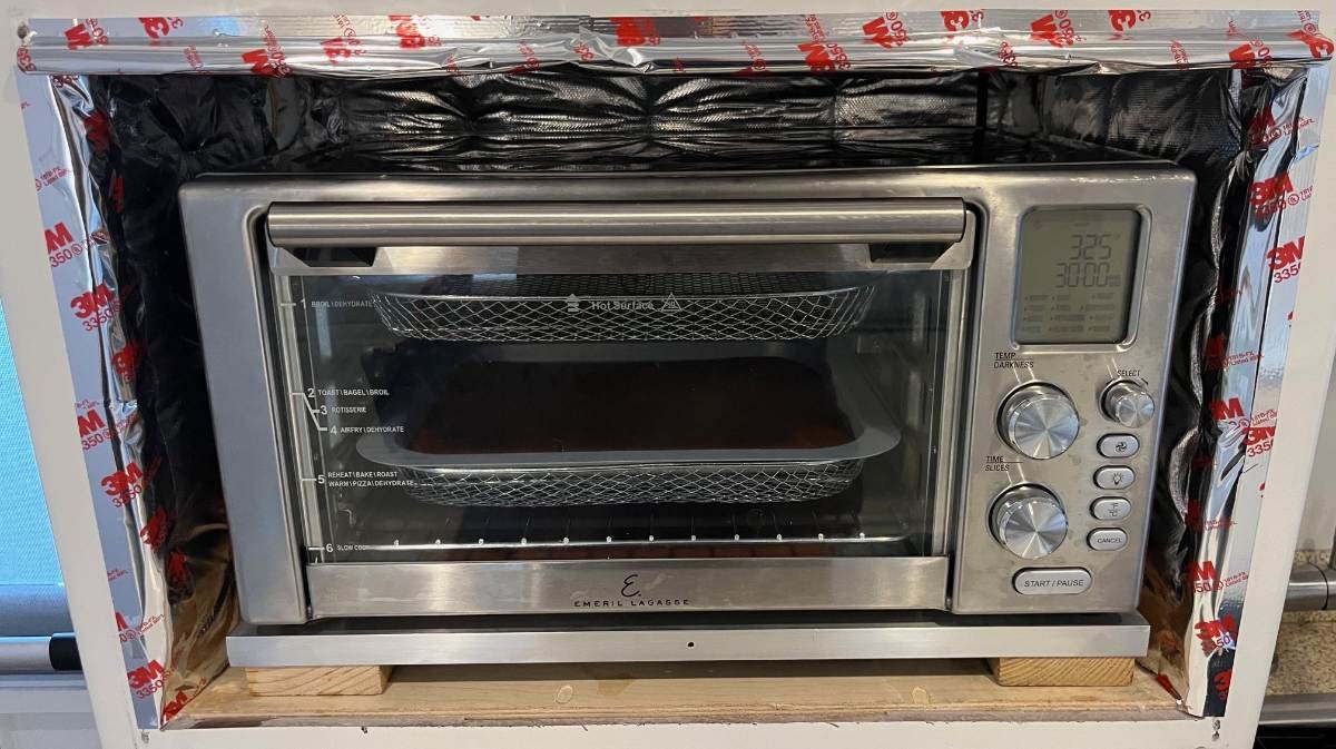

High Pointe Convection Oven Tripping CGFI Breaker
jd1923 replied to 2008RN's topic in Mechanical & Technical Tips
It would be cool if you could troubleshoot your oven with Geoff's help! I'm sure we'll hear back on this. If you have to replace it, there should be several models that would fit. Now that you had it out, you know the internal dimensions. I was able to repurpose the OEM microwave grill to fit around our new oven (by merely cutting off the inside plastic tabs). I'm actually surprised OTT would install an oven in an uninsulated closed cabinet. I know some of the very early hulls had oven vents but they stopped that (history provided in the thread linked above). We had microwave only, so without the oven feature there is little external heat, no real need for proper insulation and venting. However, a convection oven is a different thing! I suggest any Oliver owner who has an oven and uses it for more than a few minutes at a time should add proper ventilation! Two 3" vents in the top-back corners truly allow the hot oven air to escape without needing a fan. Kiln insulation helps too. We use our oven regularly, running on inverter, 400F for 20 minutes or more and the cabinet surround and the kitchen cabinet above are just warm to the touch. 😎 Good luck with this, Bob! -
Snackchaser replied to 2008RN's topic in Mechanical & Technical Tips
It still sounds like the oven is failing. Something probably has a high resistance short to ground when it gets hot, and it un-shorts after it cools. A GFCI doesn’t trip on heat or overcurrent, rather it detects a current imbalance such as a high resistance short to ground. It only takes about 5 to 8 milli amps to trip a GFCI, and you have tripped several different ones. The most likely culprits are the heating element or fan, and they can short due to moisture which explains why the microwave sometimes trips it. For example, if the heating element insulation breaks down when it gets hot or damp and leaks current to ground, then the GFCI will trip. However, this condition will not trip a normal breaker, or the ovens thermal protection elements. BTW, a thermo element will open the circuit, but that does not cause a GFCI trip. Your 0.02 ohms reading is fine. Don’t modify the cabinet either, because it’s not excessive heat that trips the GFCI. BTW, I’m sure you know this, but please be careful when removing the oven covers, the microwaves high voltage capacitor can give a nasty shock even when the oven is unplugged! You seem to have electrical knowledge, so PM me if you want help with some simple troubleshooting and possible repair of the oven rather than replacing it. It may take some back and forth that's better done outside of the forum. Good luck, Geoff -
topgun2 replied to 2008RN's topic in Mechanical & Technical Tips
I'm sure that someone here on the Forum will have some "trouble shooting" tips for you on this problem. But, I can tell you that Oliver spent several years trying to find a way to install something other than the "simple" microwave. As I understood the main issue during the time they were trying, heat dissipation was the main issue they were dealing with. Therefore, it seems (to me) likely that you have basically honed in on the root cause of your problem. Good luck in fixing what you have. Bill -
2008RN replied to 2008RN's topic in Mechanical & Technical Tips
Sorry, I have got side track on this project. We went to Colorado first couple week in August. I left the Microwave in place and we decided to just microwave things. Well we had some frozen homemade soup, and forgot to thaw it out. My wife just put in the microwave at full power. After about 5 minutes, the Microwave popped the GFGI switch in the camper. It has never did this microwaving before. So this has happened on grilling, convection and now microwaving. After the trip I connected the microwave directly to a garage GFCI outlet with a 100' 20Amp extension cord, and tested again with the Convection. It popped and It seems to take more time to reset itself. So I started looking at microwaves to see if I could find a replacement microwave, but without removing it and taking outside dimensions. Also the size of the front panel and door needs to fit the trim plate, and cannot find that data online. So I stalled out, and planted more grass at home and then took another trip. I had a couple of days to play with the Microwave and pulled it out and removed all of the sheetmetal covering the unit. i looked at every wire, connector, PC boards and nothing looks a miss. No signs of over heating. I am not an Electrical tech or EE, so I can do a few basic things. First I was surprised that the PCBs were through-hole and not surface-mount technology. Last time I have seen a through-hole board was in the late 1990's. I found 3 thermal circuit breakers. One feeding the Grill mounted to the top inside sheet metal. This feeds the Grill burner only. I found another thermal breaker for the convection in the back next to the Convection fan on the cover of the Convection burner that protects the burner and fan. Then last and not least is the thermal breaker on top of the cover to the actual microwave emitter. This connected to the main incoming circuit. The power comes into the microwave and connects positive and negative to a PCB and the ground goes to the frame, and then another wire from the frame goes back to this PBC. There is a fuse and some other components that I don't know what they do. I ohm the 3 thermal breakers at 0.02 ohms and the fuse at 0 ohms. I decided to test the Microwave. I tried each mode with the covers off for about 15 seconds, ensuring all fans were working correctly and they were. I put the main cover back on and then used the convection mode at 350. It went 15 minutes, so I stopped it and put the rear and top heat shields/vents on and then restarted and went for 20 minutes, then started the grill and ran for 20 minutes. I changed the water for new cold water in the bowl and then used the microwave to heat the water for 10 minutes. The top left rear got around 130-140 degrees I am guessing. Hot enough that I could only touch for about 1 second but it did't burn me. The Microwave unit never failed. I measured the inside cabinet and the microwave, and found for the depth was less than 1/2" clearance. In fact I problems getting the microwave to set back in, and it was so tight that I think the cord got caught between the back. Also there is a little shelf in the back and the rear shield sets directly on it. covering up 1/2 of the rear vents. Also the way the side of the trailer slopes in I was very close to touching the top back side to the side of the trailer. Also Oliver had ground a small section out of bottom of the storage cabinet above so the top rear left corner would fit in there. Darn that is tight. I had never tried the convection/grill until I started this thread, but the previous owner did use the convection. I remove the microwave in may/june to add the refrigerator fan upgrade. When I used a coat hanger wire to go from inside the microwave area into the external fridge compartment for the wiring it dropped through and down into the fridge area without resistance. The taping inside the upper corners of the fridge was poor at best. So after I pass the wire and 1/2 sheathing from the switch panel down into the fridge area with no problems, i re-taped several areas long the top of the external fridge area, with higher quality aluminum tape and sealed this whole section up. I have probably been getting some CO in the microwave compartment from the propane burner in the fridge. I decided to seal the area between the microwave cabinet and the fridge exterior compartment with spray foam. I also think I sealed the area between the hulls when I did this so I was not getting any air coming up from the basement. I am thinking that everything was so tight in the cabinet, that reducing that small amount of possible airflow caused increased temp and the main thermal breaker to open. I'm not exactly sure how this popped the GFCI unless there was arching when it opened. I have thought about testing this theory, by running in convection mode with all of the covers off, and getting the main thermal breaker positioned so i can get a heat gun to heat up the breaker and see if it trips the GFCI breaker when thermal breaker opens. I am thinking of removing the small step/shelf in the back of the cabinet. Removing the white board in the back removing some of the bubble insulation behind the microwave and then digging some of the Foam insulation to possibly get some air-flow from the basement. Questions 1. Do you think I am on the right track? 2. If my theory is correct. and the Thermal breaker has been opening. Should I replace the thermal breaker just because it has opened at least 10 times in all of my testing? You can see the shelf in the back that covers the bottom vent holes, and the white panel in the back, as well as the foam I sprayed in on the sides. Back of the microwave, the sheet metal cover that sits on the shelf. The main thermal breaker and the PC board for incoming power. -
