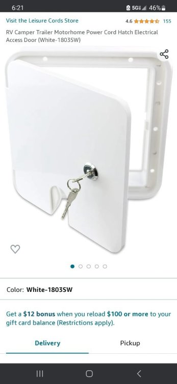

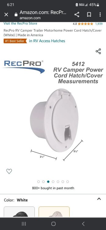

We have the little door. ($12), but your setup looks a little different. Maybe the recpro hatch? Sadly, as Steve said, there are only 50 of us to worry about it. It's a very nice feature. It does, however, take up a lot of space under the front little dinette, and adds the weight of the cord far forward.
