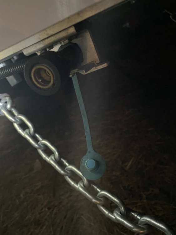

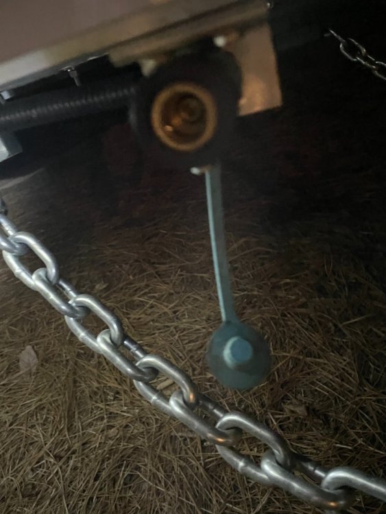

In the first picture the latch is out to the right (open) so you can connect. Once connected you need to pull it back in as in the last picture. It is just underneath the quick connect.
My only thought is to make sure you close the small latch on the female quick connect you opened to connect your hose. You will not get gas unless it is closed. My apologies if you know that and have tried it already.
