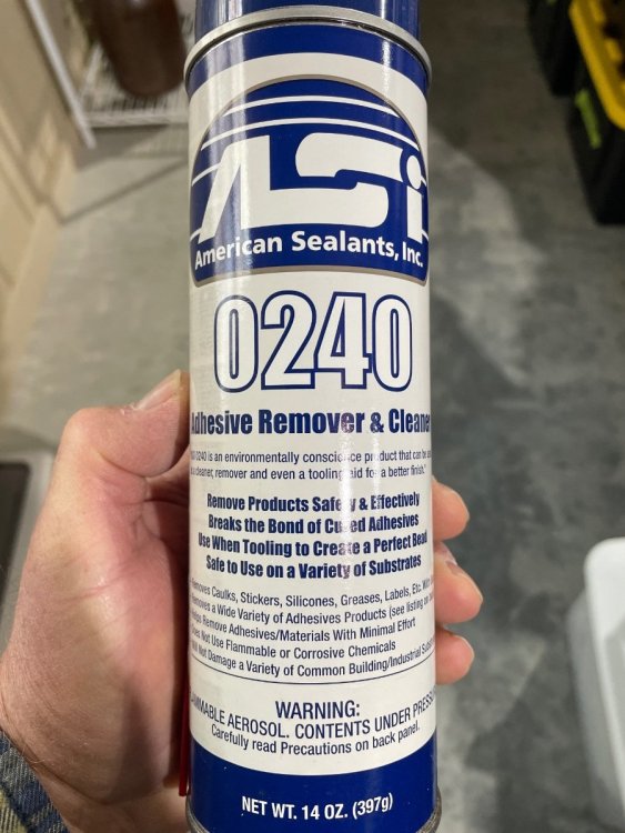

I want to remove ALL the old messy silicone caulk OTT had applied at the factory and prior owners adding to it. I just spent 15 minutes searching for their 0240 product. I found a company to buy a case. Anybody know where to buy 1-2 cans?

Scuba Rx, that ASI 0240 sounds pretty good. Especially interesting it can be used as a tooling lubricant. I will try that.
What I have been using with great success is Debond, and it is even more expensive! So I think it's going to cost you Geronimo John!
Debond
The big problem with silicone from a refinishing point of view are the oils it contains. You can clean it off with solvents and plastic razors to where the gelcoat looks pristine, but when you spray the surface with water, it still beads up all over. This is caused by the silicone oils having penetrated the pores of the gelcoat. Not completely removing these oils will interfere with the full bonding of any sealant you want to use, including silicone! You have to break out some 1000 grit automotive sandpaper and wet sand it out with the solvent of your choice (in my case, Debond). When it's all gone, I hit it with some finer grit (1200-1500), then a good polishing cleaner. The gelcoat will then look great, and be ready to be sealed, and most importantly, the sealant will adhere to the gelcoat! All this work is why I never use silicones to begin with, except in some rare instances. Also, if you do any finishing in your shop, be extremely careful to keep any rags, pads, sandpaper, or anything that was used cleaning your silicone problem separate and away from your regular shop supplies. Silicone contamination in your shop can be a total disaster for the finisher. Good luck!

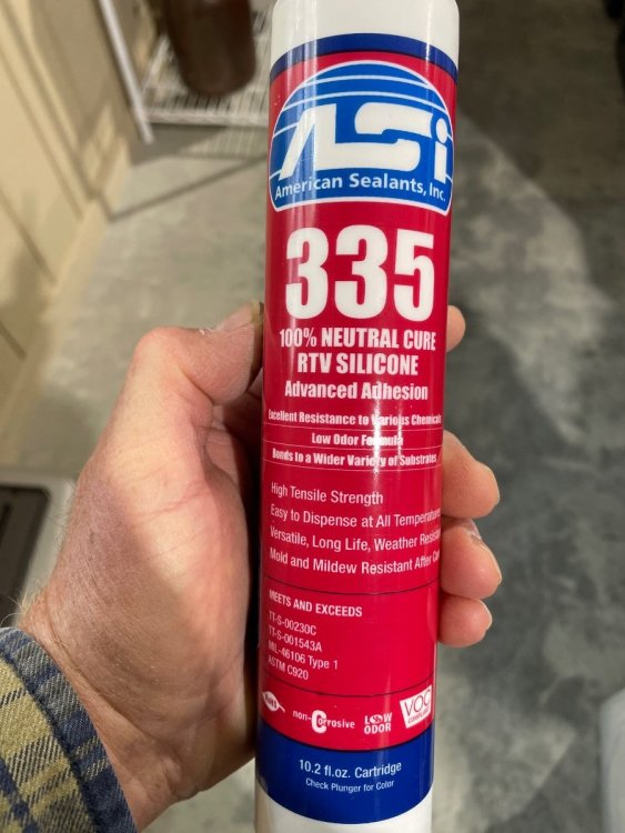

I asked service what was being used and the response was ASI 335.
  • Like 7
Bill and Martha
2019 Chevrolet 2500HD Duramax
Thanks @Townesw
I just saw this and I keep a tube of ASI 335 handy especially while traveling. 👍🏻

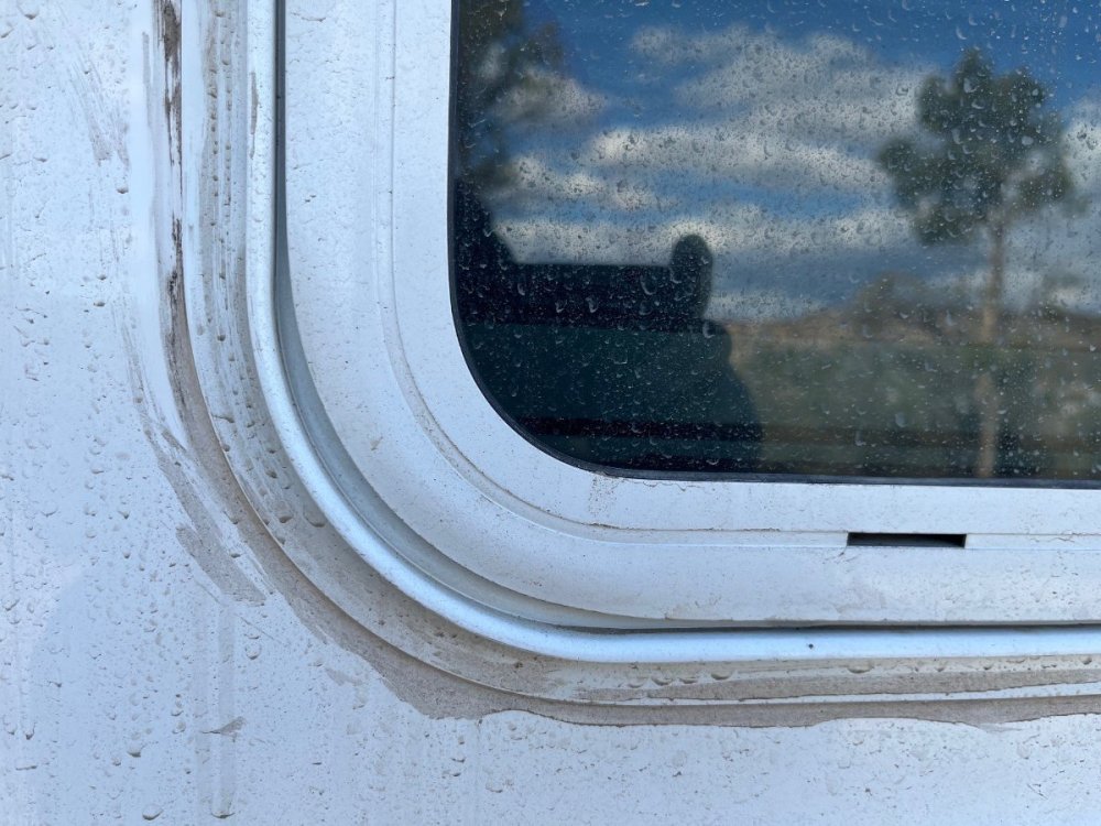

If I can get back the 100s of hours I've spent, in removing the lazy caulk other POs and installers have added, we could take a long camping trip just to break even.
There was a mention of rear windows. Here is ours after a trip, where the AZ road dust shows it well. When our hull went back to OTT service twice, both service tickets listed re-caulking. I wish they just caulked it once when built. I will remove all this and not replace it. I know many of you will warn that I need caulk, or it should be serviced regularly, but not me, not our hull. There will still be enough hidden in the crack after I remove everything visible.

Man I hear you! And that is a pretty gnarly sealant job on your rear window!😖
I pretty much have to tape everything off on each side of the joint (sometimes, just one side is necessary). It takes time, but gives me the best result. I'll wet tool the sealant before removing the tape. Then a final very light tooling (my finger usually) to take the tape/sealant edge off after tape is removed. It's important not to get too much sealant in the joint or you'll have a mess removing the tape and too thick an edge for the final tooling.  The thinner tapes leave less of an edge to deal with. I'm still trying different things to get the clean look I want. I bought some silicone finishing tools I want to try next time I get in to it.
Dave

Going to try ASI 0240 for caulk removal, too.
