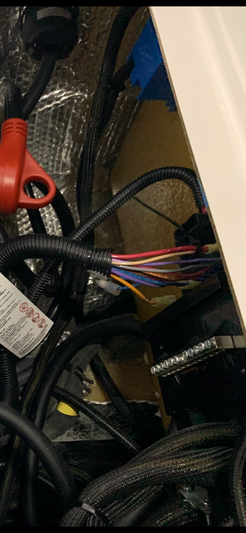

Ronbrink Posted June 25, 2024 Posted June 25, 2024 (edited) On 6/21/2024 at 5:26 PM, JDB_Traveler said: I did verify that the Lights Main (10A) and Cabin Lights (5A) fuses were good. If you haven’t resolved the issue, check the backside of the fuse box where individual wiring is connected via spade connectors. I recently lost power to the fridge and found the connector leading to its’ respective fuse loose. Not the best pic, but shows the wire bundle to look for; the red wire on the top goes to the fridge, which will require a new female spade connector to remedy. Edited June 25, 2024 by Ronbrink 1 1 2020 OLEll, Twin, 579: No installed solar, Renogy 40A DC-DC charger, 460Ah LFP battery bank/Victron SmartShunt, auxiliary Cerbo-S GX/Victron 30A Blue Smart IP22 Charger combo, Hughes Autoformer, dual Lagun tables, extended dinette table and pantry landing, tongue-mounted hoist, Beech Lane refrigerator Ventilation/Evaporate Coil fans, Dreiha Atmos 4.4 A/C upgrade. 2019 GMC Savana 2500 Cargo Work Van: Explorer Limited SE, Low-Top 7 Passenger van conversion, 6.0L V8 Vortec, 6-Speed Automatic, RWD; Air-Lift LoadLifter air suspension/WirelessAir compressor; Buyers Products cargo containment boxes/DC Cargo securement system; pending transfer of DC-DC cable run and Mechman 320A high output alternator from former TV.

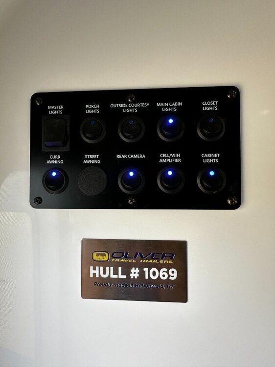

JDB_Traveler Posted June 27, 2024 Author Posted June 27, 2024 I verified all yellow wires along the strip under the rear dinette seat and all wires going to the fuse panel as tight and secure. I also verified the integrity of all wires behind the Master Lights Switch Panel. Finally, I looked behind both rear cabinet wall panels and nothing jumped out as out of place or loose. Attached is a picture of my master lights switch panel and the three switches without power align with the lights I don't currently have. The only thing remaining I can think of is to verify if I have power going to the fuses and switches, don't currently have a multimeter (I know lesson learned, never travel without one). I am open to any other suggestions or ideas.
jd1923 Posted June 28, 2024 Posted June 28, 2024 58 minutes ago, JDB_Traveler said: Attached is a picture of my master lights switch panel and the three switches without power align with the lights I don't currently have. So your Porch, Outside Courtesy and Closet (the ones without a lighted LED) do not work, and all the others do? Your first post listed more lights out. Those 3 have proximity to the doorway area. They must share a power source or ground separate from the others. Our older hull has no LEDs so in a way you have built-in test lights. I'm not a service ticket guy, but I would in your case. Send OTT this picture and explain exactly which lights do not work. Anybody who wires these for OTT should determine cause in a minute. Its likely not at the panel but at the 12V feed or a specific ground. 1 Chris & John in Prescott, AZ | 2016 EII #113 | '01 Ram 2500 Cummins!
jd1923 Posted June 28, 2024 Posted June 28, 2024 Something else just dawned on me… The three lights out, are likely the same three you do not have switches on the remote panel, right of the kitchen. These are two-way switches and the others are all 3-way. This is another indicator of cause. Chris & John in Prescott, AZ | 2016 EII #113 | '01 Ram 2500 Cummins!

JDB_Traveler Posted June 28, 2024 Author Posted June 28, 2024 The lights from those three switches do not work along with reading lights, overhead tap curtesy lights, and bathroom lights, those don't have a switch but I am assuming their power is controlled by those switches. Can you more clearly explain the two way and three way switch comment? What do you mean by this being another indicator of cause? I have been seeking help from Oliver with little to no success. I have requested help in understanding the wiring layout and they have been very hesitant to say anything because of liability concerns despite me telling them I would sign away liability. If I have to seek Oliver trained technical expertise I have to drive 6.5 hours to Salem, OR. I am really trying to avoid the drive. I am also struggling to understand how the people that build these trailers can't solve this. I agree that this is probably a 1-wire issue. I greatly appreciate the help and would welcome any other advice and suggestions.

jd1923 Posted June 28, 2024 Posted June 28, 2024 (edited) 3 hours ago, JDB_Traveler said: Can you more clearly explain the two way and three way switch comment? What do you mean by this being another indicator of cause? The two-way switches are where you have one switch one light. Three-way switches allow turning the light ON/OFF from two different switch locations, like from the main light panel you pictured and a secondary light panel (like one over the curbside bed or under the pantry). 3 hours ago, JDB_Traveler said: I have been seeking help from Oliver with little to no success. I have requested help in understanding the wiring layout Asking re the wiring layout is hypothetical. If you are not able to test circuits for voltage and ground connections for continuity, nothing that can be worked over the phone. An electrician has been suggested or even a local mobile mechanic that is good with auto electrical 12VDC can help. Edited June 28, 2024 by jd1923 1 Chris & John in Prescott, AZ | 2016 EII #113 | '01 Ram 2500 Cummins!

John Dorrer Posted June 30, 2024 Posted June 30, 2024 On 6/25/2024 at 7:32 AM, Ronbrink said: If you haven’t resolved the issue, check the backside of the fuse box where individual wiring is connected via spade connectors. I recently lost power to the fridge and found the connector leading to its’ respective fuse loose. Not the best pic, but shows the wire bundle to look for; the red wire on the top goes to the fridge, which will require a new female spade connector to remedy. +2. We got to the Rally and had no television. We also have a 2022 E2 and went under the rear dinette seat to check the backside of the fuse panel and found wire had pulled loose. Suspect it was major bump on I-24 near Nashville on the way to Guntersville. Plugged it back in and all was good. 4 John & Susan Dorrer, 2013 F250, 6.2 gasser, 4x4, 2022 Legacy Elite 2, twin beds, Hull #1045, Jolli Olli -
