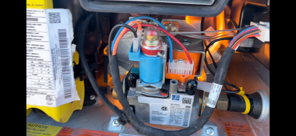

On 1/16/2025 at 8:27 AM, Galileo said:
What I did find was a little scary. (See the attached photo.)
the nut holding the main gas line to the burner manifold was quite loose.
That was our FIRST Problem.   If you go back to all the various Truma postings...you'll find the first one we posted was all about that loose fitting.
Truma Factory had us return our unit to them and they discovered their production line tools had the wrong torque setting for that coupler...and that it backed off from vibration over time.
The SECOND issue is the one that caused the Oliver Recall, non-crimped burner tubes.  The symptoms are 'very similar' in that both cause a build up of gas that ignites with a whoosh / thump and then blows out the burner....it keeps trying and occasionally it starts and runs.
In the picture below are 4 different photos from different posts we've made.
First - What the raw gas ignition looks like for both issues:
Still Pix of Burner Flare due to either: Loose Coupler --- or --- Disconnected burner tubes
Movie showing ignition when too much gas is in the chamber.
A photo of the culprit coupler - Our Coupler Issue -
A movie showing the loose coupler could be turned easily with fingers....not tight at all.
Second - Our Burners Rattle Loose Issue
Third - The NEW ASSEMBLY that we are having installed today at a repair center.

@Galway Girl Craig, this is the best post so far on the problem(s) that have plagued the Truma water heater. If I had one I'd take it out and make it look just like your last photo, even if it were still in warranty. For those still in warranty, your unit will likely be out by the time the parts arrive to repair it. I would not wait until my trailer burns down.

Great pics/vid and solid write up @Galway Girl
