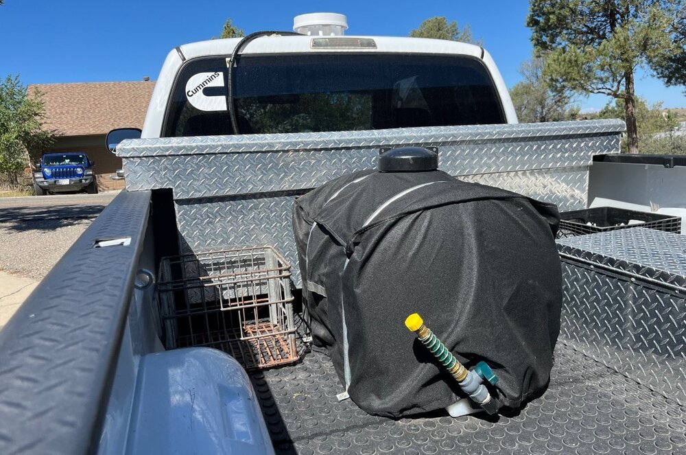

Moderators SeaDawg Posted January 18, 2025 Moderators Posted January 18, 2025 (edited) The way Oliver plumbs the black tank does not lend itself to use as a spare freshwater tank. It can be used for extra grey water. Adding a freshwater tank to the truck bed has been done by a number of folks. We have a water bladder we can use,,as needed, to be carried in the truck bed. Edited January 18, 2025 by SeaDawg 3 2008 Ram 1500 4 × 4 2008 Oliver Elite, Hull #12 Florida and Western North Carolina, or wherever the truck goes.... 400 watts solar. DC compressor fridge. No inverter. 2 x 105 ah agm batteries . Life is good.
