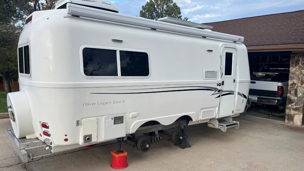

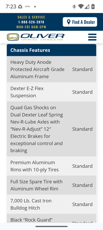

On 3/8/2025 at 10:26 AM, rich.dev said:
I was wondering same, we have a 2023 with the D52 axles. @John and Debbie check the label on your axles, if you see D52 you have the 5200 lbs axles, the 3500lbs on the label refers to the springs (2 x 1750lbs), NOT the axles. See pic.
The axle label includes "nev-r-adjust"......does that mean this axle does not include "nev-r-lube"?  Confusing. Does the 2022 have both
Edited by mossemi
Rotate picture

3 hours ago, Gliddenwoods said:
The axle label includes "nev-r-adjust"......does that mean this axle does not include "nev-r-lube"?  Confusing. Does the 2022 have both?
@John Dorrer had answered, YES for 2022 to 2025 Olivers. But to be sure...
You should just check yours. Remove one wheel so you can see the drum. If you see the bearing cover plate like in the first picture you have the Nev-R Lube bearings. The cover plate is larger and has Nev-R Lube stamped into the cover.
Second picture is the only picture I had with the drum on, just before I did a first bearing service on our older hull. It shows the old style axle with inner and outer bearings that must be packed with grease. The bearing cover is smaller without stamping. I believe if you have the EZ-Lube model, the cover plate has a Zerk fitting to add grease. EZ-Lube is not Nev-R Lube.

According to Oliver all 2022 LE2 's received 5200 lb. axles, with Nev-R-Lube axles/hubs, Nev-Adjust brakes. His trailer is 200+ Hull #'s after ours😊
Edited by John Dorrer
Typo
I have shared with you numerous times that 2022 LE2 's have:
1. 5200 lb. Axles
2. Nev-R-Lube axles/Hubs
3. Nev-Adjust brakes
This was confirmed by Oliver. Your Hull # is 200+ after ours.
Since I'm responding to this again, why are you replacing springs? The problems were with old Oliver's with the 3500 axles. You have the beefer axles and shouldn't need to replace them at this time. Unless you are planning to drive to Alaska, or drive wash board roads, and/or chemically treated roads, you shouldn't need to replace them.
1. 5200 lb. Axles
Since I'm responding to this again, why are you replacing springs? The problems were with old Oliver's with the 3500 springs. You have the beefer axles and shouldn't need to replace them at this time. Unless you are planning to drive to Alaska, or drive wash board roads, and/or chemically treated roads, you shouldn't need to replace them.
Alcan said they contacted Dexter and Alcan said Dexter my Oliver did not have Nev-r-lube. In addition others had a different opinion of both you and Alcan. So I went on a mission to determine for myself even tho you, and others, were so sure of themselves. Not until late this morning did I determine for sure I have both.
