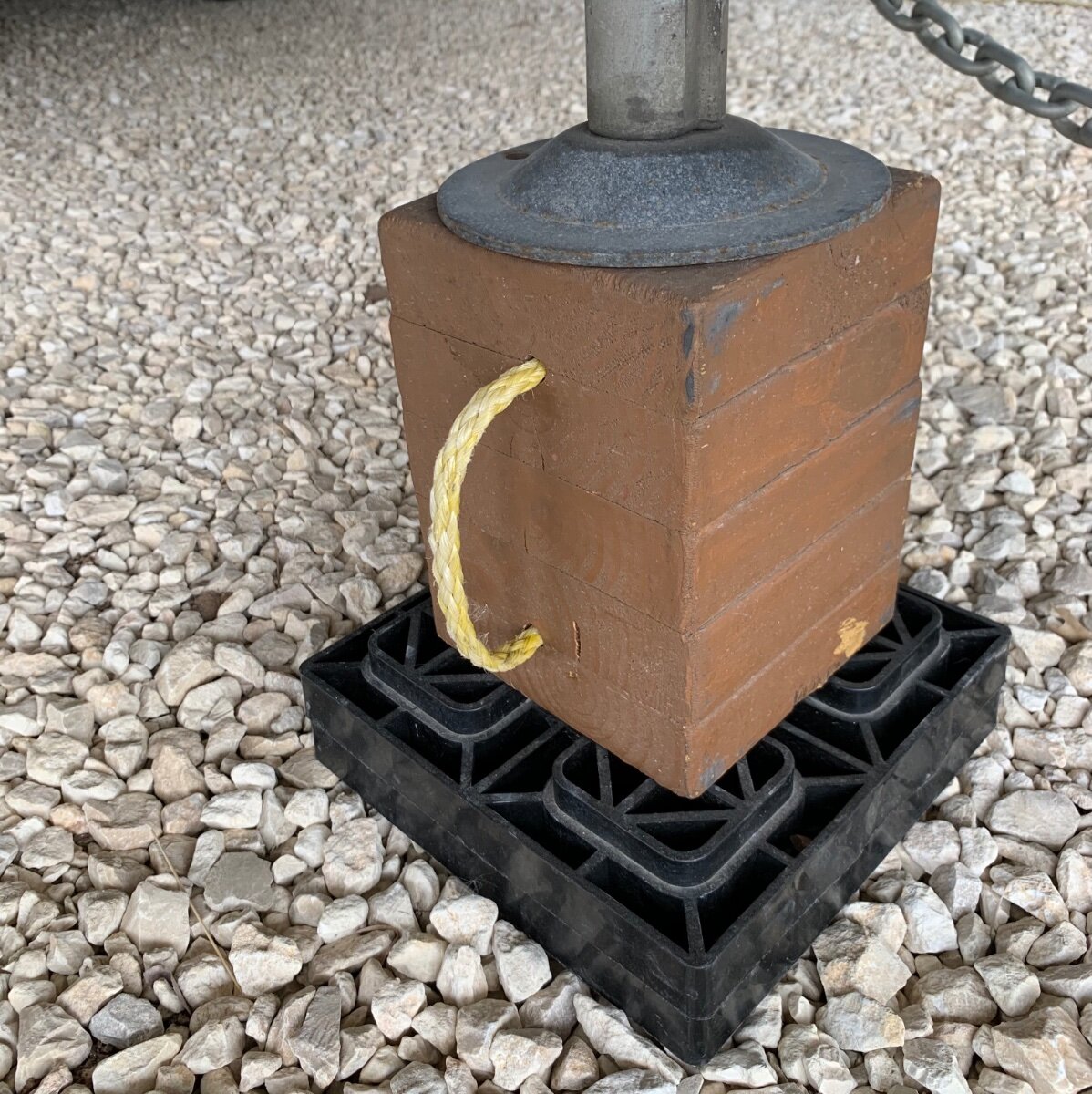

Wood blocks and legos… my jacks rarely extend more than 6” or so.  Less is better.  If I do drive off while they are down chances are they will just slide off the block.

I've never lifted the trailer with the jacks, never moved it with the foot loaded and always stacked 5 or 6 inches of 2x6 wood pieces under them to avoid full extension.
Very wise!

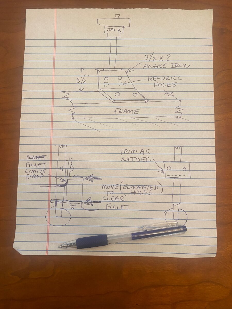

I totally agree that the mounting bracket was probably welded in the wrong position, and I’m sure that they will somehow make it right for you.  But I also think this could be fixed with a drill and angle grinder without disturbing the weld.  The jack needs to be lowered about 1” to match the other jack, and probably less than that to clear the lid.  On my trailer, it looks like there is enough room to achieve that.
There is plenty of space to drill new holes in the 3-1/2” x 2” angle iron to lower the jack by up to 1”.   However, there is limited room to lower the jack before the welded bracket hits the floor.  It looks like the jack could be immediately lowered about 1/4 to 3/8 without any interference, but then it’s hindered by a fiberglass fillet where it transitions from the frame rail to the floor.  This could be enough to gain the clearance you need, but you'll need more drop than that so the proposed new holes don’t overlap with the existing holes.  Or fab a new piece of angle iron, I'm sure you could source it locally.
You could probably gain another 1/8” or more drop by re-positioning the angle iron and (outside) aluminum bracket to clear the obstructing fillet.  The mounting holes of both brackets are elongated, and the hole though the fiberglass is oversized, to allow for truing the jack angle.  These brackets are held by the long bolts that go through the frame and you can loosen them just enough to tap the brackets over to help clear the obstructing fillet.
If still more drop is needed, to avoid overlap of the new holes, then you can slightly trim the bottom edge of the welded bracket with an angle grinder to make up the remaining distance.  Before drilling the new holes in the angle iron, I’d experiment lowering the jack to assure you can get adequate drop and hole separation.
This shouldn’t  impact the structural integrity and it I personally wouldn’t hesitate doing it.  I'd ask Oliver to reimburse me for fair value of a new jack.  Sorry for the crappy drawing, but hopefully it helps clarify my suggestion.
Cheers, Geoff
  • Care 1
@Geronimo John Thanks for taking time to consider and draw out a possible fix.  Appreciate your time!  I'm impressed with your engineering skill as it's way above me!  I'm neither an engineer or mechanic.  I don't even own an angle grinder so trying to go this route would not exactly be in my comfort zone.
