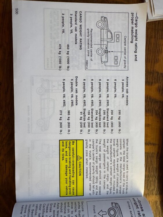

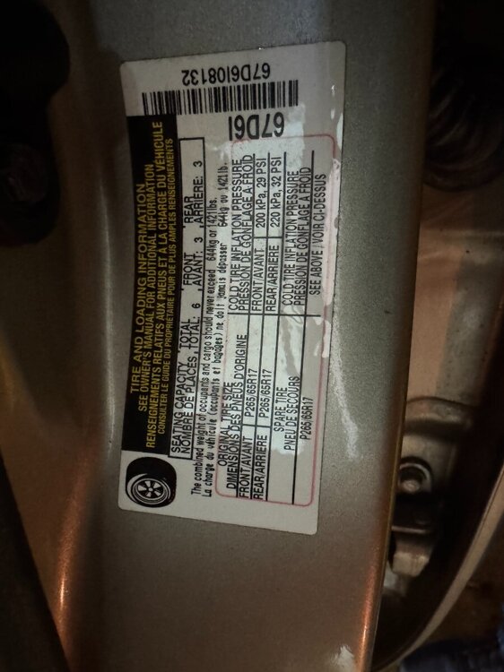

In a related question - Why is there a difference between the max cargo load in the Tundra's Owners Manual (600 lbs) and the cargo load on my door sticker (1421 lbs)?  (See photos)
IMG_3183.thumb.JPG.6bbb3a2024df4c40246754189ef29752.JPGIMG_3182.thumb.JPG.529983ed7db84de0df9d8e3d4e7b0e94.JPG
Most of us suggested no but you can just make it, if that's what you want. However, the mountains of the Pacific NW is not an easy traverse. I have an older Ram Diesel and wish it had more than a 4-speed trans and an exhaust brake like modern diesel trucks have today. The mountains we travel through are not an easy climb for the trans and not as easy descend on the brakes. I also upgraded wheels an inch larger to upgrade to larger brakes of the next gen Ram, big help.
I believe the 600 LB number is subtracting the average weight of a full 5 passenger load from the total available 1421 LBS.

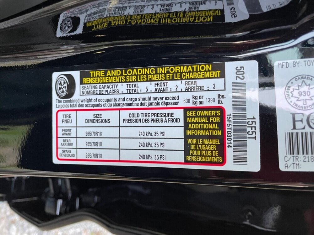

Another thing from your tire pressure label. Same on our GX, Toyota puts P-rated tires on these trucks, P stands for passenger cars. It's a must with towing to upgrade to LT tires. Our GX now has LT265/70R17 Load Range C tires and if I was going to tow with it regularly I would have purchased Load Range E instead.
Your specific door sticker controls over the more generic owners manual.  The door sticker on our Tundra also reads 1421 lbs. payload capacity.
