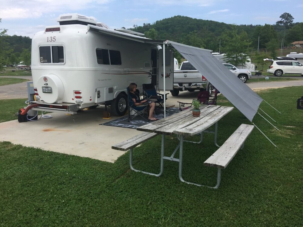

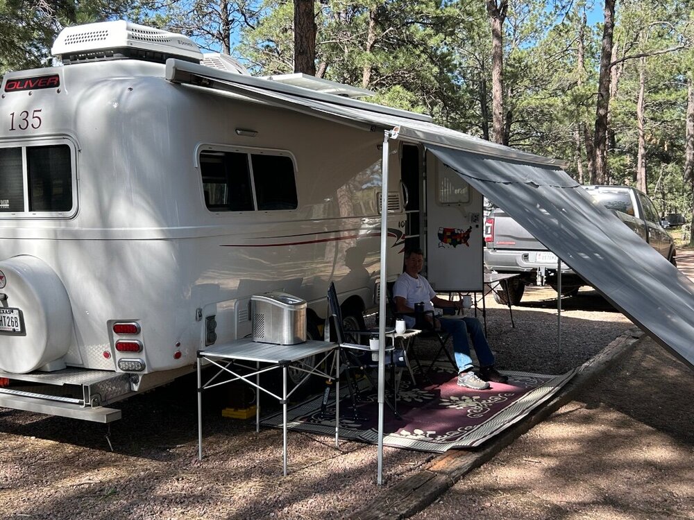

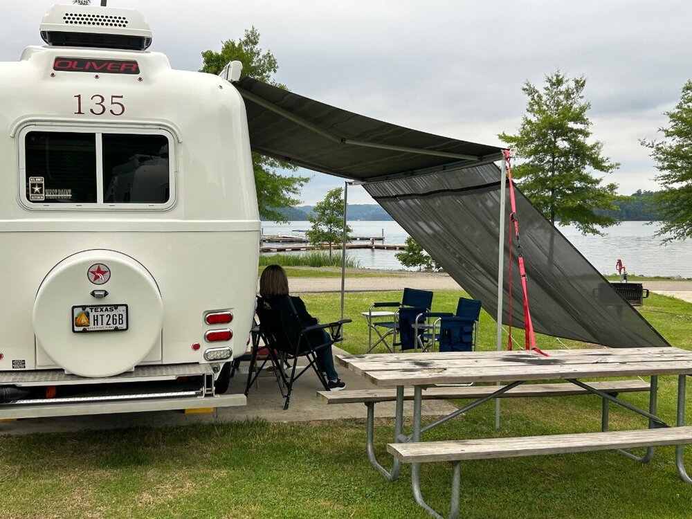

We have the manual Fiamma awning and have used it quite a bit.  We’ve done a lot of hot weather camping and it provides shade when sitting and cooking outside.  It has also provided shelter during light rains so we can sit outside and enjoy the weather.  We have a sunshade that easily hooks onto the awning providing even more shade and enables the awning to be used even in pretty windy weather..  I’m not a fan of automatic awnings, but it seems that is where RV’s are trending.
At Lake Guntersville.
At US Air Force Academy, Colorado Springs.
Lake Guntersville.
  • Like 8

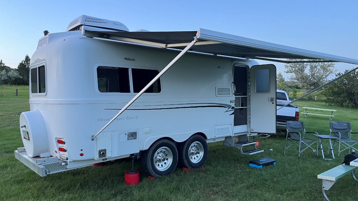

So I thought, why not try the awning? It truly made a difference. With the breeze off the lake it felt 20 degrees cooler in the shade of the awning. It worked well. I could tighten it and then you could hear it vibrate in the wind and a turn looser was perfect.
The setup was less cumbersome than I had remembered it. I took it down as it got dark and good thing since we had light hail, heavy rain and winds that literally shook the Oliver!
I couldn't figure out the rafter. The awning had a proper receptacle for it on the extended side. Up along the Oliver roof it did not seem to have the same mount, even though the rafter has identical fittings on each side. I got it somewhat connected and even being tall I could not reach the tightening screw without a ladder or at least standing on metal milk crate we have. I just left it there untightened as it did not seem to matter. Is the rafter truly necessary? Any help or advice on how to mount it correctly and get it tightened?

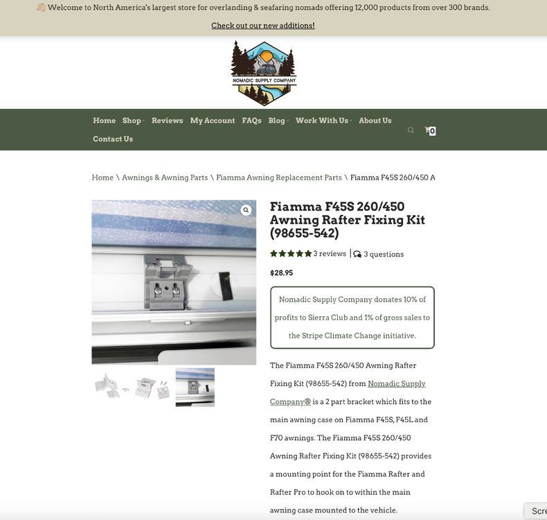

We rarely use the rafter.  As I remember it has a hook like thing on the trailer side and I can’t remember how it attaches to the awning.  I think it is to provide stability, although we’ve not noticed much difference.  I think it also helps in rainy situations if you forget to get enough angle for drainage.  Just don’t try to crank the awning in with the rafter still deployed!  Mike
This is the rafter fixing point for the trailer side.  And I usually tighten the rafter knob before raising the awning to a height I can't reach.
