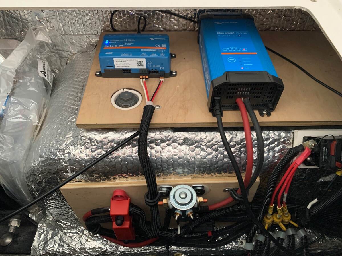

I think making a LiFePO4 investment is important and without internal heaters you’ll be doing work-arounds for as long as you use them, disconnecting them, heat blankets or something. Do it once, do it right!
We live in a moderate climate, but over the last few nights with lows to 20F, at 8AM the Ruuvi in our basement at the rear wall measured 27F and the Epoch BMS kept all out battery cells right at 36F. I prefer knowing we can travel any day, at any temp, and use and charge our batteries! 😎
$500 vs. $1200 per 300 Ah is a huge difference though. When we bought our “Essentials” I don’t believe there was an Eco Series available. We purchased Essentails since they were lower cost vs. the Elite Series.
