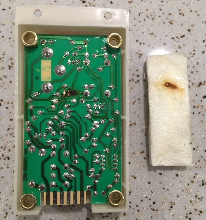

Popular Post John E Davies Posted June 29, 2017 Popular Post Posted June 29, 2017 My water heater quit working on gas a couple of days after delivery. I did some basic troubleshooting and determined after ten minutes that the ignitor was not firing. The system would cycle on and off three times, then lock out with a solid red light. The overtemp switches were not tripped, and there was gas, which I proved by carefully sticking a long camp stove lighter in the burner hole. I clicked the lighter and the flame POPPED and whooshed out and burned all the hair off the back of my hand. Check, there is gas! Note to self: do not do this again... I called Jason at Oliver Service and asked if he could send me a replacement board so I could install it myself. He told me that they do not warranty the appliances and I would have to take it to an RV dealer for repair. Fine.... I found a new OEM module on Amazon for $79, and also a much better aftermarket one for about the same price, but it would require a new plastic cover. https://smile.amazon.com/dp/B0002MG2IK/_encoding=UTF8?coliid=IY2Y0Y0X7RVZF&colid=1X5H11EH41351 https://smile.amazon.com/dp/B007HRVXY6/_encoding=UTF8?coliid=I3LZPCEN833TPC&colid=1X5H11EH41351 Since it was going to be a warranty repair, and I am a confirmed cheapskate, I scheduled an appointment at a local shop in Spokane. They told me it would be three weeks before they could see me, and that they stocked a lot of boards for the Suburban heaters, so most likely they could fix it while I waited. I told them that I would be surprised if the job took more than fifteen minutes, and access to it was great. Three weeks later I showed up, checked in, watched with concern as they took Mouse away, and then I waited. Half an hour later I was called into the office. "The board is bad." ME: "Right, I knew that and I told your tech." "In order to do this under warranty we have to order a replacement board from Suburban, and it will take two to six weeks to get here, do you need the water heater to work before then?" ME: silence, counting to ten very slowly. "Sir?" ME: "I do need it to work on propane. Is there an alternative?" "We can install an aftermarket Dinosaur Electronics board, it is a much better part and has a five year warranty, and we have plenty of those in stock since the Suburban boards fail so often." ME: Sinking heart. "How much would that cost?" "The board is $129 and the cover is $10, and it will be $279 total with labor." ME: "I wish this was mentioned when I talked three weeks ago. Just put it back together and I'll order the part from Amazon and fix the heater in two days." "OK, fine, that will be $50 plus tax for the diagnosis." As I left, the tech who did the work told me quietly, "I left your old board on the floor at the entry, and I also left a used one that was in our junk box. We strip stuff like that off old water heaters when we scrap them. It will probably work fine for years. They sure did build your trailer nice!" I was floored and relieved, and my faith in mankind got a very small boost. I thanked him and left with Mouse, feeling a lot better. I got home, plugged in the board and the heater fired right up. Woohoo! My old (brand new) board that failed (water pump is to the left): The underside, showing the bottom of the fried resistor. The white foam strip goes on the PC board and keeps it off the mounting surface (the water pump and manifold assembly plate). If I had the notion, I could have replaced that resistor for less than a buck.... I don't know how I should feel about the dealer, their parts prices are _over_ MSRP and they sure try to screw you, but then the tech went way out of his way to make things right. He could have got into trouble with his boss, too. Moral of story: unless it is an expensive repair or you can live without a part for a long time, just fix it yourself or have a buddy do it for you. I hope to never go back to a dealer, ever. There is no way I was going to leave Mouse there, and then have everybody start crawling around inside, looking. John Davies Spokane WA 11 4 SOLD 07/23 "Mouse": 2017 Legacy Elite II Two Beds, Hull Number 218, See my HOW TO threads: Tow Vehicle: 2013 Land Cruiser 200, 32” LT tires, airbags, Safari snorkel, Maggiolina Grand Tour 360 Carbon RTT.
Moderators topgun2 Posted June 29, 2017 Moderators Posted June 29, 2017 I'd guess that the tech knows the kind of place that he is working for and wanted to try to make things right. I'd also bet that this tech will not be working for these people for very long unless he has absolutely no other choice. Glad you got it fixed but sad that it cost you $50 to find out what you already knew. Bill 1 1 2023 Ford F150 Lariat 3.5EB FX4 Max Towing, Max Payload, 2016 Oliver Elite II - Hull #117 "Twist" Near Asheville, NC
Hikegsm Posted June 29, 2017 Posted June 29, 2017 What a terrible experience! I am glad the technician helped you in the end. Unfortunately, I am afraid most dealer repair shops, at least the 4 we have tired anyway, are much like the one you visited. We don't know how to repair or diagnose our camper problems ourselves. This is the one of the main reasons we bought an Oliver. Luckily we live only 4 1/2 hours away from the factory if things go wrong with ours. From reading your posts, you seem well equipped and skilled to handle most anything that goes wrong yourself. I hope you don't have to you put those skills to use again anytime soon. Yvonne 1 Yvonne & Doug 2017 Legacy Elite II, twin bed Hull #223 2017 Ford F-250 Lariat, crew cab

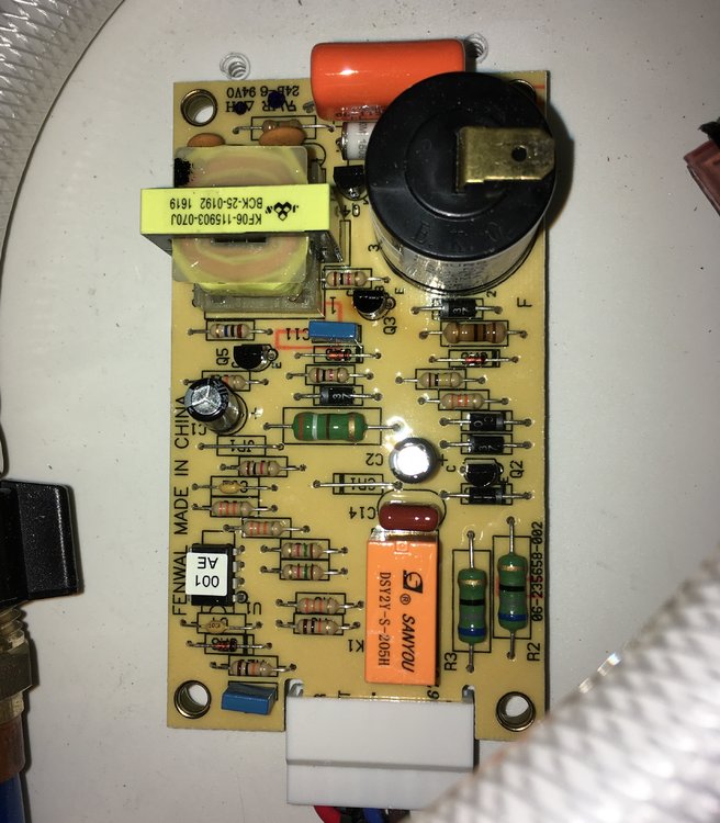

twdavid Posted July 7, 2017 Posted July 7, 2017 Hi John, We are having the same problem with our having no hot water. I bought an ignitor board, but I can't find where to install it. Where is it located?
Moderators topgun2 Posted July 7, 2017 Moderators Posted July 7, 2017 twdavid - unlock and lower the hot water heater panel on the curbside exterior of your Ollie. The board should be in there. Bill 1 2023 Ford F150 Lariat 3.5EB FX4 Max Towing, Max Payload, 2016 Oliver Elite II - Hull #117 "Twist" Near Asheville, NC
John E Davies Posted July 7, 2017 Author Posted July 7, 2017 Hi John, We are having the same problem with our having no hot water. I bought an ignitor board, but I can’t find where to install it. Where is it located? It's not outside, it is inside the cabin, on my trailer (Hull 218).... In the top pic, one of the water pump fittings is barely visible to the left (forward) of the board. It is hidden by a yellowish plastic splash cover, remove two philips screws after unplugging the igniter cable and low voltage connector. The board is stuck down with tape. Guard the screws with your life, they want to roll down and vanish into the dark recesses, and you can't retrieve them with a magnet. I suggest that you buy the aftermarket board mentioned above, unless you can find a free one. I don't know why they put the board there. Right next to a water system component that needs regular servicing (filter cleaning) is NOT a good location. I would have selected a much drier spot in the aft compartment. There is no reason for it to be in a quick access compartment... John Davies Spokane WA 1 SOLD 07/23 "Mouse": 2017 Legacy Elite II Two Beds, Hull Number 218, See my HOW TO threads: Tow Vehicle: 2013 Land Cruiser 200, 32” LT tires, airbags, Safari snorkel, Maggiolina Grand Tour 360 Carbon RTT.
Moderators topgun2 Posted July 8, 2017 Moderators Posted July 8, 2017 That's weird but smart - with every camper I've owned, the board has been inside the exterior compartment and I just assumed that it was in that location with the Oliver. Sorry about that! - Bill 1 2023 Ford F150 Lariat 3.5EB FX4 Max Towing, Max Payload, 2016 Oliver Elite II - Hull #117 "Twist" Near Asheville, NC

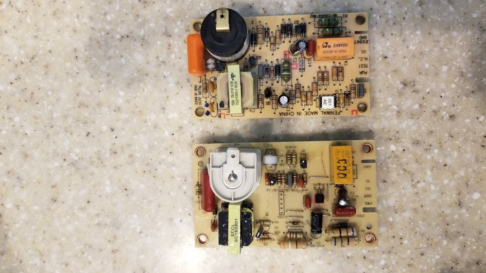

KountryKamper Posted June 26, 2018 Posted June 26, 2018 Our Suburban water heater board failed too on our recent trip out west. I contacted Jason at OTT and he was kind enough to send a replacement board to the house. It was a easy replacement, one plug, one igniter wire and 2 screws. I had to return the old one to OTT with the model & S/N so they could process the warranty. The new board on the bottom was different from the original on the top. [attachment file=Water Heater.jpg] Tom & Cheryl LE II #305 2018 GMC 2500HD SLT Duramax
Moderator+ ScubaRx Posted June 26, 2018 Moderator+ Posted June 26, 2018 ...BTW my water heater has been working fine since I swapped out the burned board for the free used one the tech gave me. John Davies Spokane WA John, will Suburban not warranty the old board? You’ve still got it to send back. Then you’d have an extra. The same board will work in the water heater or the furnace. Steve, Tali and our dog Rocky plus our beloved dogs Storm, Lucy, Maggie and Reacher (all waiting at the Rainbow Bridge) 2008 Legacy Elite I - Outlaw Oliver, Hull #026 | 2014 Legacy Elite II - Outlaw Oliver, Hull #050 | 2022 Silverado High Country 3500HD SRW Diesel 4x4
skalywag Posted June 26, 2018 Posted June 26, 2018 "I don’t know why they put the board there. Right next to a water system component that needs regular servicing (filter cleaning) is NOT a good location. I would have selected a much drier spot in the aft compartment. There is no reason for it to be in a quick access compartment…" FOUND it - I was able to remove the bad board with out removing the screws (which are unseeable) and have it in my hand. Looks exactly like John's burnt marks and all. Now to replace Legacy Elite I #240
Trainman Posted September 5, 2019 Posted September 5, 2019 Thanks everyone for the info, John Davies is the board from Amazon that you posted on your reply the one I need for my 2019 Oliver. Also is the board screwed on, or is it on with stick tape and I just pull it off. I did talk with Jason at Oliver and I just told him about the water heated not working on gas, but I have not asked about a board replacement at that time as I had not checked it out. When we got back from camping I have now checked it out and it appears to be the board, thanks for everyone help here. I will just order a new board and do the job myself as you have convinced me that the original boards are junk. I will contact Oliver Service (Jason) and see if the will reimburse me, but don't expect to see any money for a replacement. My biggest gripe here is that Oliver knows these boards go bad and still keep installing them in there trailer and then not wanting to correct the problem with a replacement board of better quality. It's pretty much BS on warranty work on appliances, take your trailer to a dealer, wait 3-6 weeks for them to look at it and then wait another 3-4 weeks for a replacement parts, I would just soon pay for it and be done with it. trainman 2019 RAM 1500, 5.7 Hemi, 4X4, Crew Cab, 5'7" bed, Towing Package, 3.92 Gears. Oliver was sold.
