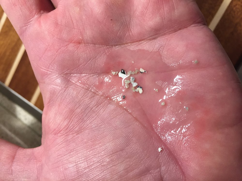

Update: Had time today to work on the plumbing and got to the problem.  First, as big thanks for all of you who helped me trouble shoot!  I started from the toilet and work back to the city water hook up.  The shut off value for the toilet was clean with plenty of pressure, but the hose connection to the toilet was full of what I can only call plastic chips.  A lot of them.  (SEE IMAGE) I opened the toilet shut off value and used the hose to wash all the derby out on the connection.  That fixed the toilet.
Next the bathroom sink shower, I started to remove the four screws that hold the towel rack to the cabinet but stopped when I noticed it was clacked in place.  Being a day from home I will do this when I get back to the shop.  I look forward to seeing the cartage I have heard so much about.  Next the kitchen sink, same thing - plastic chips.  Cleaned and flowing better now.  Last was the water filter on the water pump.  Shut the value so no back flow and took off the filter trap.  Full of hardened glue strings and bits of black plastic.  (SEE IMAGE)  How or why this got into my system is an mystery to me.  I have had the trailer for a year and always used a water filter on the city water or water tank fill line.

Next update:  First I would like to thank roguebooks for their post on their leaking faucet.  Their post helped me understand how to check the Ceramic Disc Cartridge for debris.  Unfortunately this has not solved the problem.
I have removed the hand-held sprayer head from the hose and check it for debris, it is clear. Turning on the water with the head removed has very little water coming out the hose itself.
I have removed the Ceramic Disc Cartridge from the faucet. I have carefully taken the blue retaining ring off the Ceramic Disc Cartridge and found no debris inside it. Turning on the water without the Ceramic Disc Cartridge in place has a small amount of water coming out of the 3 holes where the Ceramic Disc Cartridge sits. Access the the water lines that attach to the faucet are not easy to access as I will have to remove the towel rack.
Can anyone think of anything I may have missed to clean out before I take the cabinet apart to check the water line where they connect to the faucet?

blow out the lines at the source I.e. Fresh water inlet and water pump.
Thanks Steve. I knew this was coming just hoping it was something else. Going to take the towel rack out and flush the lines.
