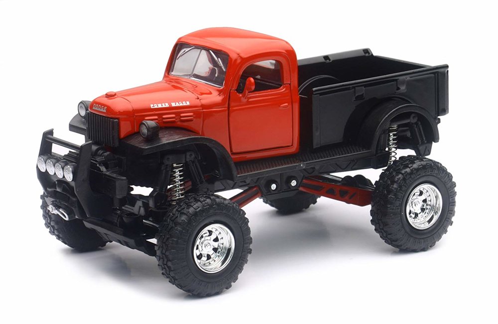

Raspy, have you considered a Power Wagon? It will do everything you want offroad, and more, it comes with the 6.4 Hemi, 33s,  skid plates, lockers, axle disconnect, solid front axle, and a winch, so you don’t have to worry about losing payload if you make some mods - the are already calculated into the load. It has a light payload for a 2500 since it has that long travel suspension. You would NOT need an Andersen for sure, but you might need airbags for levelling, depending on your load.
If I did not have such a love affair going on with my Land Cruiser, I would be looking at a leftover 2018, they are heavily discounted by some dealers like the one in west Boise ID..... they have THREE beautiful limited edition Mojave Sand PWs for at least $11,500 off. I love that color, it’s perfect for an offroader.

I’ve been looking at the 1500 Rebel and 2500 Power Wagon and am leaning to the 2500 6.4 with the adjustable air suspension.  The new model does ride nice and has a nice interior.  The graphics on the bed would have to come off.  Mike
Raspy, have you considered a Power Wagon? It will do everything you want offroad, and more, it comes with the 6.4 Hemi, 33s, skid plates, lockers, axle disconnect, solid front axle, and a winch, so you don’t have to worry about losing payload if you make some mods – the are already calculated into the load. It has a light payload for a 2500 since it has that long travel suspension. You would NOT need an Andersen for sure, but you might need airbags for levelling, depending on your load.
If I did not have such a love affair going on with my Land Cruiser, I would be looking at a leftover 2018, they are heavily discounted by some dealers like the one in west Boise ID….. they have THREE beautiful limited edition Mojave Sand PWs for at least $11,500 off. I love that color, it’s perfect for an offroader.

Yes, that Power Wagon is an awesome truck.
The main reason I don't want one is the 6.4 heavy duty gas engine.  It's an extreme gas hog in my estimation and I think it would be hard to live with.  The Rebel is bad enough in that regard.
But the Power wagon is cool.  I've been a fan of all of them since I was a kid and have had two of earlier generations.   The new ones are great, except for the mileage.

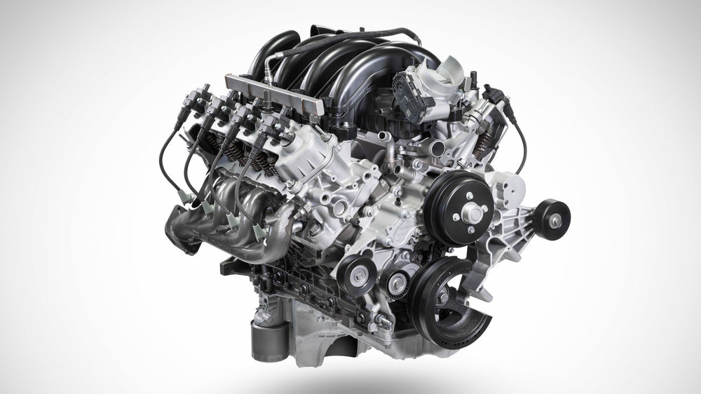

Aaaaaand Ford’s new 7.3 liter gas V8 is tuned for fuel economy and will have beaucoup torque. And the water pump is right on top of the timing case. It appears to be a very simple engine to maintain. It will only be offered in the Super Dutys.
Talk about choices.....
