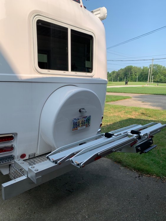

I forgot to take photos with the bikes on the rack. Here it is empty. The bikes seemed very solid watching on the rear view camera.

Steve, any of the racks that clamp the tires, like 1-Up and Kuat, have a deadly flaw, an Achilles heel (other than the fender clearance issue). If a tire goes flat, the bike will start to flop around. The larger the tire, the more it will loosen, for example fat tire bike vs road bike…. At the very least you should strap the two bikes to each other so that they can provide mutual support. For a single bike that is not an option.You need some sort of secondary straps.

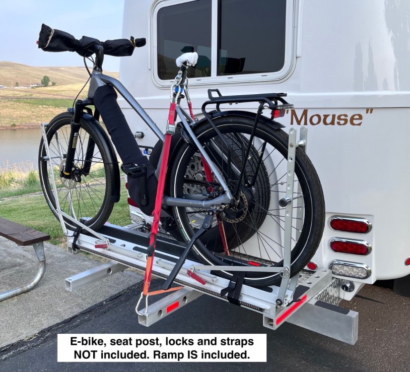

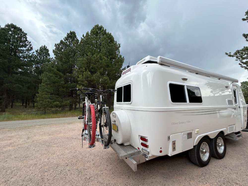

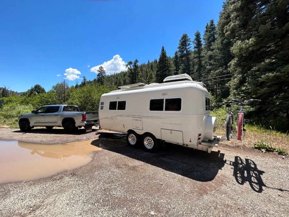

Here's a couple shots with bikes aboard.  The second pic shows the moment arm from the OTT 2" receiver to the aft-most rail.
On our rig, the moment arm of the bike rack is 24 1/4" inches from the OTT receiver, FYI.
Just our $0.02.

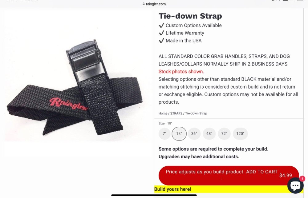

Forgot, using nylon straps to secure all wheels to the trays will stiffen everything up. And if one bike should come fully loose, the straps will retain it. I like these a lot, like all the Raingler products, the quality and design are well above the average Amazon product. I use the 18” version with a double wrap.
@John E Davies Thanks for the input. I’ve had Raingler ceiling nets in my Outback and 4Runner, so I’m familiar with the excellent quality. (KAON shelf in the LC.) On the bike rack I’m using four heavy duty Wrap-It brand straps around the rack and wheels. Plus four of 1UP’s skewer style locks through the wheels. So as long as the rack stays attached to the trailer, the bikes will be attached as well.

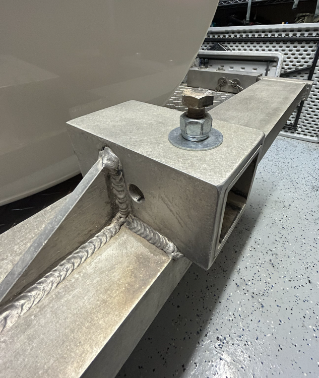

If there’s any weak link in the system, I think it is where the optional rack is inserted into the two square tubes bolted to the frame. Oliver has to machine these tubes to get them to fit inside the fixed tubes, possibly creating a stress riser. I’ll keep a close watch on this (as well as the whole shebang) and replace with steel if needed.

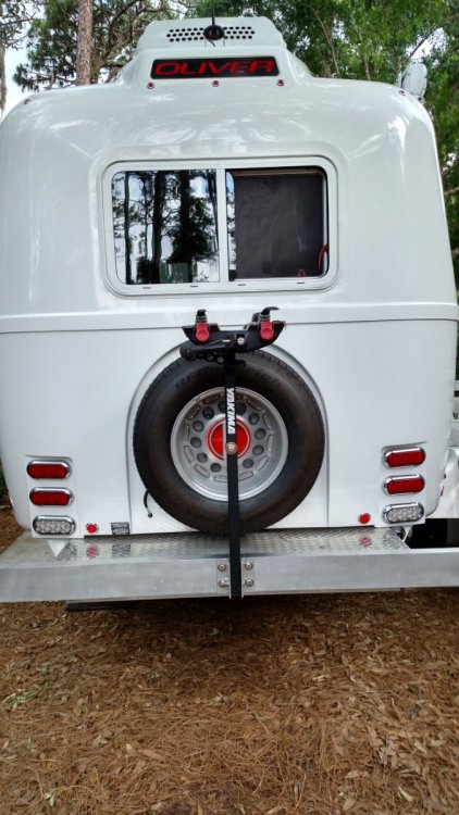

Thinking outside of the box, why not take advantage of the spare tire assembly.  If I recall there is a massive bolt that holds the rim in place.  That would make an elevated starting point for securing an upper structurall bike support.  Make it a "Z" shape and get an even higher up safety point.  Fix it to the bumper area and also at the spare tire mount.  Extend it up and then out.
Sorry for the crude crayola drawing, but best I can do on the road.
GJ

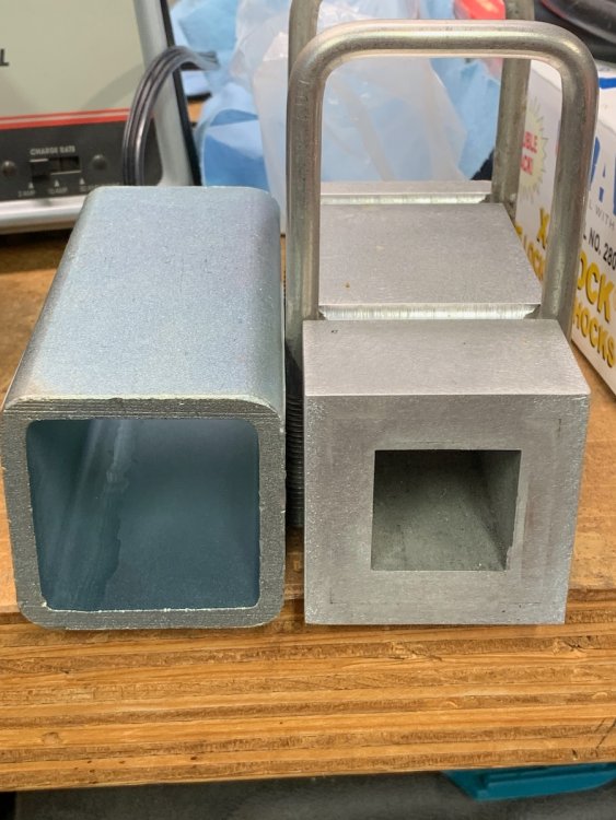

Concur.  The last thing we need is for those machined-to-fit square tubes to snap and fail!  Has anyone out there heard of this failure happening?

@Geronimo John Even simpler would be to take a ratchet strap from the spare tire ring nut around the outermost point on the deployed rack. Then take up all the slack in the system. This would facilitate folding the rack up without having to remove the extra support. Neither of our bikes have top tubes, so your design would have to go around the seat post if I went with something similar. Cool idea!

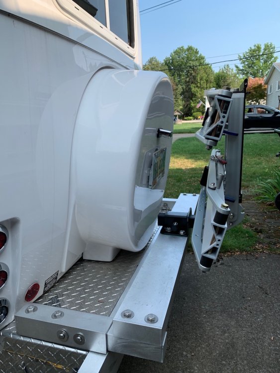

My license plate relocation kit arrived early, and I just installed it. I could remove the flip-down license bracket from the spare tire cover for even easier access.
BTW, the relocation kit is pretty slick, working in the up or down position, and works even with the EZ Pull handle. Now to rig up a 4-pin harness on the trailer to use the included lights.

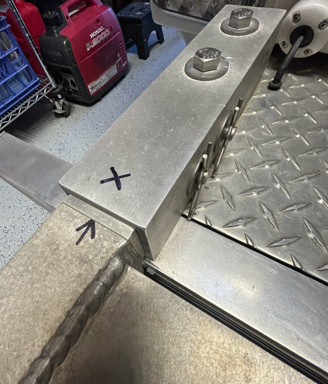

FOLLOW-UP:
Background/problem:  As described in an earlier post, we experienced, what looked like an abnormal  fore/aft & up/down (not rocking or rotating left/right) movement of the bikes during our trip last weekend.  The handlebars appeared as if they would move 1 1/2" - 2" when driving over a bumpy portion of road surface as observed with the rear-view camera.
Testing rack on TV:  Moved our bike rack from the OTT and mounted it on the Tundra and drove around the neighborhood yesterday afternoon.  As suspected, there was no "flopping around" and no fore/aft/up/down going on back there; both bikes were rock-solid throughout various stretches of smooth, uneven, bumpy, and "gravelly" secondary roads.  That's indicating to us there's something going on with the optional accessory receiver assembly and its attachment points.
Contacted OTT:  After a call to Mike at the Factory Service Department, we learned that there hasn't been any reports of problems with the OTT 2" or 1 1/4" accessory receiver, nor reports of "loose/floppy" bikes or cargo trays while towing; especially with the 47# Super Duty Double 1Up rack.  This confirms @Steve Morris's results after his search for OTT receiver failures.  Well, at least we know there's no known/reported failures.

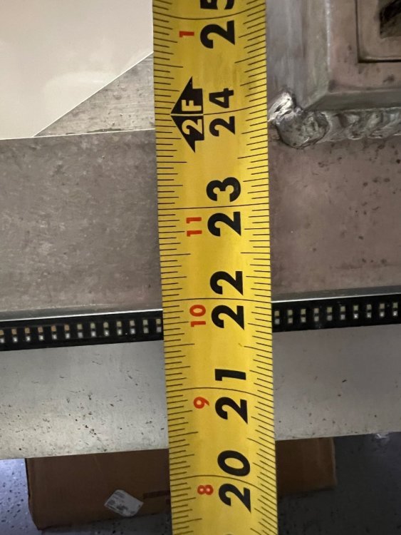

Possible Culprit:  We went back to the "Hangar" and measured the height above the floor of the top of the accessory hitch receiver cross member at just under 23 7/8".
Then after applying an upward force and "lifting" the cross member, we discovered it would rotate up slightly, about 3/16".
The "inserts", as Steve Morris mentioned, are machined down to fit into their respective female square tubing members on either side.  It may be that the factory cut too much material away on our assembly, it's suggested that those who have this option on their OTT check for how much "play" is present.
FYI, the machining cut on the male square tubing can be seen in the pic below where the Sharpie arrow's pointing (BTW: we never noticed this until after reading @Steve Morris's post):
527248050_Screenshot2023-07-27at06_50_23.thumb.png.2fb68b03a7efadc388a2169094756bd2.png
Perhaps the OTT factory designed these tolerances to make it easier to slide the accessory receiver assembly into the square tubing (?).  In any case, it's suspected that the play in this optional accessory may be different from hull to hull.  Especially, if over time, the holes for the 4 locking pins become wallowed-out.
Clearly, even after securing the assembly by inserting the 2 pins on either side does not stop the up/down movement.  The 3/16" of up/down play translates/amplifies to the 1 1/2" - 2" of movement at the handlebars that we observed last weekend.
In the interim, this 3/16" up/down "play" in the mounting design can be eliminated with tie-down straps as @John E Davies describes above.  Another plan is to drill/tap threads on each of the left/right square receiver tubes and use a bolt & locknut to tighten down the slack (please refer to where the "X" is located in the above pic).  This is the same approach the factory designed to remove play on carrying devices connected to the accessory receiver hitch:
The massive bolt is actually a piece of 5/8" all thread.  Been there done that!  It was my first attempt using a bike rack I already had.  It worked until I needed the sewer hose or the spare tire.  Then it required removal, so I moved onto 2 trays mounted on the front cargo carrier which created clearance problems with sharp turns.  I finally found a used Let's Go Aero Jack-It made for Lippert and mounted it in the front cargo carrier and that’s what I have used for several years.

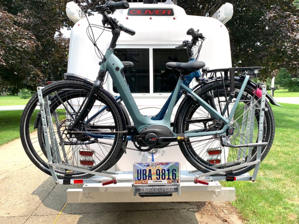

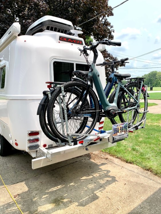

Loaded up and ready to go!
Steve - Northern Ohio, USA
Facebook - Instagram
@Steve Morris: Steve, nice looking set-up for the bikes, brother!  Really like the license plate mount and the hard point tie-down through the spare tire cover...  Great idea.
Our's is slightly different, but what we found very helpful during our road trip this week (in reducing the jostling), was adding 2 tie-down straps at both ends of the top tubes and the other ends (left and right) back down to the ends of the square tubing.
No issues... Rock-Solid!
