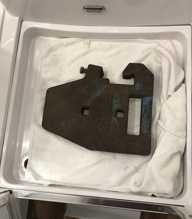

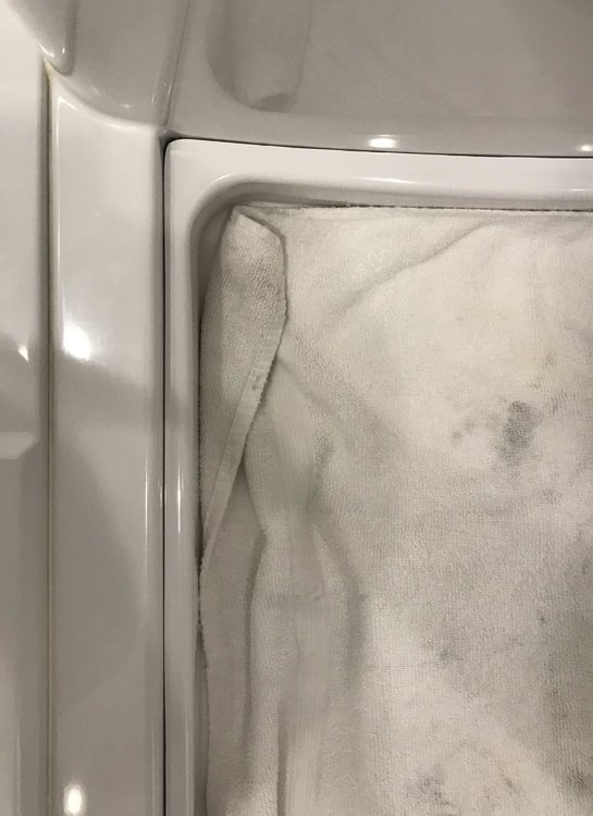

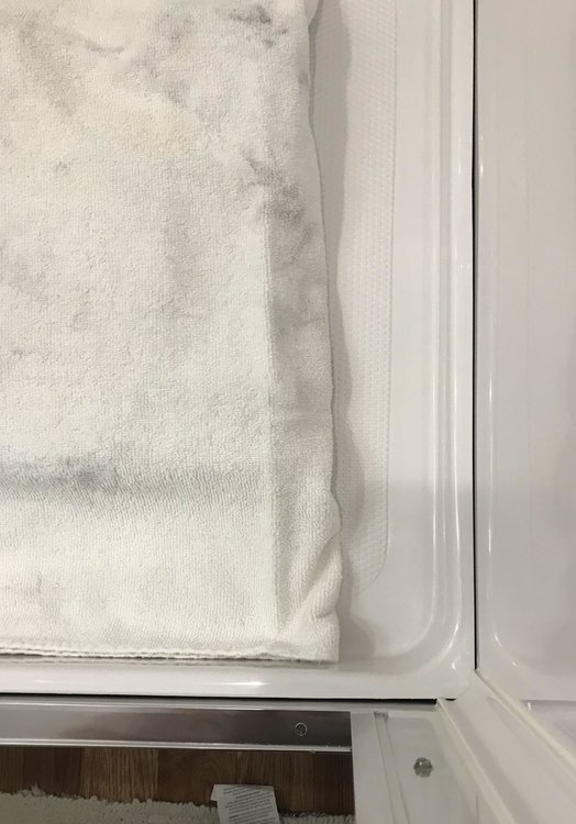

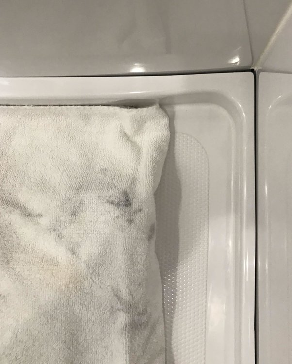

Townesw Posted October 11, 2019 Posted October 11, 2019 (edited) I have removed all of the sealant around my shower pan and resealed it without having to completely remove the pan. After removing all of the sealant I placed a tractor front end weight in the shower pan to pre-load it before resealing it. This pulled the edges away from the wall to allow more caulk into the gap. The caulk applied at the factory was smoothed too thin and the flexing of the shower pan caused the gap to open between the shower wall and pan and allowed water to leak down the wall between the shower and closet. I had water under the mat in the closet. After my repair I have not had any more water in the closet. I realize your problem is a squeaky shower pan instead of a leak but I believe you will have to do as I have done to fix your problem. (continued) Edited January 30, 2020 by Townesw 1 2 Bill and Martha 2018 LEII Hull 313 Original owners 3/14/2018 2019 Chevrolet 2500HD Duramax

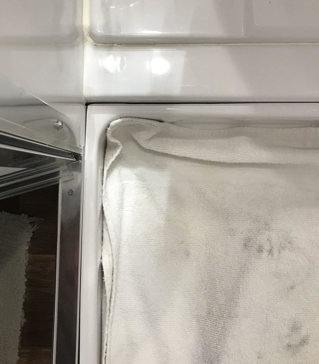

Townesw Posted October 11, 2019 Posted October 11, 2019 (edited) Photos showing caulk removed. Note that the tractor weight is in place when these pictures were made. The weight has a towel under it and is covered with a towel. Tractor weight in shower floor. This weight is probably 100 lbs. (continued) Edited January 30, 2020 by Townesw 3 1 Bill and Martha 2018 LEII Hull 313 Original owners 3/14/2018 2019 Chevrolet 2500HD Duramax
Townesw Posted October 11, 2019 Posted October 11, 2019 (edited) Work slowly and use the plastic razor blades and other plastic tools to remove the old sealant. I ordered 1 can of the ASI 0240 was very impressed with the ASI 0240 cleaner/remover. I ordered 2 tubes of the ASI 335. You’ll only need a small amount but get 2 tubes in case one is bad. Remove all of the old caulk using whatever combination of plastic tools work. I didn’t spray the ASI 0240 directly on the surfaces but instead sprayed it on a rag and wiped it on the sealant to be removed. I used rubbing alcohol very sparingly for the final wipe down prior to applying the ASI 335. Apply the sealant by pushing it ahead of the nozzle and force it into the gap. Quickly smooth it with your finger but do not get it too thin. The folks at the factory remove too much of the sealant and it only “bridges” the gap instead of filling the gap and leaving a bead or fillet to provide a proper seal. The thin bridge will not properly seal the shower wall/pan gap. I can not stress this enough. When you step on the pan the bottom flexes down and causes the edges to pull inward slightly. By placing weight in the pan prior to resealing you open that gap up slightly to hopefully allow more sealant into the gap. Use at least 100 lbs. More would be better. Let the sealant cure for a couple of days before removing the pre-load weight. Edited January 30, 2020 by Townesw 1 Bill and Martha 2018 LEII Hull 313 Original owners 3/14/2018 2019 Chevrolet 2500HD Duramax

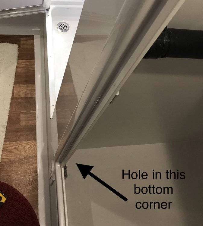

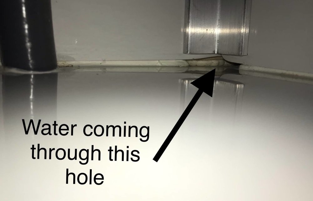

Townesw Posted October 13, 2019 Posted October 13, 2019 Those of you who have shower pans that squeak and flex, check under the black mat in your closet and see if you have or have had water there. I found water under ours and traced it to a crack in the caulk between the shower pan and wall. The crack was not easily visible when no one was standing on the pan but when weight was applied to the pan the edges flexed in slightly and the crack opened up. We keep the nose of our camper slightly elevated so the water ran back against the inside of the wall under the shower door then ran towards the closet and came through this hole in the bottom corner of the closet 1 Bill and Martha 2018 LEII Hull 313 Original owners 3/14/2018 2019 Chevrolet 2500HD Duramax
