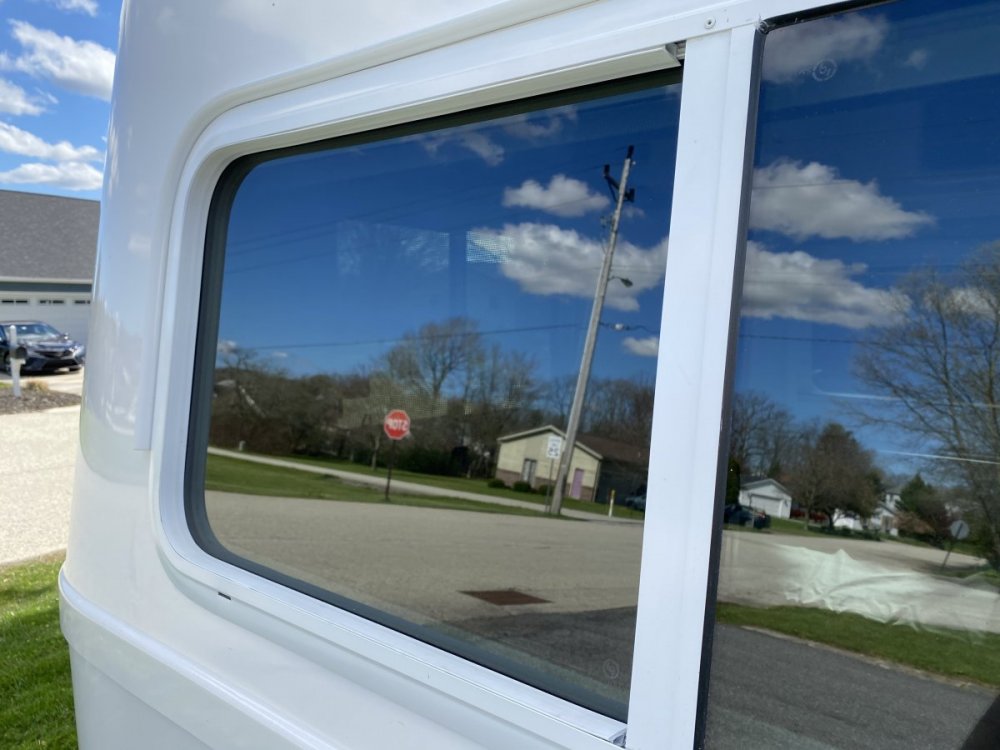

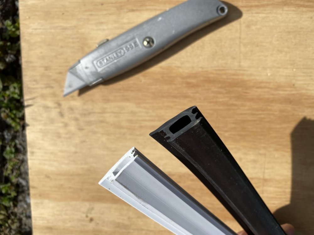

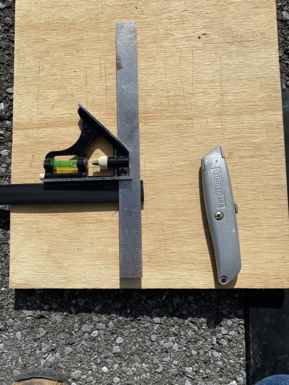

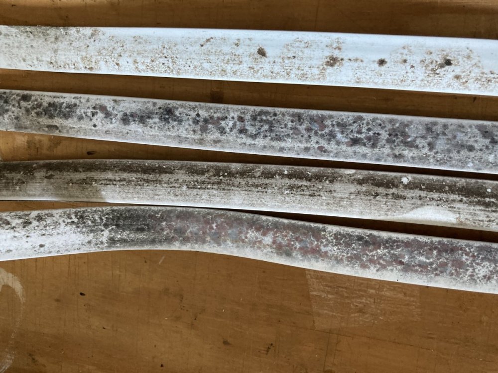

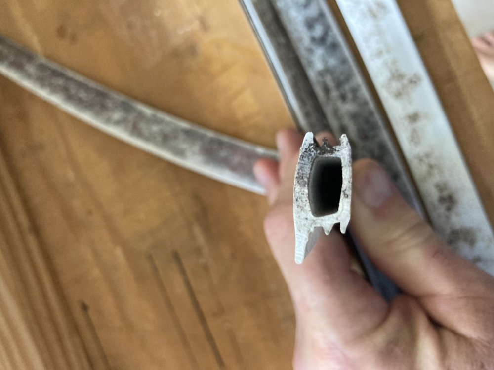

I just updated mine yesterday from white to black because the white ones were showing some mold/mildew stains and were getting hard to keep clean.  For all 3 large windows and 1 small bathroom window on my Elite II, I ordered 18' of the weather-stripping (H109-376 from Pelland Enterprises), just to make sure I had a little extra.  Before and after photos below.  It cuts easily with a new, sharp utility knife blade.  Use a carpenters square to get a nice perpendicular /square cut end.  And note that each window gasket on the 3 big windows is a slightly different length since the center vertical upright is a little different location on each window.  So use the original gasket from each window as your starting point.  I made mine a little long to start and then did a couple of install, check, remove, trim, re-install go-rounds to get mine right.   My original white gaskets were cut a little short and had a gap at the ends, as you can see in the picture of the original white gasket. There was a gap at top and bottom at each end because they were cut a bit short at the factory.spacer.png
