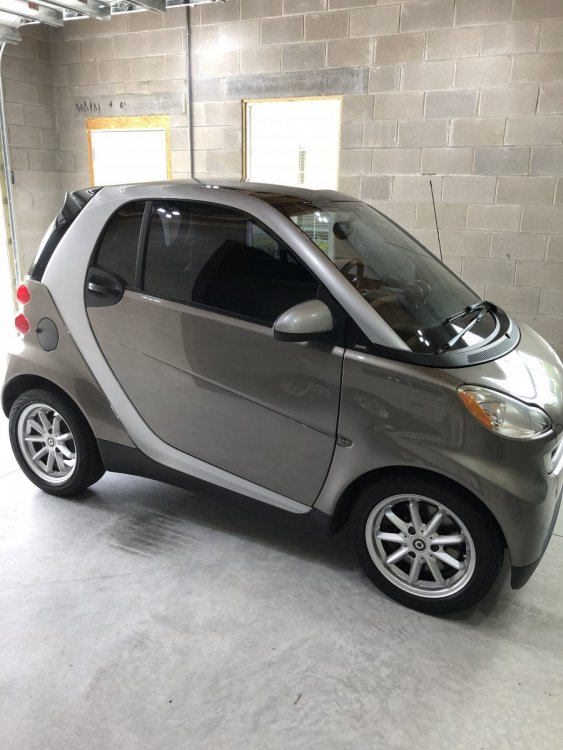

Moderator+ ScubaRx Posted August 6, 2020 Moderator+ Posted August 6, 2020 I'm really glad you asked... 1 2 Steve, Tali and our dog Rocky plus our beloved dogs Storm, Lucy, Maggie and Reacher (all waiting at the Rainbow Bridge) 2008 Legacy Elite I - Outlaw Oliver, Hull #026 | 2014 Legacy Elite II - Outlaw Oliver, Hull #050 | 2022 Silverado High Country 3500HD SRW Diesel 4x4

Landrover Posted August 6, 2020 Posted August 6, 2020 I’m happy with my tow vehicle what’s all the fuss about🤪 3 Grant 2022 GMC Denali 2500 HD 2019 Elite 11😎
