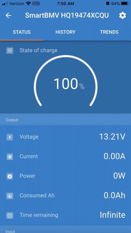

Install a Victron smart bus; it allows you to check on the battery condition from fairly far away via Blutooth. It provides great peace of mind and saves needless trips to go check in person. Here is “Mouse”, I checked the battery condition about a minute ago while lying on the living room sofa 50 feet away. Once I checked and it was down 96%, alarmed, I went out to see why and I found out that I had accidentally turned off the converter breaker instead of the one for the water heater.

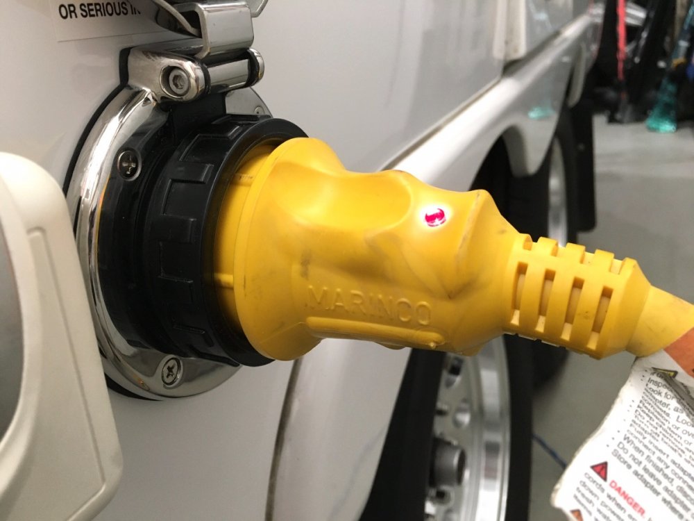

FYI, be aware of poor quality electrical adapters, especially ones with weird Chinese names. They are made of inferior materials, small gauge wires and soft bendy pins, and they do fail. Hopefully when they fail, it won’t cause a fire. Research carefully and do not buy the cheapest one there. You don’t have to buy a Marinco adapter (“yacht grade”, mega $$$$$) but do invest in a higher quality part.
I bought this adapter ....  NUSET RV Adapter  ..... and it failed in less than a year, one of the contacts inside the 30 amp housing bent and lost contact. I replaced it with a Marinco unit. I personally put safety over cost when it comes to electricity.... When holding the two adapters next to each other, the Marinco was noticeably better made, and was significantly heavier. It’s a high quality part.
NUSET adapter Davies Amazon Review 1 star
I do not recommend the type pictured above, it puts a whole lot of weight and stress on the 15 amp receptacle. Plus the rain cover may not close. Instead use an adapter with pigtail at the trailer connection, and run a heavy gauge (10AWG wires) 20 amp extension cord to the receptacle. That saves wear and tear on your expensive factory supplied shore power cable. If your trailer is exposed to lots of rain, you can make a water shield for the cord to adapter connection with some heat shrink tubing. Mine is connected indoors during storage, and when I camp it is rarely used.
