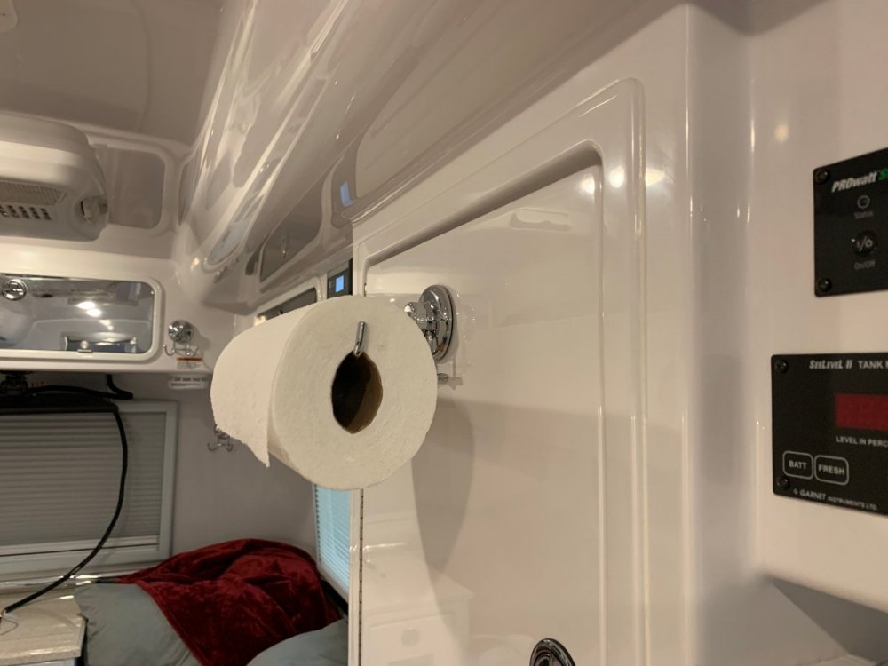

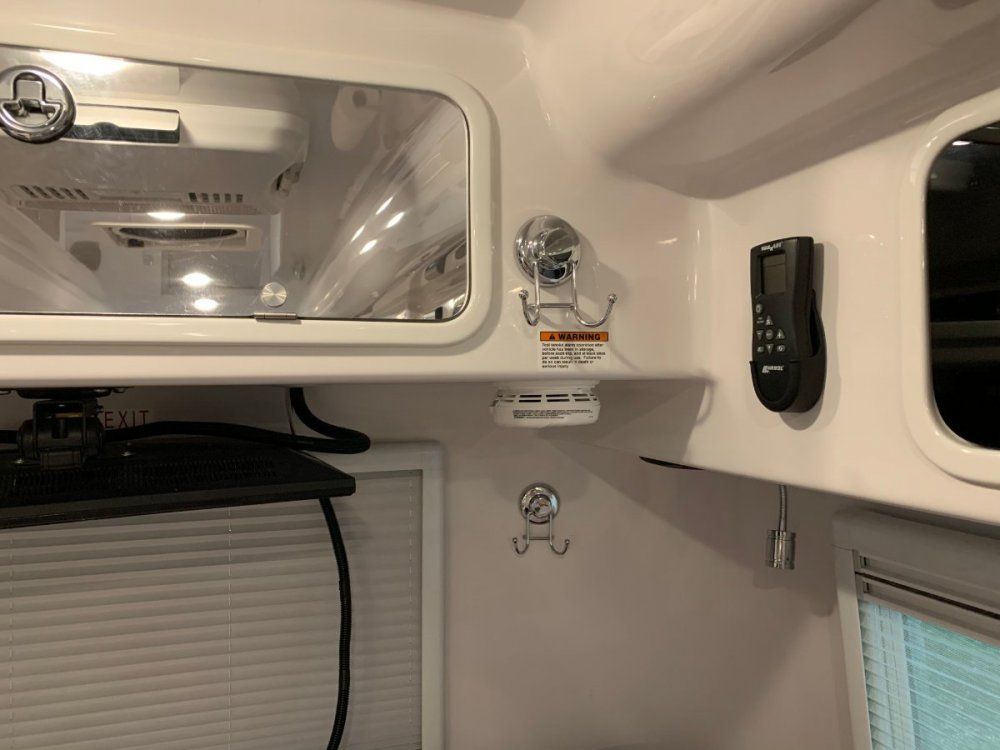

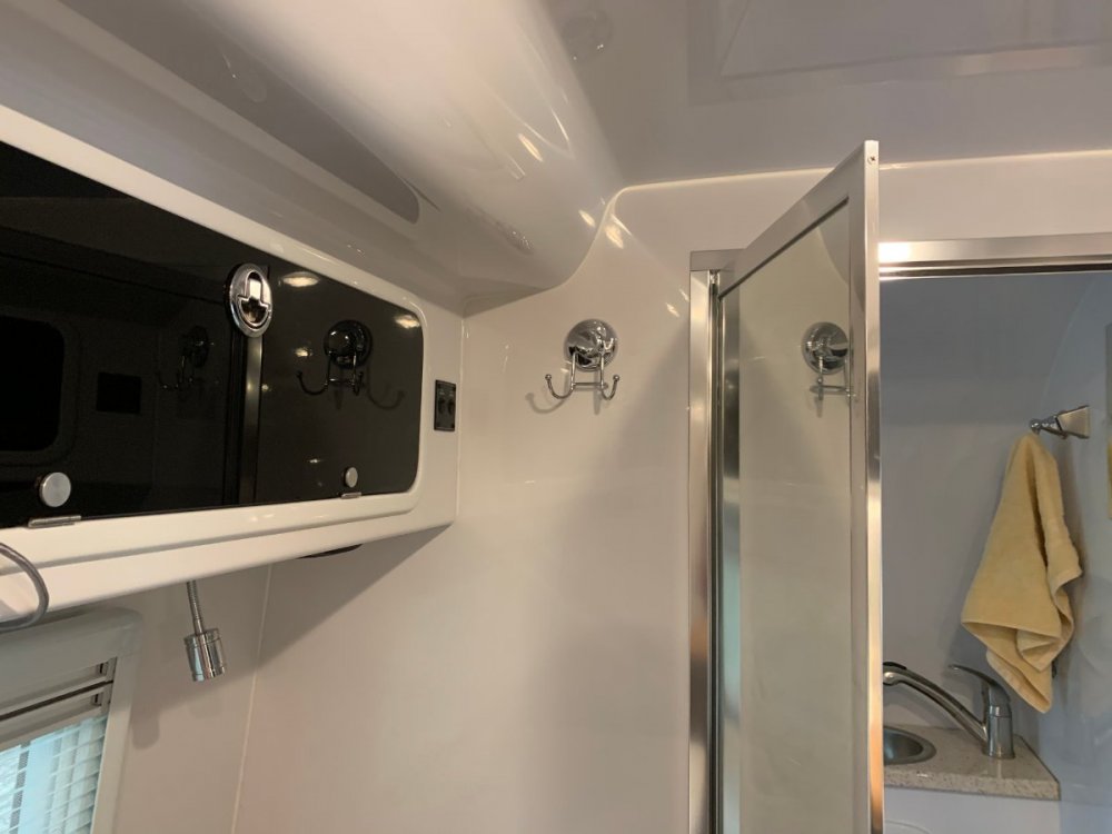

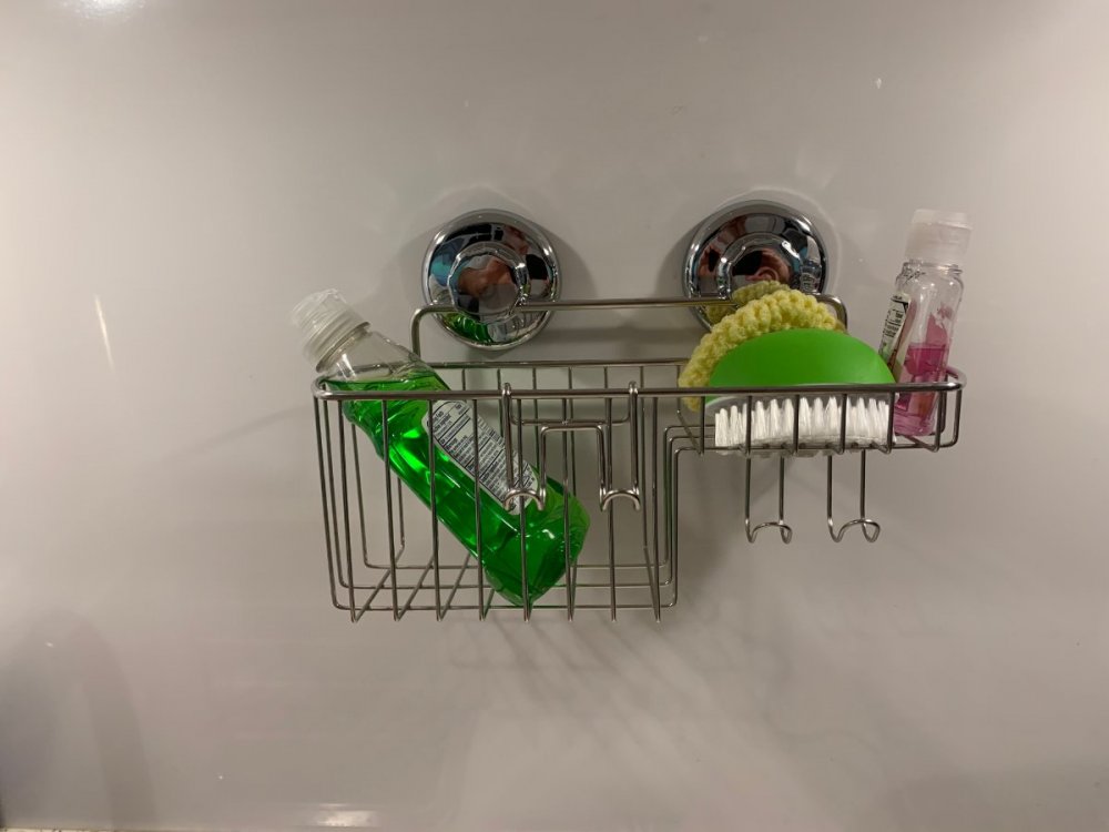

KWRJRPE Posted October 4, 2020 Share Posted October 4, 2020 I am a big fan of HASKO suction cup fasteners (hooks). We use them for paper towel holders, kitchen item storage, hanging clothes, and other uses. Adhere strongly to Oliver fiberglass and can easily be moved around as needed. No glue mess. No holes. A simple suction cup attaches to wall. d as needs change. Can get them from Amazon. 2 3 KWR 2019 Oliver Legacy Elite II, Hull#444 2019 GMC Sierra 2500HD Crew Cab, 4WD, Denali, Duramax 6.6L Turbo Diesel V8 Engine with Allison 6-speed transmission Link to comment Share on other sites More sharing options...
Jim_Oker Posted October 4, 2020 Author Share Posted October 4, 2020 14 minutes ago, KWRJRPE said: I am a big fan of HASKO suction cup fasteners (hooks). We use them for paper towel holders, kitchen item storage, hanging clothes, and other uses. Adhere strongly to Oliver fiberglass and can easily be moved around as needed. No glue mess. No holes. A simple suction cup attaches to wall. Thanks - those are an interesting option I hadn't seen mentioned much across threads here. Do you leave them stuck on while traveling, and if so will they even tend to stay put on bumpy dirt roads and such? Jim and Yanna, Woodinville WA 2004 Ford E250 camper conversion Oliver Elite II hull #709 Link to comment Share on other sites More sharing options...
KWRJRPE Posted October 4, 2020 Share Posted October 4, 2020 We always leave them attached while traveling but sometimes (when we remember) remove weight (such as paper towels, kitchen items, clothes, towels) while traveling. Never had one fall. Turning the dial clockwise presses the suction cup tighter to the wall. These work remarkably well. Check them out on Amazon or on the HASKO website for different types, uses, and designs. They have types for organizing bath/shower items that look interesting (we have not tried yet) KWR 2019 Oliver Legacy Elite II, Hull#444 2019 GMC Sierra 2500HD Crew Cab, 4WD, Denali, Duramax 6.6L Turbo Diesel V8 Engine with Allison 6-speed transmission Link to comment Share on other sites More sharing options...

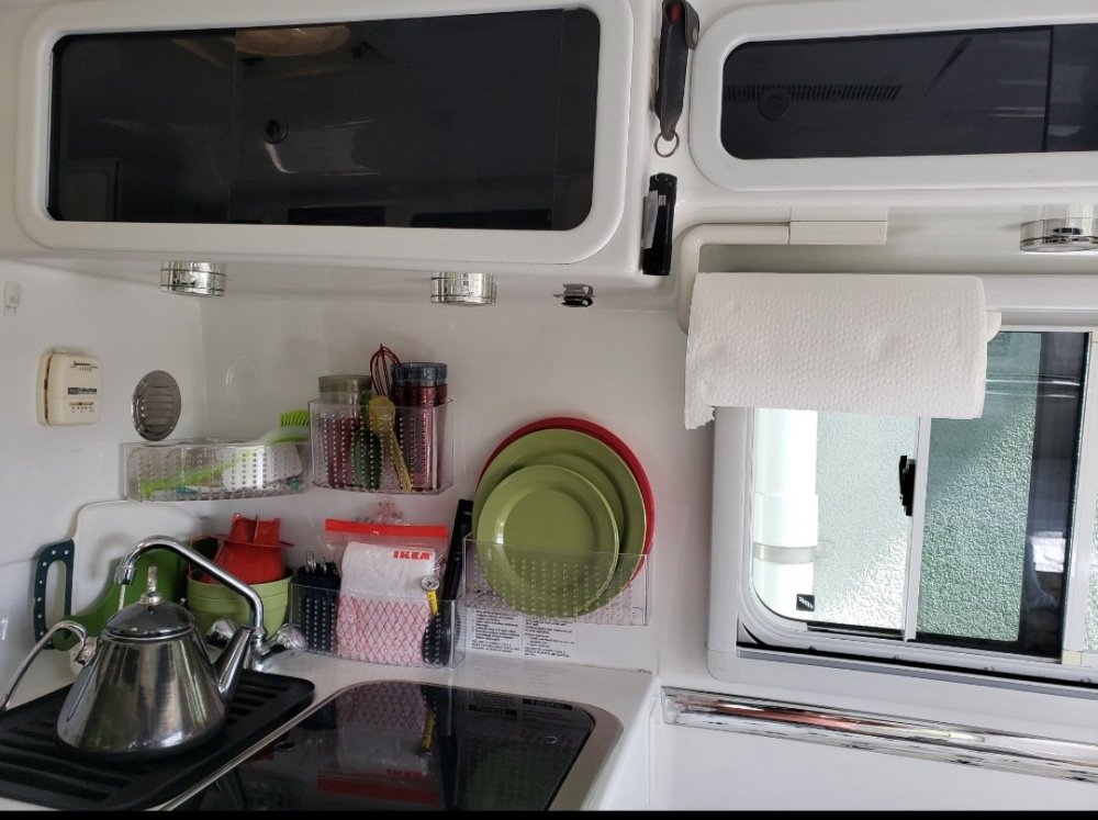

Moderators SeaDawg Posted October 4, 2020 Moderators Share Posted October 4, 2020 We attached our paper towel holder first with double-sided tape to be sure we liked the placement. About a year later, Paul fastened it with small bolts through the underside of the cabinet. We use industrial velcro for a lot of quick access items. Flashlights, remote controls, etc. Rough face on the trailer, soft on the item. The clear bins, sold for bathroom storage, have been in use for over twelve years. We leave them up when we travel. They're fastened with suction cups. These little bins have given me a lot of extra storage in the tiny kitchen. I have two suction cup towel rings, as well. Lots of command hooks spotted around the trailer. Command strips are great. Sherry 1 1 2008 Ram 1500 4 × 4 2008 Oliver Elite, Hull #12 Florida and Western North Carolina, or wherever the truck goes.... 400 watts solar. DC compressor fridge. No inverter. 2 x 105 ah agm batteries . Life is good. Link to comment Share on other sites More sharing options...

BlueHighways Posted December 4, 2020 Share Posted December 4, 2020 On 10/4/2020 at 11:43 AM, KWRJRPE said: I am a big fan of HASKO suction cup fasteners And now, I am also. These have performed flawlessly! Many thanks for bringing these to our attention. Note that these also come with VHB pads for a more permanent mount. David and Vicky | Burns, TN | 2020 LEII #686 (RIP!)| 2024 LEII #1550 | 2017 Ford F-250 4x4 6.2L Link to comment Share on other sites More sharing options...
