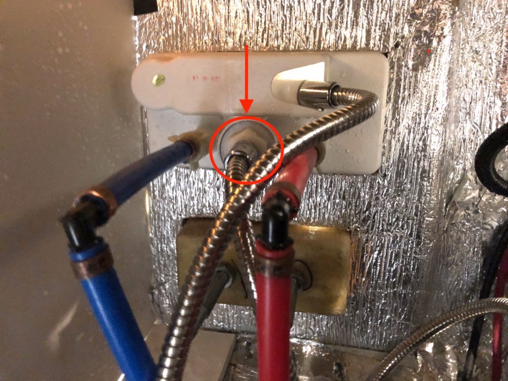

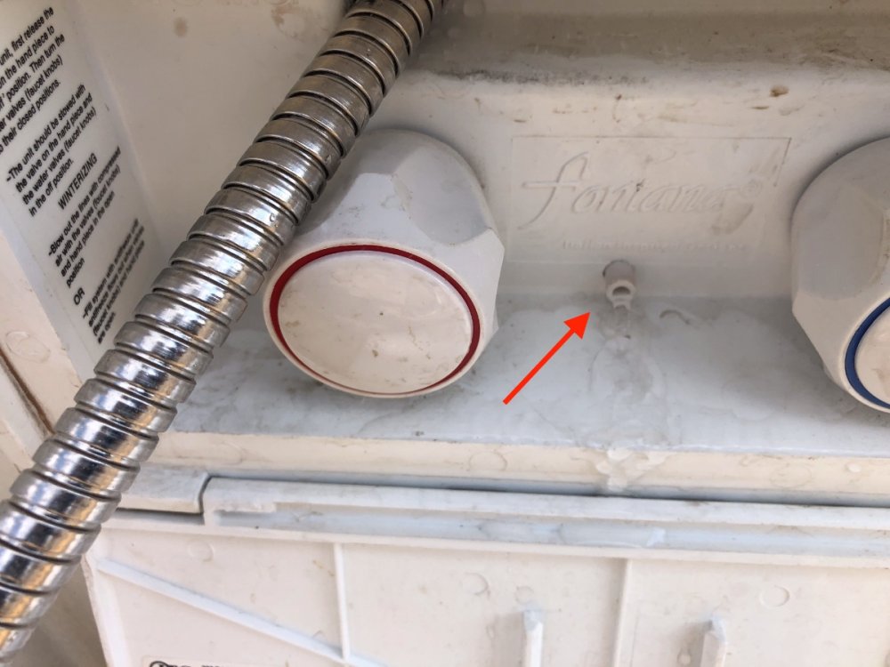

I had a similar problem this summer, with water leaking inside the hull from the outside shower unit. The insulation below was wet, and water was coming out of the seep holes.
When the shower valves were open, there was water coming out of the hole in the photo.
I found part numbers from the manufacturer’s web site, and then found parts on Amazon.
Replacement Vacuum Breaker. https://www.amazon.com/Fontana-97022-006-DB-Replacement-Vacuum-Breaker/dp/B015Q89WCM
Replacement Straight Nipple, Seal Collar and O-Rings. https://www.amazon.com/Fontana-97020-080-DB-Replacement-Straight-Nipple/dp/B015Q89WA4
Replacement Faucet Set. https://www.amazon.com/ITC-97022008-Exterior-Shower-Repair/dp/B007HRVOHW
They also had the entire unit for $99: https://www.amazon.com/Fontanna-97022-Compact-Exterior-Shower/dp/B019F81FQ0
I contacted Jason in Service, and he said that it would be much easier to replace the unit than to try to swap out parts in that hard-to-reach space. He also was able to send me a replacement unit for a price much cheaper than Amazon's.

We had the same leaking problem with our 2018 elite 2. Yes, the shower box is riveted, and I am not sure what the rivet grin length would be since the back side is not exposed inside the trailer.  But it is quite easy to replace the assembly within the box. It’s only $17 from ITC
The key for me was to finally discover that what looked to be one piece hot and cold knobs with a press-on spline fitting actually has a pop-off cap that exposes a screw hole.  The  “aha” that’s what those 2 small screws are for in the assembly package.  So
1. Remove the hot and cold knobs
2. Unscrew the outside retaining nuts just behind the the knobs
3. Go inside under the street-side forward hatch and unthread the hot and cold supply line and shower head flex line
4. Back out th’e entire assembly
installation of the new assembly is essentially reverse although I secured the outside retaining nuts prior to reconnecting the inside hoses.
Finally pressure check with a city water connection while operating.  I believe the tube vent acts primarily as a drain as when I turned the knob(s) off water poured out. Since the supply lines would be under pressure, I am not sure it serves much as an anti-siphon valve.   I think it just drains the mixing point downstream of the hot/cold valves.  In the photos the new assembly is shown near the bed hatch.

Ours might need the same repair. Took an outside shower yesterday and when the faucets were on, shower head switch off, there was a lot of water coming out along the pull out hose, spilling inside and out. It could be the hose is just loose but as you found the part the hose connects to is often cracked. I won't look under the bed until we're home next week.
Thank you for your post. Could you please supply a link for the shower assembly you purchased?
https://itcshopnow.com/products/exterior-shower-service-parts?utm_campaign=gs-2022-01-13&utm_source=google_shopping&utm_medium=smart_campaign&gad_source=1&gad_campaignid=22045544770&gbraid=0AAAAABSkRKi20j-rTiz8hmdaZS038ZTU5&gclid=CjwKCAjwyOzSBhBTEiwAmxvJ-mjQQfh7TiHQdheqRWzOQTgUzqKb5pQCZ6wZOJeMZbufqY5UqFFcpRoCVEQQAvD_BwE&variant=32367970320420
nasty looking link.  I had my wife operate the shower handle outside while I looked under the hatch to see where the lead was emanating.  I would tell it was from the center of the plastic assembly and not the hose.  You might want to have a few shop towels if you do this to wipe up inside. Our leak weeped over to the basement area under the rubber mat.

Our shower failed in the same way, the same plastic part shown above where the shower hose connects. It must be from pulling on the shower hose.
Drilling and replacing the rivets is the easy part. Do it, don't worry. They are aluminum rivets so each head drilled off in 5 seconds. If you go this route, you can loosen and reconnect each plumbing fitting sitting on a crate outdoors vs. kneeling on the cabin floor and reaching inside the cramped basement.
After the old shower assembly is removed, drill the rivets through. Then screw a sheet metal screw in and turn the rivet butt, push in, give it a tap if needed, and grab it from the backside.
Connect the water lines by holding pliers on the copper ring of the PEX so it doesn't twist. Make these good hand tight or gentle with a pliers. Then when the entire assembly is still hanging exterior to the Oliver as pictured, turn on the water pump, blead the hot and cold lines and test for leaks. Then push in place and rivet the four corners. I had rivets in my shop that were 3/16" and about 3/4" long. OEM might be 7/32" or 6mm but mine held it nicely in place.
UPS arrived with the part today and in an hour or so, job done and we have a brand new outdoor shower with leftover parts saved, like a new shower head replaced just last year. 😎
