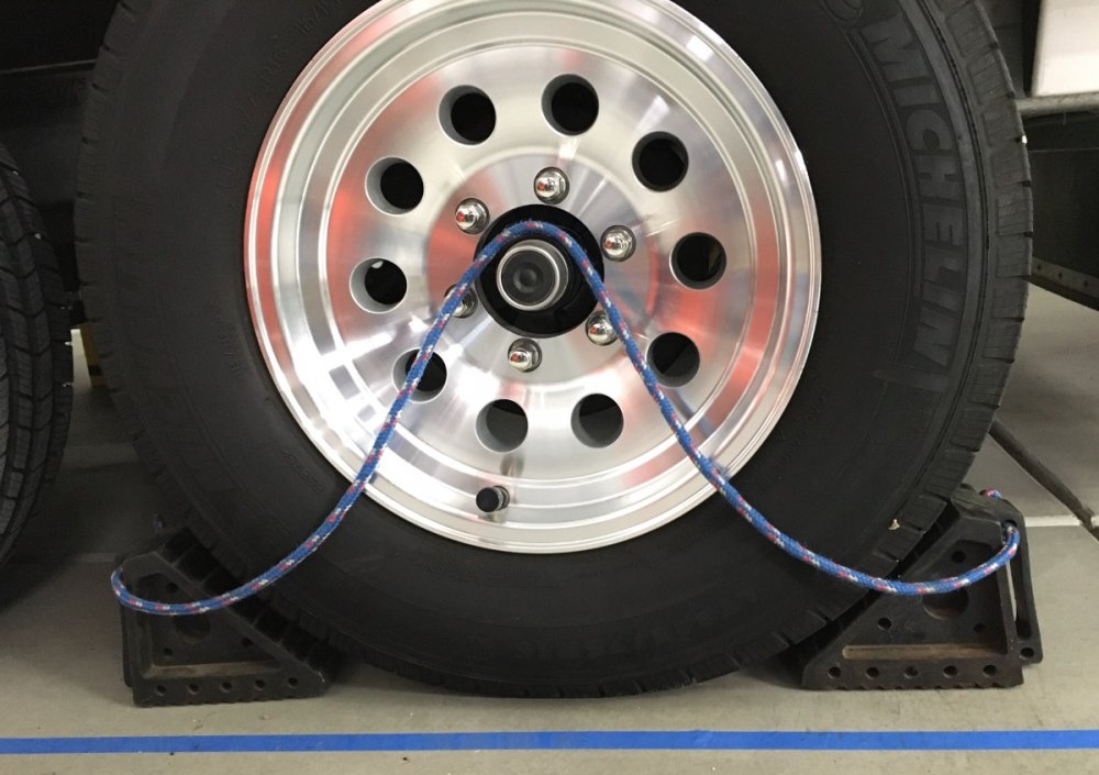

John E Davies Posted November 21, 2020 Posted November 21, 2020 (edited) The rubber chocks Topgun linked are very excellent but pretty expensive for four. I agree that you need heavy rubber ones, the Harbor Freight chocks are a great value ($32 for 4) and work super well. Buy four, attach a 48” length of bright rope to each pair, loop it over the hubcap, it makes it a lot easier to retrieve them, especially if they are wet/ dirty. Put the knobby side down, toward the pavement, and kick each one lightly against the tire with your shoe. After you are hitched, if one gets stuck under the tire do not despair, grab the one that did come free and whack the hell out of the stuck one with it, it will pop out in a couple of blows. Don’t kick it or you will hurt your toes and swear a bunch. ALWAYS double chock BOTH tires whenever the trailer is going to be disconnected. The brightly colored rope makes it less likely you will forget to remove them when you drive away. Buy these chocks HF will have a big Black Friday sale really soon, they might knock a couple of bucks off the price. John Davies Spokane WA Edited November 21, 2020 by John E Davies 3 SOLD 07/23 "Mouse": 2017 Legacy Elite II Two Beds, Hull Number 218, See my HOW TO threads: Tow Vehicle: 2013 Land Cruiser 200, 32” LT tires, airbags, Safari snorkel, Maggiolina Grand Tour 360 Carbon RTT.

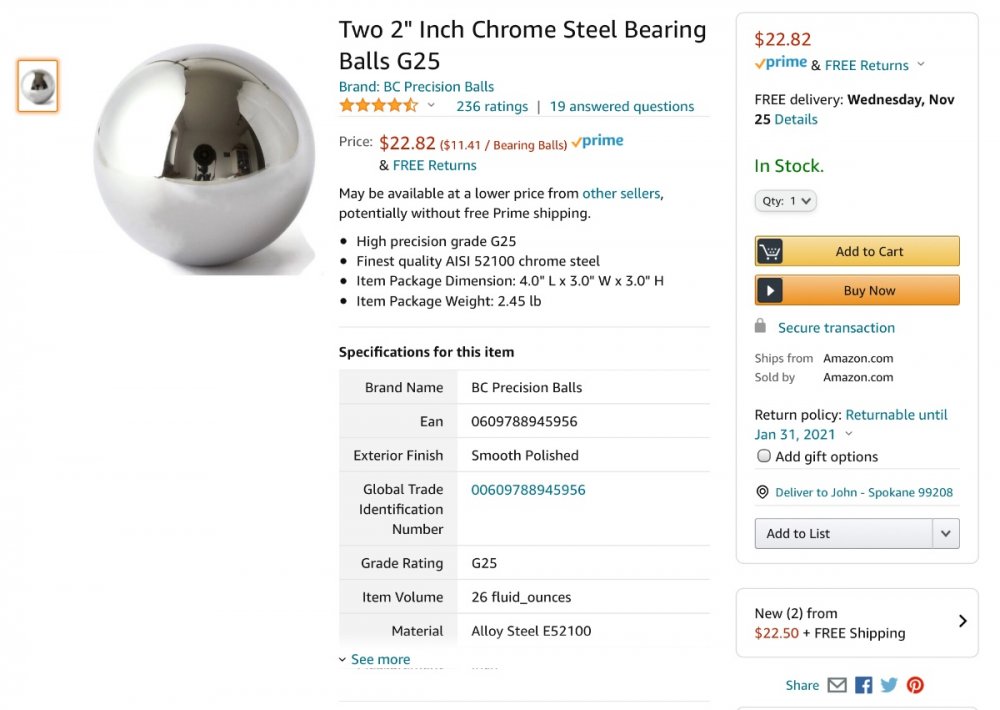

John E Davies Posted November 21, 2020 Posted November 21, 2020 (edited) Jim, The Collar works great, no worries at all there. The Discus lock is a kinda lame (easy to pick), there are much better choices in the $40+ range. I have this one..... Stanley padlock hardened One way to prevent somebody from dropping your locked coupler onto their 1 7/8” ball and driving away - insert a 2” ball bearing into the Bulldog coupler socket. https://www.amazon.com/Inch-Chrome-Steel-Bearing-Balls/dp/B007B2A3VQ Keep the extra one as a spare or give it to a kid as a toy. What a cool stocking stuffer! You could use an old 2” hitch ball if you have one, cut the shank off with a hacksaw. But the bearing is a more elegant solution. John Davies Spokane WA Edited November 21, 2020 by John E Davies 1 2 SOLD 07/23 "Mouse": 2017 Legacy Elite II Two Beds, Hull Number 218, See my HOW TO threads: Tow Vehicle: 2013 Land Cruiser 200, 32” LT tires, airbags, Safari snorkel, Maggiolina Grand Tour 360 Carbon RTT.

Moderators SeaDawg Posted November 21, 2020 Moderators Posted November 21, 2020 And, John's idea on the two inch ball bearing is genius. You can probably order one for less, or I'd go to my local bearing distributor. Probably less than $10. 1 2008 Ram 1500 4 × 4 2008 Oliver Elite, Hull #12 Florida and Western North Carolina, or wherever the truck goes.... 400 watts solar. DC compressor fridge. No inverter. 2 x 105 ah agm batteries . Life is good.
