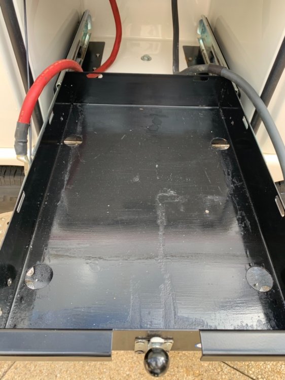

Mike, this picture concerns me.  I suspect the battery to inverter cables have been rubbing in the holes out of the battery box.  They should be inspected.  Also check the red 6 AWG wire I circled, it looks like it may be damaged.  It is either the Progressive Dynamics battery charger wire or the Blue Sky Charge Controller wire.
I know the Blue Sky CC is a MPPT type controller, but I don’t know which model it is and if it supports LiFePO4 batteries.  You should verify that before buying LiFePO4 batteries or plan on changing the CC.
The 6AWG wire was definitely damaged from being pinched behind the tray.  My grommet had worked itself lose but no damage to the cables.  There was a lot of dried battery acid under all four batteries and some wet acid under the back right battery that had the hole from the strap hook.  The old AGM batteries are sitting on the floor in my garage for now until I dispose of them.  2 Battle Born lithium’s will arrive on Tuesday and the upgraded PD on Monday.  Removed all cables except the two +/- cables from the battery box.  I still need to treat the bare metal on my battery tray.  Blue Sky controller is reprogrammed waiting for the new batteries.
My 4/0 negative battery cable insulation was rubbed flat where my cable gland had failed.  I tried to reuse the original gland, but every time I opened and closed the battery tray the gland nut would pop off.  So I ordered and install a new gland and the same thing happened again.  I finally came to the conclusion that the nylon threads were not holding up to the flex of the 4/0 cable.  So I ordered the one below.  And let me caution you, it takes three hands and persistence to replace those glands if needed.  If you do replace the gland, just remove the small glands since you have already removed the 6 AWG cables.  That will simplify the replacement.

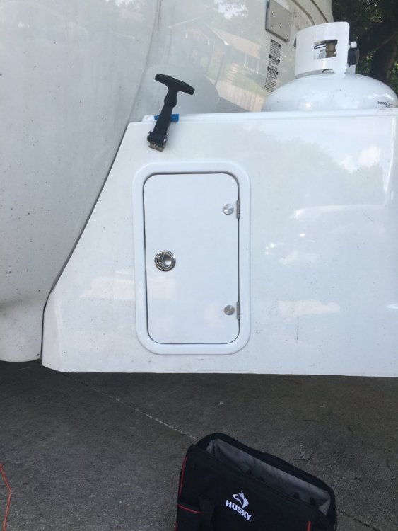

Mike, I recommend that you plug those vent holes I see peeking through the bottom or you battery tray. I can cut you some fiberglass plugs the right thickness to fit them if you like. Just drop them into the backside of the door and glue with some two-part epoxy. I also recommend insulating the inside of the door with some closed cell foam.  I bought one of these at Dicks Sporting Goods. They are exactly the right thickness to fit the inside of the battery hatch. There is enough to insulate the basement hatch also.  I used contact cement to attach. Just make yourself a pattern out of heavy construction paper or cardboard and cut to fit.
Steve, plugs would be great.  I don’t have any white fiberglass around and have been thinking about how to plug those holes.  I do have some of that foam rubber matting with the puzzle sides for joining to other mats that I was going to use to insulate.  It’s about 5/8” thick so would need to fit inside the weather stripping.  I might stop by Dicks this weekend.  I should insulate my basement door too!  Mike
I have plenty of genuine Oliver Fiberglass panel that is the perfect thickness that I cut from our propane cover during my mod to create storage behind the propane tanks.
If anyone else wants/needs a set let me know via PM.

I am trying to understand why you would feel the need to plug each door vent hole with an epoxied fiberglass plug..... instead of simply adding a disc of foam rubber with RTV sealer/ adhesive. Are you also removing the outer chrome grills and blending in the areas with white gel coat? If that is the case I would just order a replacement door without any holes. If you are leaving the grills in place, epoxy might make their future removal a lot harder.
A camp pad from Dick’s will work, but does anyone know its R value? A single layer of thin bubble foil insulation is R1. A 1” rigid (and fire retardant) foam board from the box store is R5. That is what I plan to use.
Comments?
Edited by John E Davies
The only reason to use Oliver fiberglass plugs is to color match.  You can see the color through the grill, for me it’s just aesthetics. Like I said, I was looking at other options but if some nice white fiberglass plugs can do the job, why not?  I’m not removing the grills and have no intention of replacing the door.  As far as insulation, I’m undecided.  I might use what I have on hand or get something different, just haven’t had time to look.  It’s been a busy few days getting to where I am now.  Mike

Received a new battery tray from Oliver. New tray is over 6 pounds heavier than original unit.
The battery straps connect in the same fashion on both trays.
New unit on right:
Old unit:
New unit:
Same footprint and bolt pattern on both units:
New unit top has larger/stronger bearing/slide assemblies:
Edited by rideandfly
Plan to sandwich 1/8" X 4" neoprene rubber between battery tray rails and fiberglass. Only using two 12V AGM type 27 batteries, so have plenty of room to place 1/8" X 4" UHMW plastic between batteries and tray to protect battery from metal hooks on straps. Secured 1/8 UHMW plastic on each side with one machine screw and tinnerman type nut that will not contact batteries.

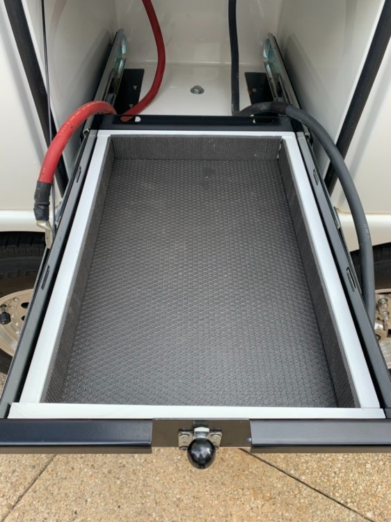

Finished up mounting the batteries this afternoon.   Couldn’t have done it without the help of fellow Ollie owner, Ken Cvacho, @mountainoliver.

Here’s the final installation.  Added a battery cut off switch on a spacer block I made out of PVC board.  Used some thin foam to cover the door and some thicker foam that fits inside the weatherstripping. Plugged the vent holes with fiberglass plugs from Scubarx.  Thanks to Ken Cvacho for the technical expertise and Steve Landrum for the plugs and advice.  It was an Oliver community effort.
