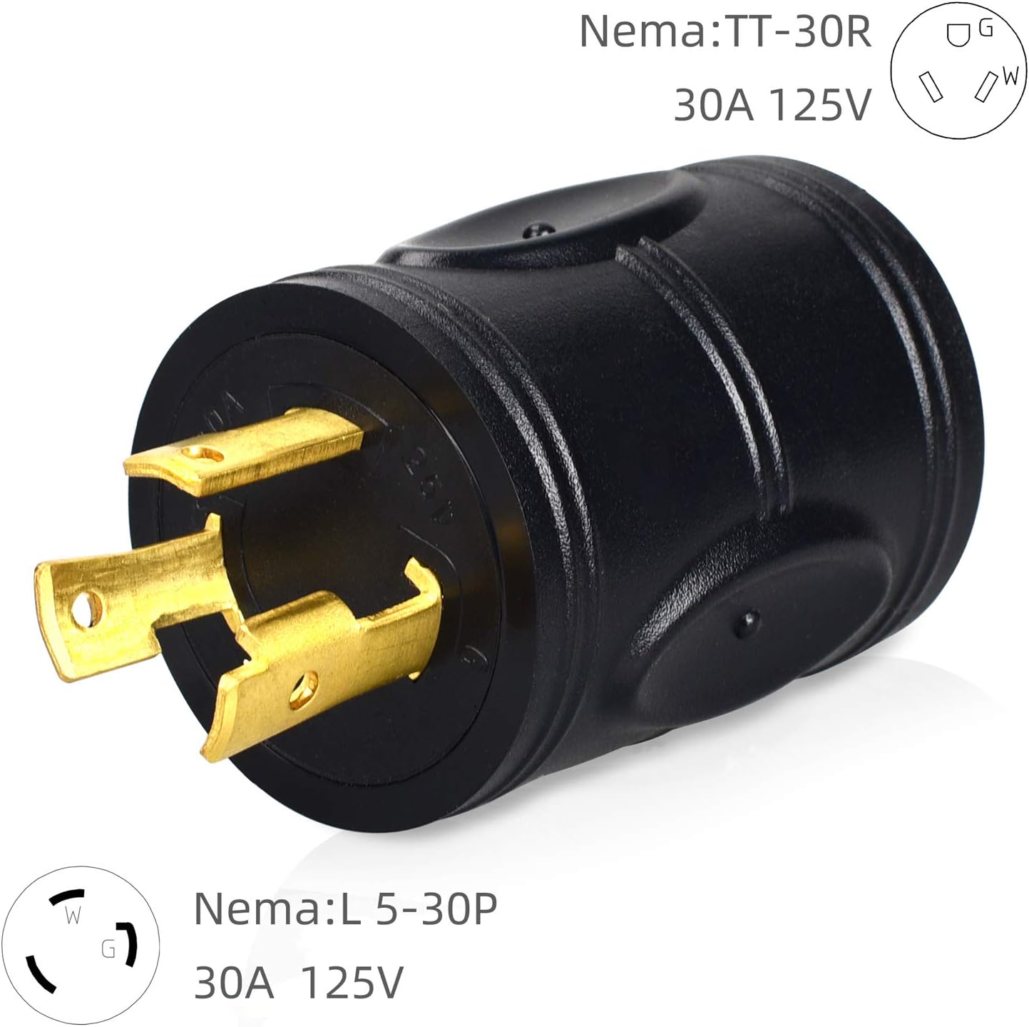

Ray and Susan Huff Posted January 18, 2021 Author Posted January 18, 2021 So, a question for those using a portable generator that doesn't have a 30 amp plug (with plug adapter): Aren't you only getting 20 amp service? Doesn't this limit the amount of power you can use while running on the generator? We will mostly be using our generator for charging batteries and off-grid use of high wattage appliances such as an 1800w toaster oven (that we use in lieu of deleted microwave) Ray and Susan Huff Elite II Twin "Pearl" - Hull#699; delivered December 7, 2020 2013 F350 6.7l diesel Super Duty 4x4 long bed crew cab 1UP-USA Heavy-duty bike rack 2017 Leisure Travel Van Unity Twin Bed (sold)
AndrewK Posted January 18, 2021 Posted January 18, 2021 54 minutes ago, Ray and Susan Huff said: So, a question for those using a portable generator that doesn't have a 30 amp plug (with plug adapter): Aren't you only getting 20 amp service? Doesn't this limit the amount of power you can use while running on the generator? We will mostly be using our generator for charging batteries and off-grid use of high wattage appliances such as an 1800w toaster oven (that we use in lieu of deleted microwave) 2,200 watt generators only output 18.3 amps at peak and 15 amps constant. Andrew 2 Andrew 2019 Legacy Elite II 2018 BMW x5 35d
Ray and Susan Huff Posted January 19, 2021 Author Posted January 19, 2021 4 hours ago, AndrewK said: 2,200 watt generators only output 18.3 amps at peak and 15 amps constant. Andrew So, the 30 amp plug is just a convenience? Ray and Susan Huff Elite II Twin "Pearl" - Hull#699; delivered December 7, 2020 2013 F350 6.7l diesel Super Duty 4x4 long bed crew cab 1UP-USA Heavy-duty bike rack 2017 Leisure Travel Van Unity Twin Bed (sold)
AndrewK Posted January 19, 2021 Posted January 19, 2021 40 minutes ago, Ray and Susan Huff said: So, the 30 amp plug is just a convenience? A 30 amp plug on a 2000 or 2200 watt generator would just be a convenience, if it were a 30 amp plug. As far as I have seen, that does not exist and still you would need to use an adapter. Andrew Andrew 2019 Legacy Elite II 2018 BMW x5 35d
mjrendon Posted January 19, 2021 Posted January 19, 2021 The Honda companion version would require an adaptor like this to work with your standard 30 amp cable.
Jim_Oker Posted January 19, 2021 Posted January 19, 2021 1 hour ago, Ray and Susan Huff said: So, the 30 amp plug is just a convenience? If I understand correctly, at least on the Honda e2200 there's only a 30 amp plug on the "companion" model, which you would want if you were looking to run two together to get 30 amps/3600 Watts of output. In which case said plug is a necessity. 2 Jim and Yanna, Woodinville WA 2004 Ford E250 camper conversion Oliver Elite II hull #709
Ray and Susan Huff Posted January 19, 2021 Author Posted January 19, 2021 21 minutes ago, Jim_Oker said: If I understand correctly, at least on the Honda e2200 there's only a 30 amp plug on the "companion" model, which you would want if you were looking to run two together to get 30 amps/3600 Watts of output. In which case said plug is a necessity. Now it's making sense. . . . . so, the Yamaha already has the 30amp plug, so is there even a companion Yamaha, or do you simply connect two of the same model? Is the "Companion model" just a Honda thing? 1 Ray and Susan Huff Elite II Twin "Pearl" - Hull#699; delivered December 7, 2020 2013 F350 6.7l diesel Super Duty 4x4 long bed crew cab 1UP-USA Heavy-duty bike rack 2017 Leisure Travel Van Unity Twin Bed (sold)
Ray and Susan Huff Posted January 19, 2021 Author Posted January 19, 2021 1 hour ago, AndrewK said: A 30 amp plug on a 2000 or 2200 watt generator would just be a convenience, if it were a 30 amp plug. As far as I have seen, that does not exist and still you would need to use an adapter. Andrew But the Yamaha 2200i has a plug configured for the RV 30amp cord, so an adapter isn't required. I think it is more likely capable of handling 30amps, but since the 2200w generator will only generate 15-18.something, it will only supply the actual output of the generator. If two 2200i generators are connected, it will then supply 30amps. Ray and Susan Huff Elite II Twin "Pearl" - Hull#699; delivered December 7, 2020 2013 F350 6.7l diesel Super Duty 4x4 long bed crew cab 1UP-USA Heavy-duty bike rack 2017 Leisure Travel Van Unity Twin Bed (sold)
Moderators SeaDawg Posted January 19, 2021 Moderators Posted January 19, 2021 (edited) From what I've seen, the 30 amp on the companion model is pretty much a Honda thing. You need two generators, of 2000 or 2200 watts, in parallel, with yamaha, honda, any brand to gain the full 30 amps. Watts ÷ volts = amps, forgetting resistance. That doesn't mean you can't run your ac with one yamaha. If you have the easy start,,as you do, you should be fine. I can't personally attest to that, as we don't have that genset, and run our ac only once a year, to test it, at home. Edited January 19, 2021 by SeaDawg 2008 Ram 1500 4 × 4 2008 Oliver Elite, Hull #12 Florida and Western North Carolina, or wherever the truck goes.... 400 watts solar. DC compressor fridge. No inverter. 2 x 105 ah agm batteries . Life is good.
