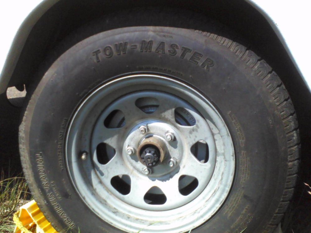

I had repacked the bearings on the RV below just prior to this trip of 5,000 miles.  I was headed east on I-70 just outside of Hays, KS and two young guys drove by telling me to pull over - the passenger side bearings had totally come apart and the whole thing was just about to catch fire.  The up side of this was that I got to spend the weekend in Hays and when I got home I immediately purchased a TPMS.  Between the tow and the replacing of the bearings it "only" cost me $650 and that was after AAA gave me $75 towards the tow.
(Note where the spindle is relative to the hub)

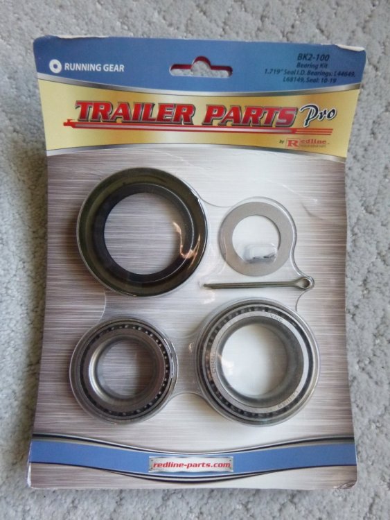

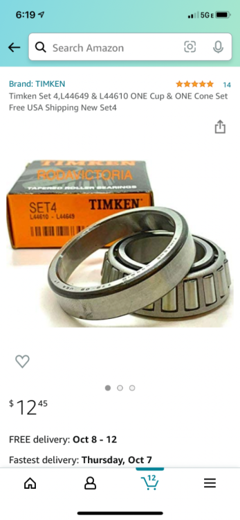

As an inexpensive experiment I purchased “Timken” Set4 & Set17 bearings, and the 473336 seal, all on Amazon.   They arrived today.  They certainly look like Timken bearings with nice packaging and even have the Timken microprinting hidden in the longitude and latitude lines on the globe logo. But the WBA bearing app scan of the bar codes on the bearing packaging says the bearings are likely counterfeit.  The seal checks out as ok.  The seal was stocked and shipped by Amazon.  The bearings were from a third party supplier.  I do have an authorized Timken dealer not far away, so I do plan to get actual Timken bearings to use, but it was a cheap experiment, lesson learned.  The two bearing sets were only about $25 total for both.  I’ve had a lot of experience with Chinese suppliers in my career, but I am still amazed at the effort they will put into counterfeiting a product.
I do not disagree that genuine Timken bearings are probably the best and when my original bearings have seen the end of their useful life I will replace them with Timkens.
However, shortly after I purchased my Ollie I wanted a "set" of all the parts that I would need in the event of bearing failure while I was out traveling.  In my experience, trouble always seems to happen when I'm out in the middle of nowhere!  And, even though the bearing parts for our Dexter axles are fairly "common" I wanted to make sure that I had the parts on hand in the event that whatever little town, gas station, repair shop, auto supply store, etc. were "sold out" or "never heard of those before".
Certainly the sets I bought are "Made in China" but to get me back on the road until I get home - I don't care.

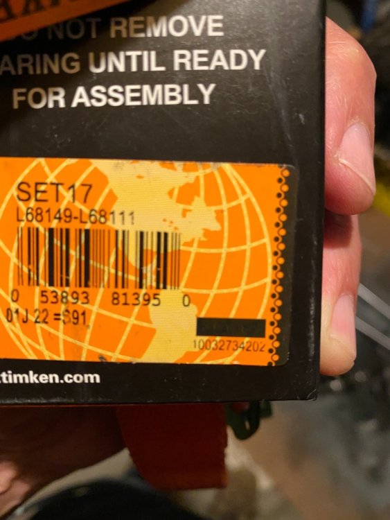

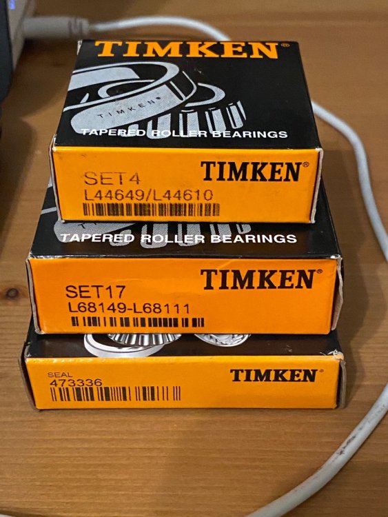

I purchased 8 Timken seals today in preparation for tomorrow's repack of my Timken bearings. To my disappointment I discovered after opening the boxes, these Timken seals are red, not orange and are now made in Mexico. Any one had any quality issues with the Mexican Timken seals?
FYI,  i just completed changing out the bearings and seals on my 2015 Oliver LE2.  These are the bearings used.
Timken Set 17. L68111 and L68149 for the inner race and bearing
Timken Set 4,  L44649 and L44610 for the outer race and bearing
Timken seal,  473336……or you can use a National seal.  They are the same
I elected to use the Timken wheel bearing grease.  Looks to be great quality and who knows better about the required grease for their bearings than the maker of the bearings.

I'm getting ready to attempt my bearing repack, shock replacement and lube of the EZ-Flex suspension on ILOVHER as soon as the weather gets reasonable here in the Northeast!   I'm lucky to be able to have my brother help me so I'm hopeful things will be straightforward.
I ordered the Timken bearings from Summit Racing as suggested here to the tune of $150..including the SET17 and SET4 bearings, 4 seals and Redline CV-2 grease but...

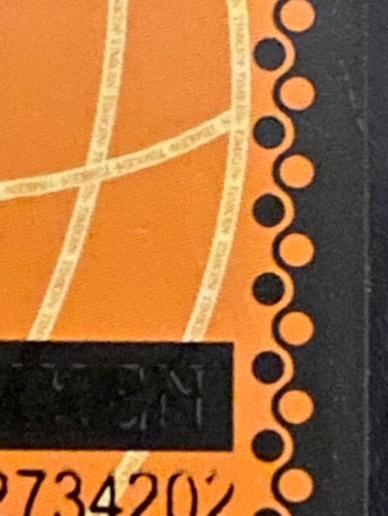

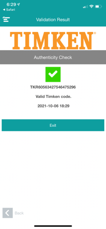

An FYI:

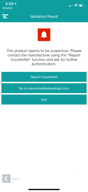

I used the WBA app to verify that the bearings aren't counterfeit and they are coming up 'suspicious.'   I filled out the information and we'll see where this goes.  I'm sort of miffed by it but I will wait to see what Timken says..the World Headquarters are only 20 minutes away from Summit.  You'd think they'd be legit.
Any tips or tricks for this newbie would be greatly appreciated.  I like to learn and am hoping things will go well with my brother's help.
2020 Toyota Tundra TRD Sport 5.7L V8
2017 Oliver Legacy Elite II  Hull #184 ~ "ILOVHER"
An FYI:

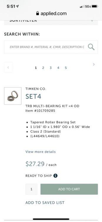

I bought my Timken bearings through an authorized Timken distributor listed on the Timken website.   And when I received them I confirmed with the WBA bearing app and they come up as good.  As an experiment though I did buy a “Timken” bearing on Amazon (at a ridiculously low price of like $12) just to see what counterfeit bearings are like.  A lot of fakes out there.  The Amazon ones did show as counterfeit (no surprise for $12 😂) when scanned with the WBA app.  Here’s a pic.   Counterfeit on the left, legitimate on the right.  The fakes are a pretty good looking copy, with most of the packaging details copied, but the counterfeit ones seem to always be missing the QR code on the box.
Here’s the authorized Timken distributor I bought the genuine bearings from.
www.applied.com
www.applied.com

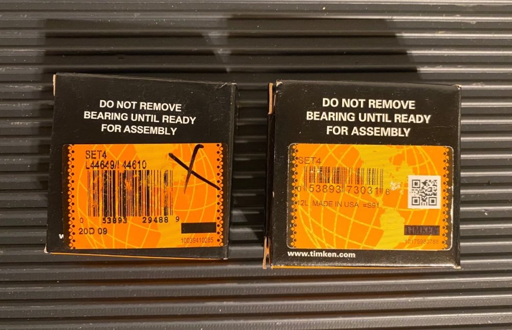

The bearings I received from Summit have the QR code as in the right photo and also have raised 'Timken' black print below it.  I scanned the bar code from the box on the WBA app.  Not sure what else I'm supposed to do besides wait for a reply from Timken as I don't know what 'suspicious' is supposed to mean.  The app is fairly basic and not really informative.    Summit Racing has been highly recommended by forum members here and is supposed to be an authorized distributor.  Just wanted to give others a heads up if these aren't authentic.
Yeah, I would expect that Summit would be legitimate as a Timken source since Summit is a big reputable auto parts distributor.  Maybe just a fluke with the WBA database not being updated recently with the latest Timken data.
