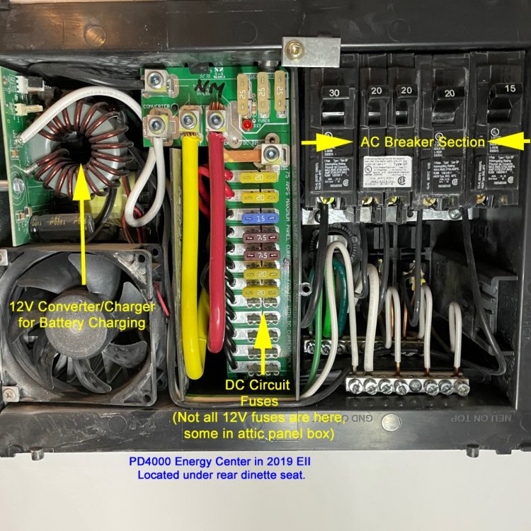

My current hull 505 (2019 EII): has a PC charge converter and a separate 2000W Prosine Inverter
My Load Center is from Progressive Dynamics, is the PD4000 line, and under the dinette seat.
(Covers off the load center)
That power center includes the AC Breakers, about half the DC Fuses and the the PD converter model  PD4060K which has a charge wizard for Lead Acid/AGM battery charging and and a built in Lithium Setting Switch.  That LI Switch on the PD Converter when set, outputs a constant 14.6 v,  but is NOT a smart charger by any means.
I also have a separate Xantrex ProWatt 2000 pure-sine inverter.

Speaking with Andy (Svc Mgr) at Progressive Dynamics I learned that the PD Converter units on LI setting outputs a constant 14.6V to the batteries.
Andy said they do not have an available LI specific smart charge wizard from PD for the basic converters in the PD4000 load center.
A smart LI wizard would  drop from 14.6 bulk charge back to a LI Specific float voltage around 13.4.
Andy said while they don't have a plug in converter with smart lithium profiles yet.
He closed by saying the PD 4060 unit works to bulk charge Lithium you may not be Optimally Charging and delivering the longest life for the new LI battery.

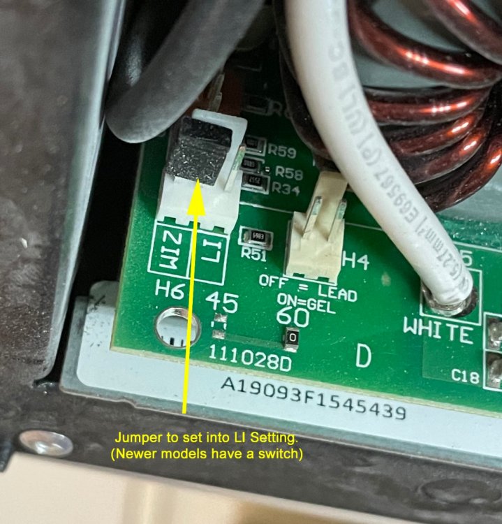

PD4045 while installing Lithium charging section yesterday:
Replaced two 12V AGM group 27 batteries with one BattleBorn 100AH LifePO4 lithium battery yesterday. Mounted the Renogy Voyager 20A solar charger with LifePO4 charge profile setting in the battery compartment with one BattelBorn battery. Seen up to 6 amps of charging current with 35' of 10/2 cable between the 100W Renogy suitcase solar panel and charge controller using a 10A Furrion solar port on Ollie.

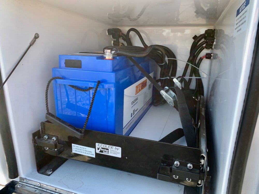

Update to the original post, I've installed the single LifeBlue 200ah battery.
The battery is only 58lbs - less than a single 65lb AGM.
I used 3/4" pvc trim boards to make spacers in the tray.
The only issue I had was the supplied post bolt was not quite long enough to accommodate all the connections (about 3 threads short).
The converter/charger was able to bring the battery up from 73% to 100% in about 4 hours (the fan is on all the time for the higher lithium setting).
EDIT: The charger fan runs continuously WHILE charging, but shuts off once charging is complete.
Battery and inverter are performing as expected. No trouble running the teapot or microwave.

I installed the new Lithium power section (45 amp) and the fan does not run continuously, it has a temp sensor on the heat sink to control it, just like the older LA board. I normally leave its breaker open (off) unless I specifically need to charge from it.
It would be very nice if the charger could act as a 12 v power supply for the cabin equipment with the batteries completely disconnected, but it won’t work that way. For example, if you have to send off all your lithium batteries for repair, you can’t use any 12 volt stuff unless you install a temporary loaner battery in their place.

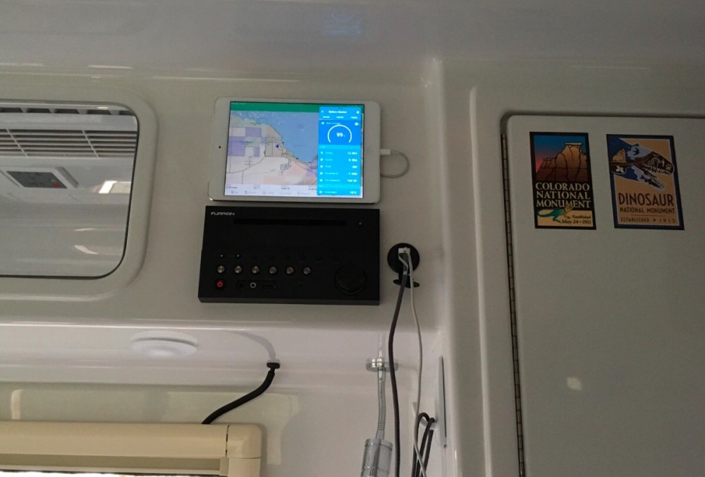

UPDATE: Lithium battery has been flawless and significantly lowered our old AGM power anxieties.
Between the Zamp solar display and the battery's app, we now have a clear picture of our power use and solar recharging.
