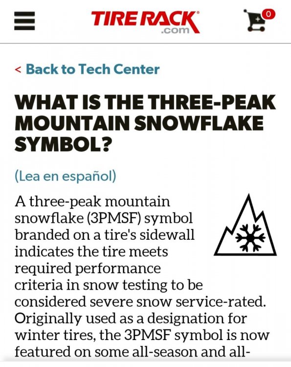

tripmushrv Posted June 26, 2021 Author Posted June 26, 2021 Thanks guys! I did a little more research...looks like should be going with E rated tires...does that sound right? Seadawg...I don't have Costco membership, but do have a Sam's Club one which should be comparable. You mentioned 'little snowpeak'. Is that on the tire tread?
Moderators Mike and Carol Posted June 26, 2021 Moderators Posted June 26, 2021 Yes, go with E rated tires. 1 Texas Hill Country | 2016 Elite II #135 | 2020 Ram 2500 6.7L
Moderators SeaDawg Posted June 26, 2021 Moderators Posted June 26, 2021 2 hours ago, tripmushrv said: Seadawg...I don't have Costco membership, but do have a Sam's Club one which should be comparable. You mentioned 'little snowpeak'. Is that on the tire tread? Yes. When we had Sam's club membership, prices and services were comparable. The snowpeak and flake are on the sidewall. 2008 Ram 1500 4 × 4 2008 Oliver Elite, Hull #12 Florida and Western North Carolina, or wherever the truck goes.... 400 watts solar. DC compressor fridge. No inverter. 2 x 105 ah agm batteries . Life is good.

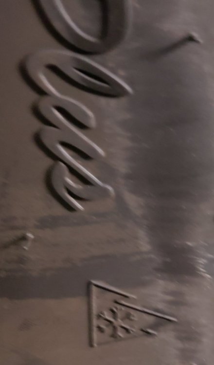

LongStride Posted July 8, 2021 Posted July 8, 2021 SeaDawg, I have the Pirelli Scorpion AT's on my Xterra. When I had my Jeep (predecessor to the Xterra) I kept it in Bridgstone Duelers. Both are great tires. The little snow peaks? They are for real. I often have the Xterra off pavement on two tracks in the woods in wintertime. 1 Mike and Yasuko 2021 Legacy Elite Hull #820
