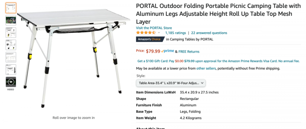

I have been looking for a good collapsible table, do you happen to know the manufacture of the table.
Pretty sturdy for what it is.  Holds my grill just fine, but I don't think I would want to put too much more weight on it.  Like so many things these days, if you are gentle with it you can make it last.
Looks good! We have the REI roll up table -  I wish it had that extra mesh netting.
