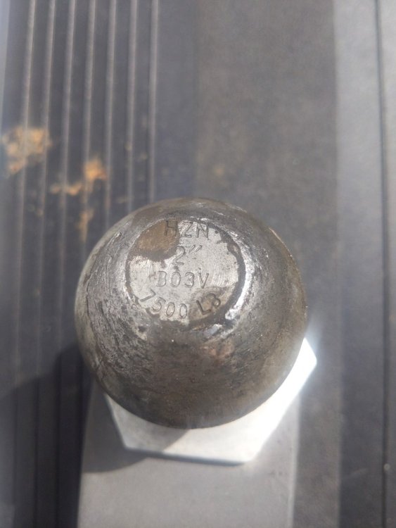

Not knowing the height of your receiver the only recommendation I’ll give is to be careful of the gtw of the hitch ball and draw bar. One of the reasons I don’t really like a 2 inch ball for a 7k trailer is there are a bunch of 3.5k and 6k rated units out there. Personally id make sure the connection equipment is rated at or above the gross rating of the trailer.

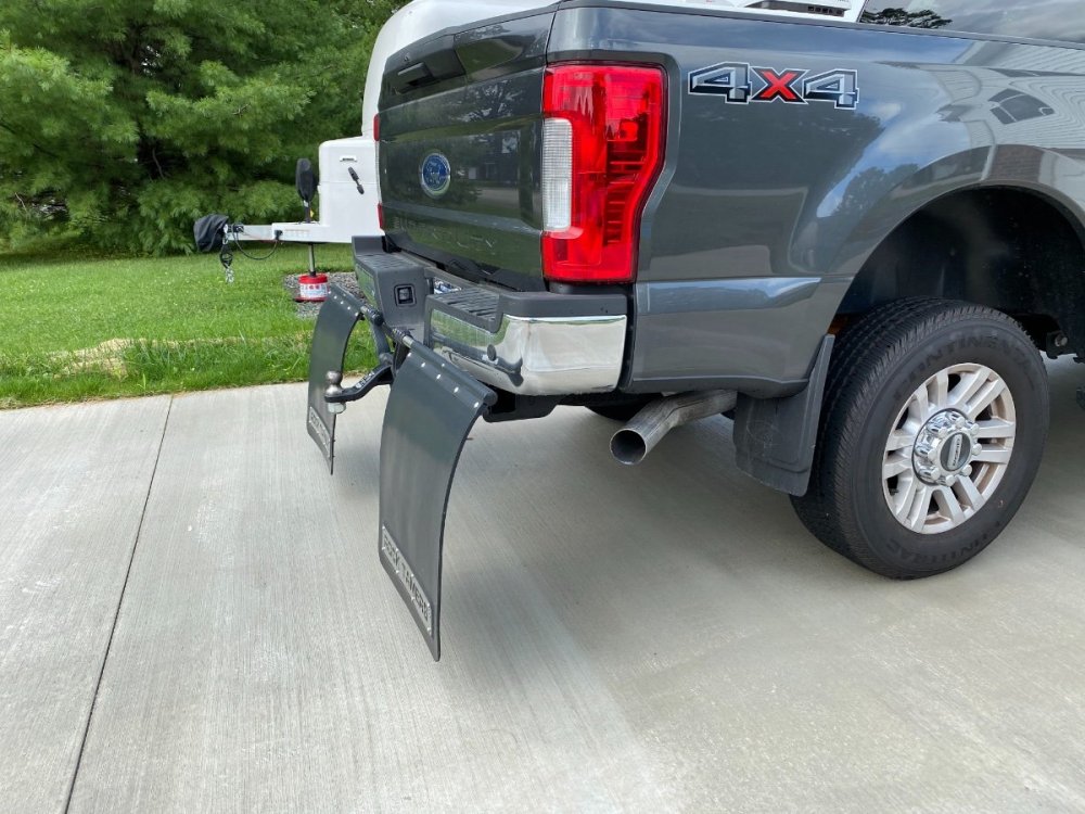

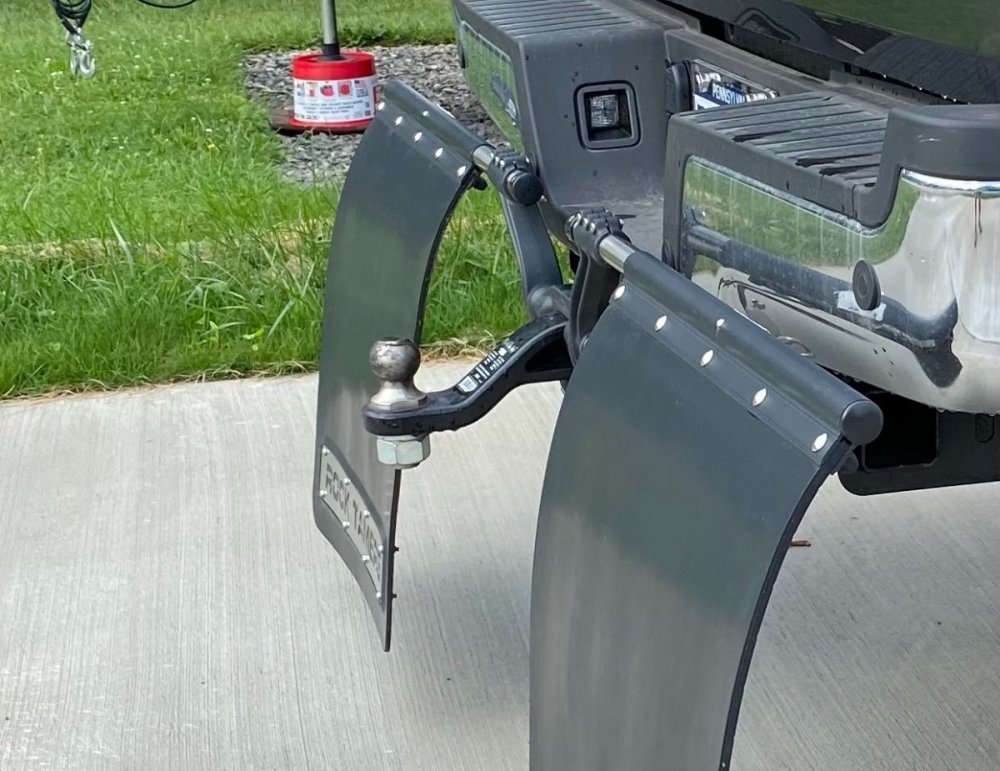

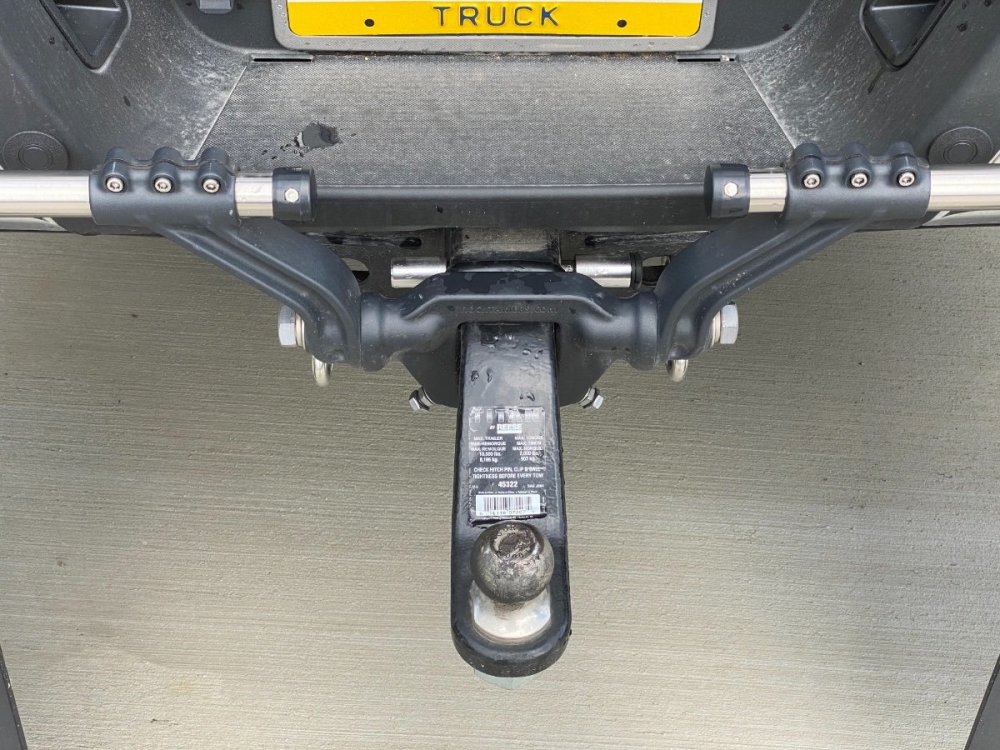

Here’s the ball mount hitch and ball I’m using on my F-250.  My F-250 has a 2-1/2” receiver.  Truck, receiver, ball mount and ball all rated well in excess of the Ollie weight for a big safety margin.    The ball mount is a 3” drop and that put the ball at the proper height for my truck.
Reese Towpower 45322 2 1/2" Titan... https://www.amazon.com/dp/B003JID6U6?ref=ppx_pop_mob_ap_share
CURT 40056 Stainless Steel... https://www.amazon.com/dp/B08557RHP1?ref=ppx_pop_mob_ap_share
This is the hitch I got when I went to the 2500.  Top of the ball is just under 24” and I get about an inch of drop when the trailer is connected.

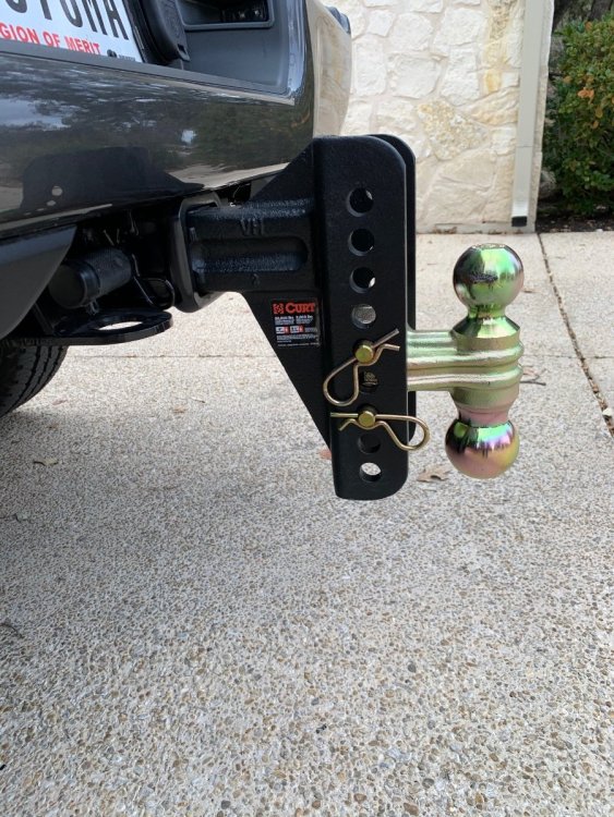

I used this hitch and towed about 3500 miles this summer with no issues. Hope this helps!

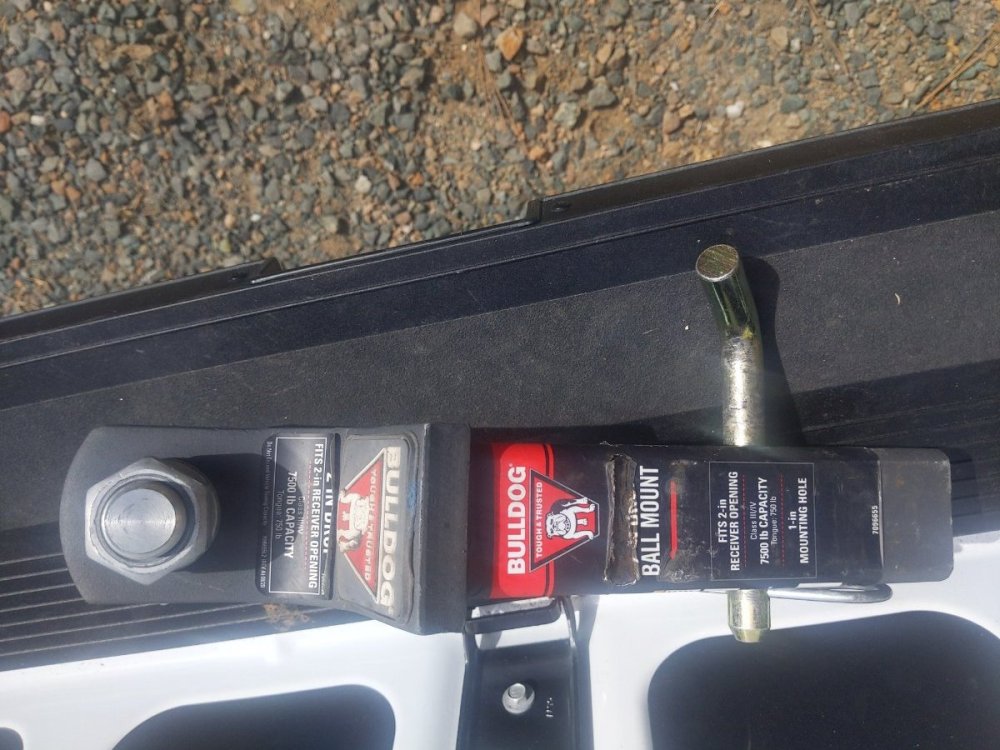

I thought I had researched everything correctly and came with a receiver and ball that I thought were perfect. Of course I was wrong. Fortunately there's a Tractor Supply Co. about a quarter mile from OTT. I actually had to go back twice (!!) to get the correct set up. The folks at OTT were so patient with me and I don't blame them if they were amused by me. Anyway, that's a backup option to make sure you get on the road with the right setup.
Chris, did you go with the 2 5/8 inch ball?   I am leaning towards that for our November delivery.  You also get a beefier Bulldog coupler.
