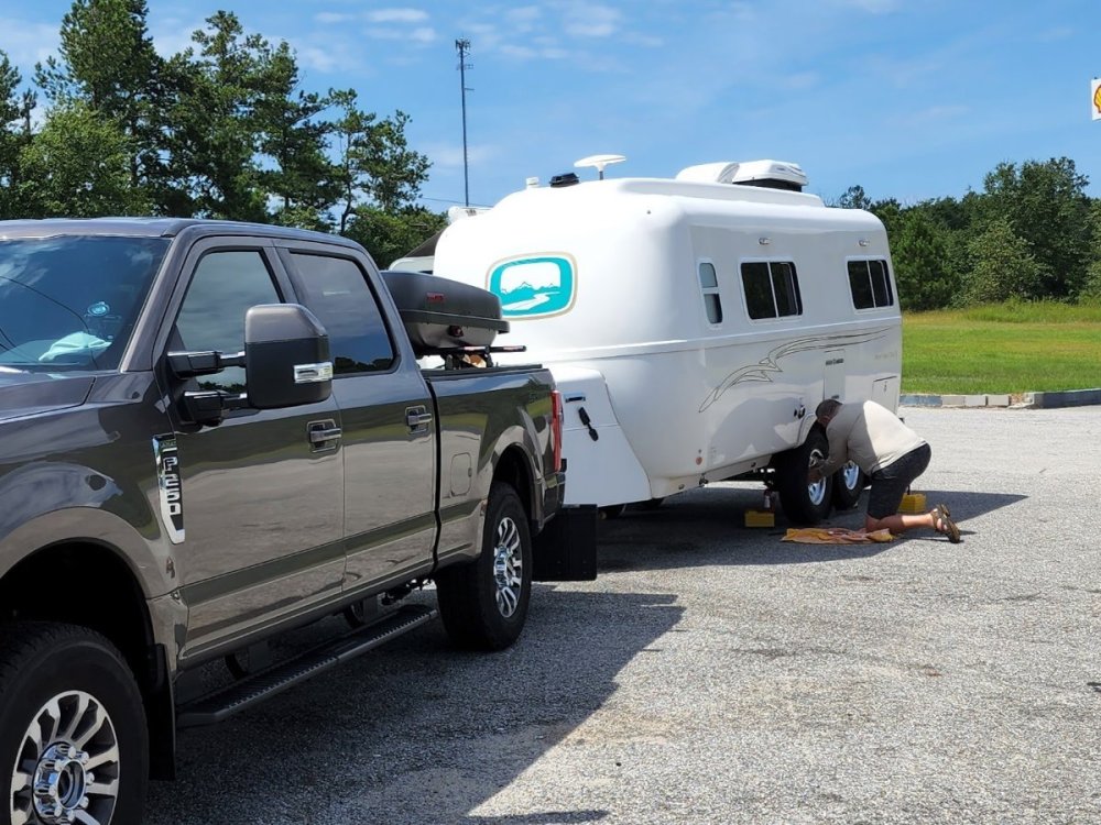

Second time TPMS warned us of an impending flat.
Glad we had two axles allowing us to limp off interstate.
It was 100° in the shade.
          Good reason right there to get port side awning.
Used stablizer to lift Ollie then added scissor jack.
Good Samaritan taught us trick to get [dang heavy] tire back on. (Sit on ground, cradle tire between thighs & lift. Hahaha- I'm envisioning myself splayed out on egg frying hot asphalt, trapped underneath tire.)

  "Good reason right there to get port side awning."
We did order the street side awning for a variety of reasons.  Picking up in three weeks.  Hull number 1290 we're told.
John
Nice looking truck too!
Sorry you had the tire trouble.  Did you pick up a nail in it?
Bad valve stem. We had all valve stems replaced soon after, to be safe. (40k miles on tires. Not complaining one bit.)

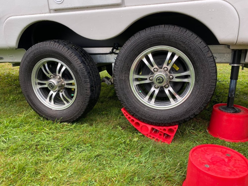

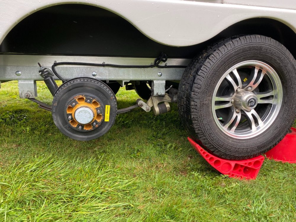

We just came home from a trip.   And we had a flat tire.   It was in one of those remote places where you really don't want to have problems.    I had just stopped at a service station and adjusted the PSI in the tires the day before and had a scare when one of the tires wouldn't stop letting air escape.  Ultimately I was able to get all four tires properly inflated and we went on our way... thinking all was well.  One of the four then went flat over night.   I believe the cause was the "balance beads" used by Lionshead (a supplier to Oliver).
    I had the Andersen "rapid jack" which is just an oversized version of the camper leveler ramps...and with just a little assist from the Ollie's stabilizers, I was easily able to jack it up high enough to put on the spare and get into a town where the original tire was repaired... with a new valve stem.
    Since that time, I came home to discover that we (those effected by the balance beads) had received replacement valve stems that are resistant to interference from the balance  beads... from Oliver.  (Thank you Oliver!)
   I was on some very soft ground and with the Andersen rapid jack... I wasn't able to get the tire quite high enough for it to turn freely... but just a little assist from the Ollies stabilizer and she was clear.  This also made it very convenient to tighten and torque the lug nuts... before putting it all down on the ground again.

image.png.cb9a8098514ec803c03d554e444c2fae.pngAre you hubs ventilated?  I've not seen this type before.  Thanks, GJ
I don't believe that those hubs are actually "ventilated".  Its just the normal ridges around the outside that make it appear so in this picture.
That's my guess too.
I thought GJ was referring to those pockets between the studs. Those look to provide some release or isolation for the nevrlube hub.
You are correct.  That was what I was trying to ask.

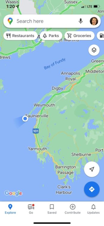

Actually I have no idea.   I didn’t notice those either until I posted the pictures.   At the time… I was just thrilled to get my old tire off and the spare on… because this is where we were in Nova Scotia  when it went flat.  And it was cold and raining!

8 hours ago, Dave and Kimberly said:
…because this is where we were in Nova Scotia  when it went flat.  And it was cold and raining!
Well, any other place and conditions would not have made for as interesting a story and memory for you guys.
