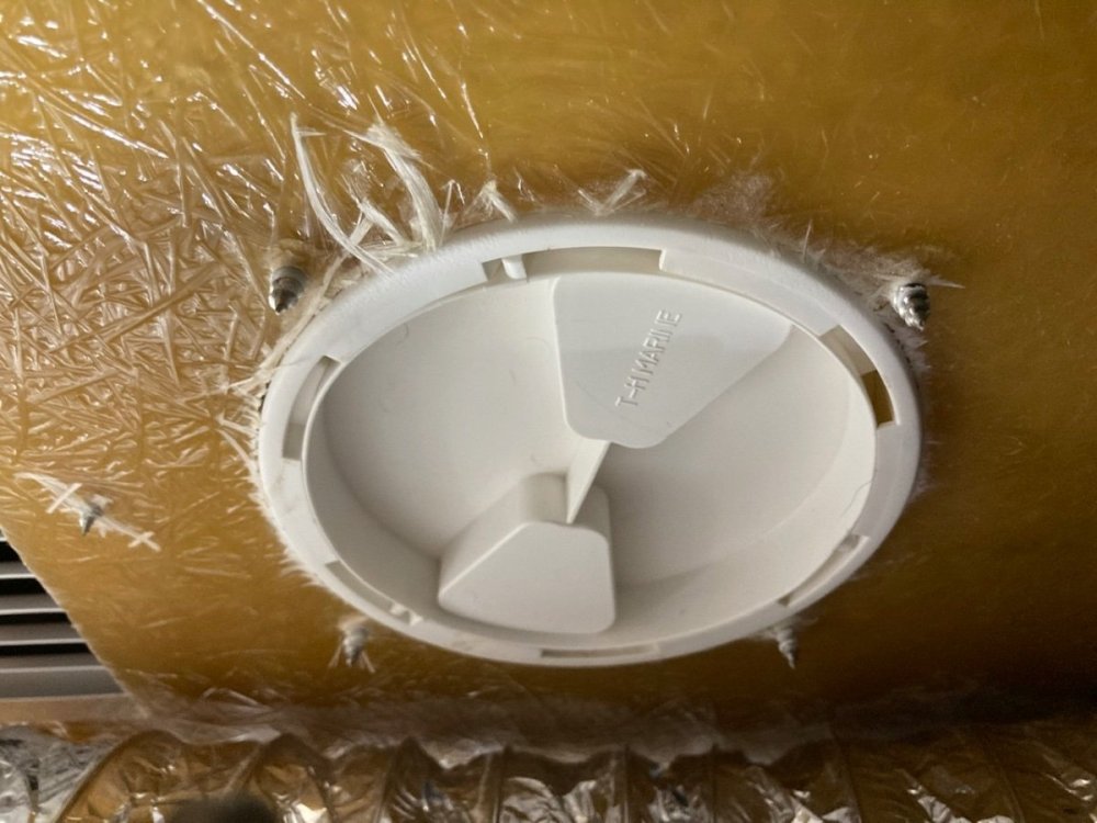

Hokieman Posted October 20, 2022 Posted October 20, 2022 Pardon the minor thread drift, but if you go poking around in the bowels of your trailer, you’ll find lots of sharp things that can get you. For example, I discovered a large tear in my furnace heat supply hose, when I was reaching in to open the the water tank drain valve. I noticed sharp screw heads on the backside of the furnace intake vent and access port, which caused the tears in the hose. I used my Dremel to grind off the sharp screw points and applied RTV sealant. Small tasks that don’t take long to complete, normal trailer fixit stuff. 2 “Ramble” - 2021 Legacy Elite II #797; 2020 Ford F-250. Former owner of 2019 Oliver Legacy Elite #431. Blairsville, GA
