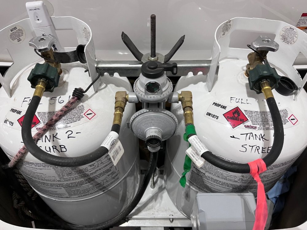

It's time to replace my original propane regulator-to-tank hoses.  They are leaking at the metal seams.
Since my rig is a 2016 (#110) would you recommend also replacing the regulator too?  I see no problem with it, yet, but, you know how that goes.
Also, what type of hose upgrades might you recommend, if any?  Are braided more flexible, safer, better?  A little longer than original or not.  I used a string to measure mine, I'm not sure how they measure them, but it looks like they may be nearly 15 inches (or 1 1/4') on E-Trailer.com.  Also looks like they have the inverted flare male connector (the smaller diameter one).
Any part(s) suggestions are welcome.  I'm okay with making it better than factory-provided.
Is there anything that will allow for less movement of the hoses when taking the tanks in and out?
Here's what I see so far: https://www.etrailer.com/Propane-Fittings/JR-Products/37207-30725.html
When it's warming, I intend on checking all the lines under the hull too for potential leaks.

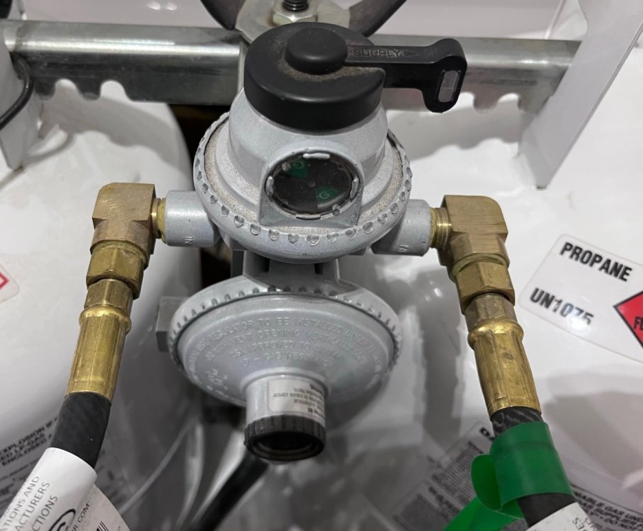

For what its worth - last Spring I replaced my hoses with two of THESE in the 12 inch length combined with two of THESE emergency gas cut off devices.  All was purchased from TechnoRV.com.
A couple of notes -
1 - make sure that you check the size of the connections on the hoses.  Given your hull # I'd bet that you will need adaptors for these hoses to connect to the regulator.
2 - Given that the fittings on any of these hoses are made of brass, be careful that you do not over-tighten the fittings in that you stand a good chance of stripping the threads on that relatively soft brass.  I believe that the torque setting is 25 foot pounds (but please reconfirm this).
3 - Make certain that you use "gas" tape or pipe dope.  The tape is a bright yellow color and the pipe dope will be clearly marked as for use with gas.

It seems to me that the brass 90 built into the 12" replacement hoses you bought would reduce the stress on the hose connections, likely increasing the useful life of the assembly.  Does anyone know why Oliver doesn't install 12" hoses with the brass 90's, instead of the longer hoses that must be bent into a tight curve to make that 90-degree turn from the tank to the regulator connection?
I was thinking the same thing. The short hoses with the 90 deg fitting are obviously designed with this in mind.
Yes, I thought the same thing.  But, the original hoses did give me more "wiggle" room - particularly when taking the tanks in and out for refilling.  Having said this, I'd still do the same thing over again in that the new hoses really do reduce that big bend in the original and clean up the space a bit.

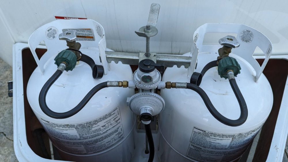

When I get the new lines installed, I'll upload a before/after pic.  I too am hoping the new shorter lines with 90 degree connectors will reduce movement when removing tanks.

Well, these new hoses went on in a snap.  No leaks now.  I did need to rotate the tanks 90 degrees so the lines fit best.  We'll see if they last another six years.
