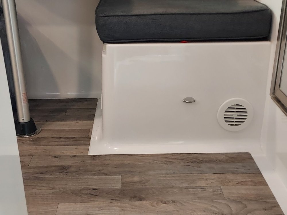

The return air vents is something that can be easily added on older models if you choose to.
Although we have a Truma Varioheat furnace with a return air vent in the bathroom, I chose to add a 4" round return air vent on the aisle side of the front dinette seat.  See photo below.
1028521075_StreetSideFrontReturnAirVent.thumb.jpg.8438da19b5bfbe1156e8026cb1ddcc25.jpg
I did this in the hope it will further improve circulation of warm air through the areas under the floor, to help keep water tanks and pipes from freezing when camping in really cold temps.  I chose this location because it is about as far away from the two main cabin supply vents as possible, yet close to the floor where return heat vents should  be.  I am advised that maximum separation between supply vents and return air vents provides the most balanced air circulation.
These Valterra A10-3345VP 4" vents are available here:
https://smile.amazon.com/dp/B07D2Z8HBV?ref=ppx_yo2ov_dt_b_product_details&th=1
They are installed using a 4" hole saw.  The vents have large bumps on each side which should be filed down to fit through the 4" round hole.  They come with two attachment screws that fit in recessed holes on the side flanges, for which you should pre-drill with a 7/64"  bit.  The drilling makes quite a mess, so you will need  a good vacuum.

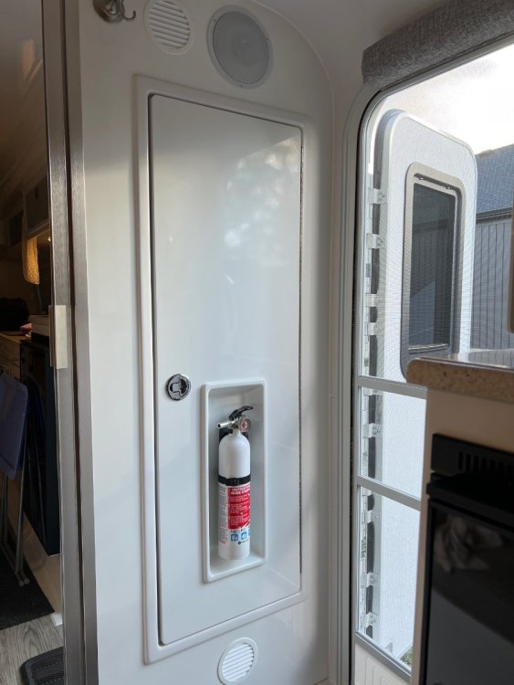

On 1/23/2023 at 4:07 PM, JEssary said:
They are still working on getting [vents] placed in the closet which should be one on the top & one on the bottom for better air circulation through that area.
While I had my 4" hole saw chucked into a cordless drill, I opted to add two 4" vents to the closet, one high and one low, as Jason recommended. See photo below.
I also plan to monitor the impact of these return air vents on closet temps.  When camping on our way back to Idaho from Hohenwald in some very cold ambient conditions in November, the closet remained quite cold, even when the main cabin was heated up to around 70 F.  I expect the effect of these new return air vents will be temps much closer to those in the main cabin.
 I will report the results of my temperature monitoring next week.

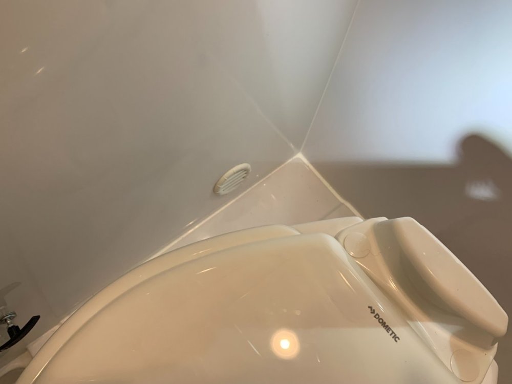

Out of curiosity, where is the return air vent in the bathroom located on the new 2023 Elite II?

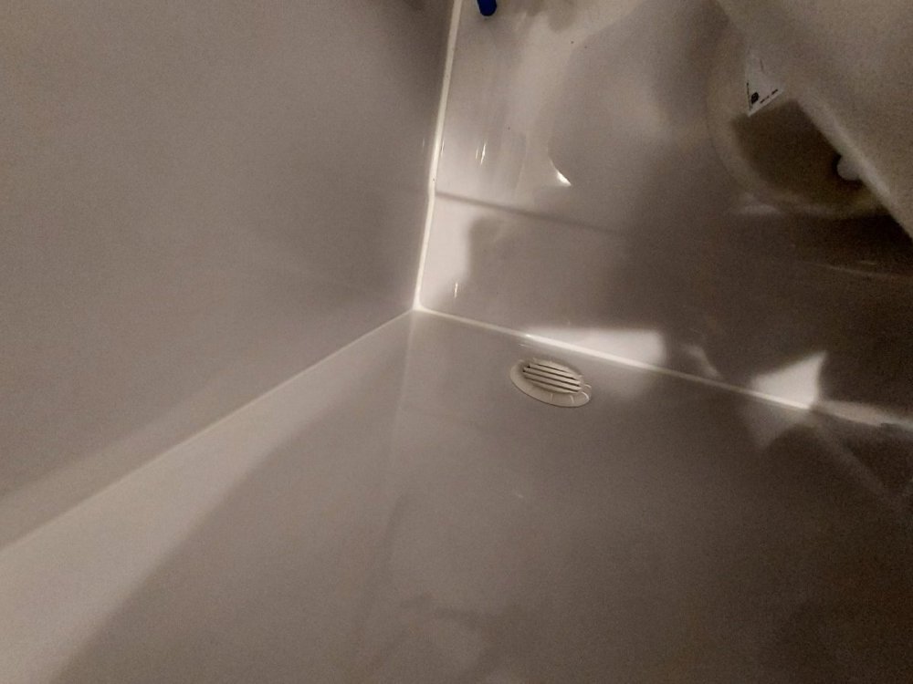

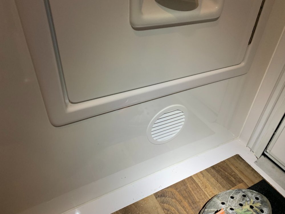

Low on the wall between the toilet and the dinette.  The photo below was shot looking down.  The toilet is visible on the right side of the frame.
That return air vent allows airflow into the area under the forward dinette seat, which connects to the under-floor area..
991039758_BathroomReturnAirVentFromUnderneathFrontDinetteSeat.thumb.jpg.8ad4efe6e388eb1ddd3fb27750e7d6ad.jpg
Data gathered during our return trip from Hohenwald to Idaho last November indicated that this 2" vent made a notable difference in below-floor temps on cold nights in the single digits and teens, F.  Based on those observations, if one had not been installed in our Hull #1291, I would install one.

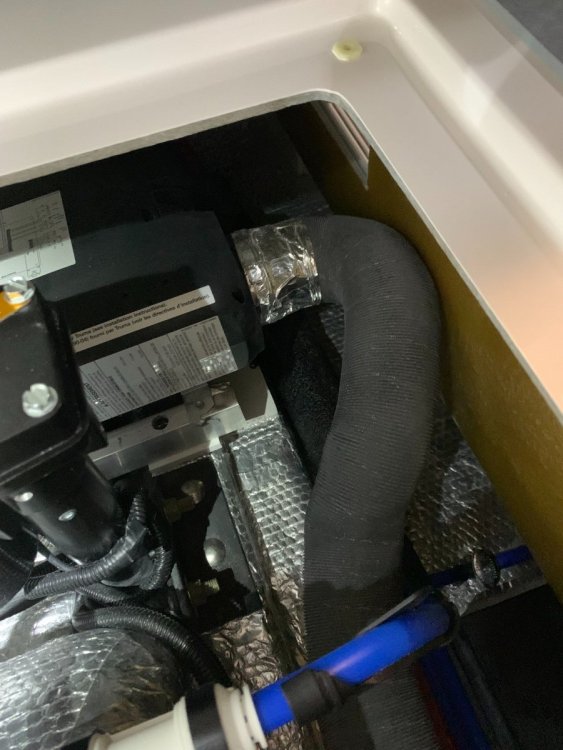

Rivernerd,
From my mad scientist experimentation, there are four things you can do to improve this situation.
1). The column of the leveling jack and, most especially, the metal flange the column is attached to, makes for a great cold radiator.  some creative work with reflectix and silver tape would go a long way
2). unscrew the ext shower head, bring that line into the compartment and reattach the head.  Pull the hot and cold knobs.  Now there is enough room to add a block of closed cell foam under the little door to the ext shower compartment
3). cut two layers of reflectix material to cover the entire exterior access door.  Cut to fit around the latch but wide enough so it gets pinched by the rubber door gasket to make a seal.  Adjust the latch enough so it squeezes the reflectix to close gaps but not so much that the hinges to the door are straining when door is closed.
4). add a small return vent under that bed.  Mabey do this last to see if required as it's the most invasive.
I went entirely overboard there and replaced the most rearward heat vent on the curbside, snaked under the floor, pst the inverter and fed out to the isle across from the existing galley heat vent.  Had to insulate the hose from existing electronics.  It works great and certainly heats the battery compartment but bet if I had started with the points above, would not have been necessary.
Hope this helps.

On 1/30/2023 at 7:15 PM, Rivernerd said:
Now the bad news:  My hopes that the increased airflow overall would also result in significantly warmer temps in the vulnerable area on the street side by the external shower controls, were not realized.  The temps in that rear area of the trailer stayed above freezing once cabin temps got above 60 F, but only 2 degrees higher than before adding the new return air vents (40 F now vs. 38 before).  Thus, there was some measurable improvement, and maybe enough to keep tanks and pipes from freezing when ambient temps are in the single digits, but not as much as I was hoping for.
Since you added a 4" round return air vent on the aisle side of the front dinette seat, did you also leave the existing stock return vent open?
Yes.

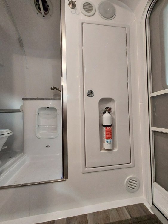

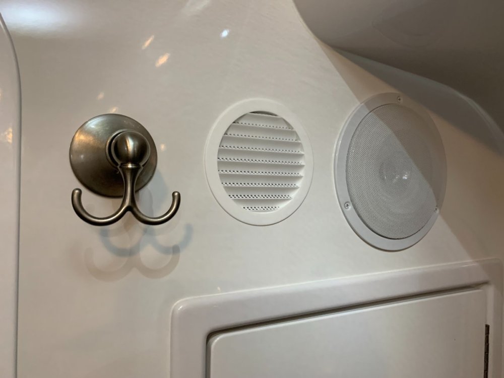

I can confirm that in my 24, however, looking at the Truma makes me wonder why it wasn't mounted 90 degrees since the current orientation causes a substantial kink in the air ducts.  However, that would compromise the mounting on top the wheel well.  Although I don't really see a problem with that.
Return vents:
Bathroom
Closet upper and lower venting
On 1/23/2023 at 7:51 PM, Mainiac said:
The vents in the closet, will it be vented to the bath or the main cabin? The main purpose of venting the closet? Is it to warm it up in there? To change the air is a commendable goal, just have never heard any one say that to vent that space would be nice. Is it thought to accomplish this, with one high and one low, by using the thermo siphon principle? Or to take advantage of the forced air from the bathroom heat duct?
I would love to see a small waste basket installed half in/half out of the closet door. That would make it accessible from both inside and outside. Maybe the vent could be combined with this goal?
As seen in the pictures, they installed one above and below.  However, it stays cold in there so without possative airflow using a fan, it is just dead space.  I think a small DC power fan mounted on one of these vents would make a big difference, though I'm not sure if it is needed since there are no water lines in there.
Bottomvent.thumb.jpg.33b9d54877461af223777391823e4f90.jpgUppervent.thumb.jpg.5f41d7ceec75246f3becfec8e4077fde.jpg

Bathroom
Jason:
It look like the Oliver installed vent in the bathroom is smaller than the ones in the closet wall. What size is the bathroom vent?
Maine
2".  I expect that is what Oliver had in stock, as it is the same size as the supply air vents.  One could easily substitute a 4" Valterra vent for even better air flow.
EDIT 3/9/254:  2" is incorrect.  The Oliver installed vents are 3".  My bad!

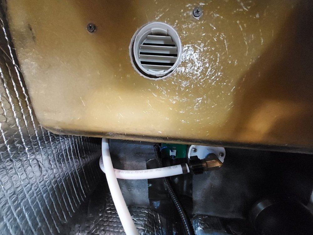

I cut a 4" vent from the back of the closet into the vanity in the bathroom.  In my case, also added a 4" adjustsble vent in the door which is pretty much the equivalent as the vents now added standard by Oliver.  After this mod, when the heater kicked on, I noticed that warm air from the cabin would get drawn through the closet.  No more frost and condensation on the rear wall and clothes dried much better.  Still would prop the door open if I had to dry things quickly.
