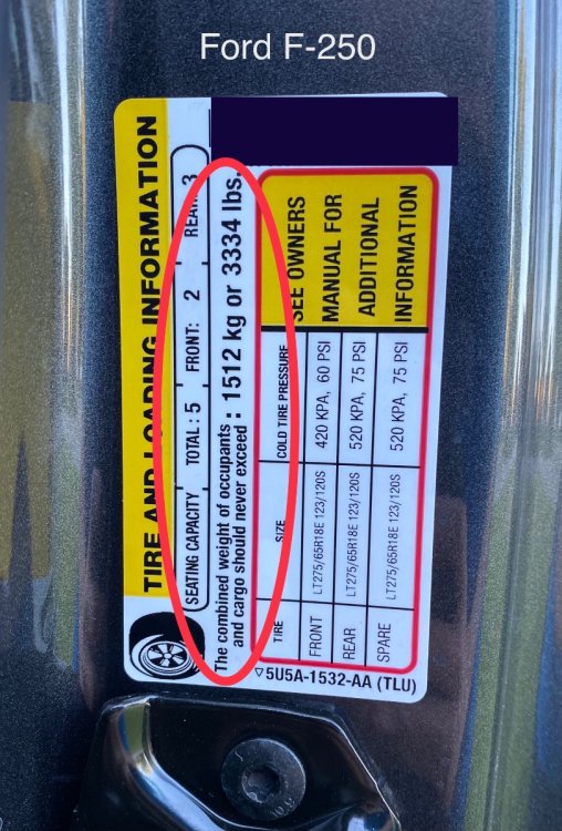

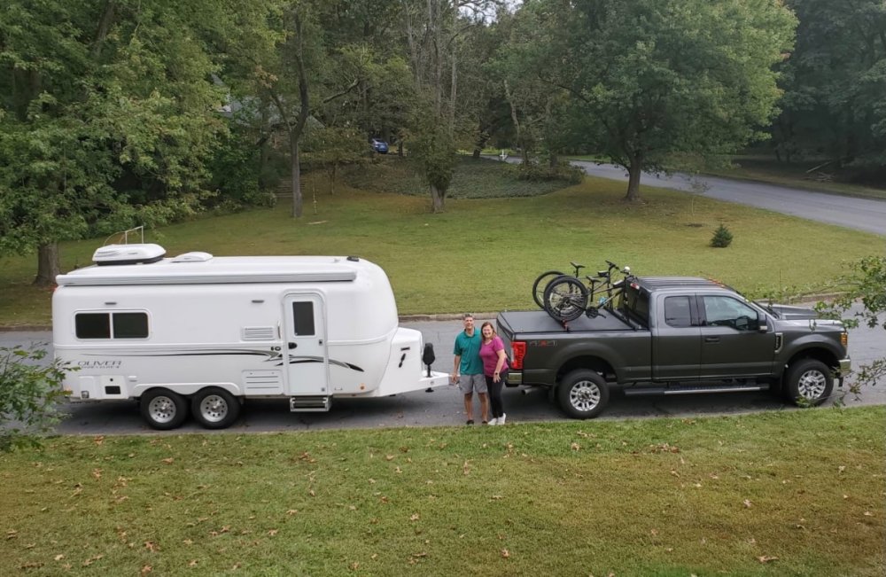

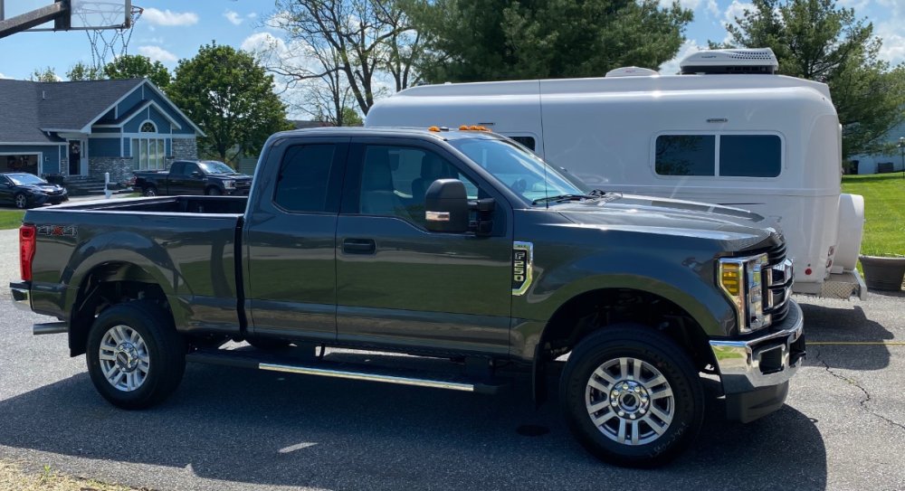

Frank C Posted February 27, 2023 Posted February 27, 2023 I wanted a very capable but still somewhat compact truck as a tow vehicle so I went in the opposite direction of your thinking. I found an F-250 SuperCab (rear suicide doors) with short (6’-9”) bed. It’s only my wife and me when we travel, and this truck keeps the overall length a bit more reasonable for maneuvering around with the truck, but still has a lot of room in the cab and the bed, and huge towing and payload capacity. The SuperCab has no door pillar between the front and rear doors when the doors are open, so it’s very easy access to the rear seats. We do a lot of day trips with the truck after setting up the camper at the campground, so I wanted something at least a little more “compact” (a relative term when we are talking about a 3/4 ton truck 🙂) to make it easier to get around in downtown areas, parking lots, narrow roads, etc as we do our exploring during the day. 4 1

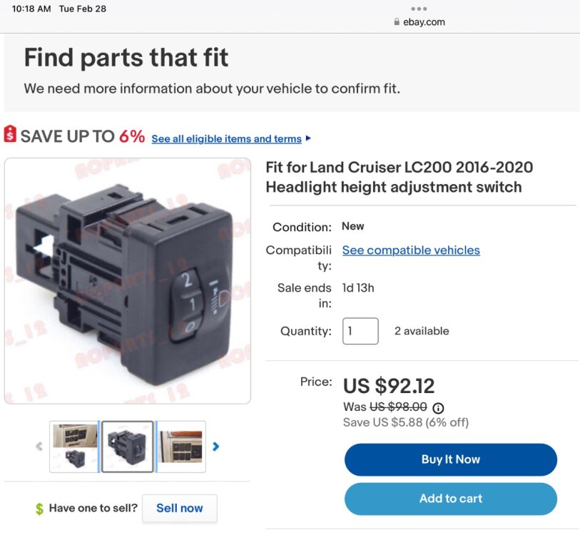

John E Davies Posted February 28, 2023 Posted February 28, 2023 27 minutes ago, snakeriveridaho said: Our headlights were tilted up enough to cause problems for us and oncoming traffic. We added Firestone airbags with an air compressor and Bluetooth control via the Firestone app. It has been convenient and effective. Highly recommended so far. Kirk LOL, this is the first time I have read here about anyone blinding oncoming traffic. I have airbags but they are not needed for the lights. I have a Land Cruiser Magic Switch. John Davies Spokane WA SOLD 07/23 "Mouse": 2017 Legacy Elite II Two Beds, Hull Number 218, See my HOW TO threads: Tow Vehicle: 2013 Land Cruiser 200, 32” LT tires, airbags, Safari snorkel, Maggiolina Grand Tour 360 Carbon RTT.
Rivernerd Posted February 28, 2023 Posted February 28, 2023 1 hour ago, John E Davies said: I have a Land Cruiser Magic Switch. We have a similar headlight height adjustment wheel on our 2019 Tundra SR5. Until I remembered it came on the truck, I wondered why the headlights were set so low! Duhhh! Hull #1291 Central Idaho 2022 Elite II Tow Vehicle: 2019 Tundra Double Cab 4x4, 5.7L with tow package
