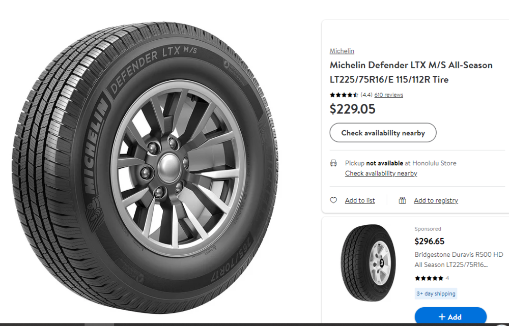

Here are the pictures of the tires mentioned so far:
1382092272_MichelinDefenderLTXMudandSnow.thumb.png.d99daa79d6492664cb9da9e18b978aa3.png
The Cooper AT3's have a great following and reviews.  I will be considering them for replacement on my F-150 FX4.
But for Ollie, I have concern that the tread pattern will be more susceptible to tossing rocks than the Michelin Agilis CrossClimate.
I also like that the Agilis being a commercial vehicle tire.  On Michelin's site they state it is "their most durable tire".
Looks like I need to do some more research.
Thank you for the suggestions!  At least now I know that I do not need to change rims too!
GJ

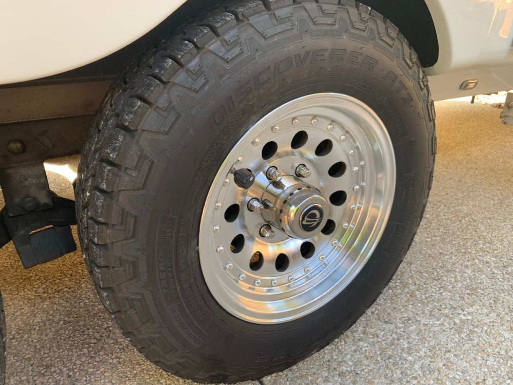

On 4/16/2023 at 2:01 PM, Mike and Carol said:
Cooper AT3’s on trailer and truck:
AA7848C5-DD2F-4109-B657-EA4A5F919EE7.thumb.jpeg.61ea8763366a873120bffc7701605e6f.jpegD55FB420-A36A-4EEF-97C9-DD62DF5A29CD.thumb.jpeg.cc2a8d1b85ca43cab65e40e0579c2e69.jpegAF122AA0-5B81-453E-814E-FECD9747CADD.thumb.jpeg.3232a5881f8c346de1b9cded2218f35c.jpegDD9760EA-539C-446D-8F2D-4DDEA8E0E3C8.thumb.jpeg.ec0dba156790ee830b280174176616e9.jpeg
I just don't know... there's something cool-looking about having matching OTT/TV tires!
  • (SOLD) 2022 TUNDRA
I totally understand your perspective.   IF I were to be a salesman, and I wanted to poise my rig at an event, I would wave my magic wand to presto have the most macho looking tires on the market under both.  But before I took The Beast and Ollie on a trip, I would wave my magic wand and go back to purpose designed tires for each of my rolling stock.  🙂
As an engineer I look at purpose and function.  Traction tires, especially those that work well on our 4X4 TV's off road, have different priorities of purpose than our trailer tires.  So, in my minds eye, they likely would not be identical twins.  But that's just my perspective.
100% concur, GJ!
